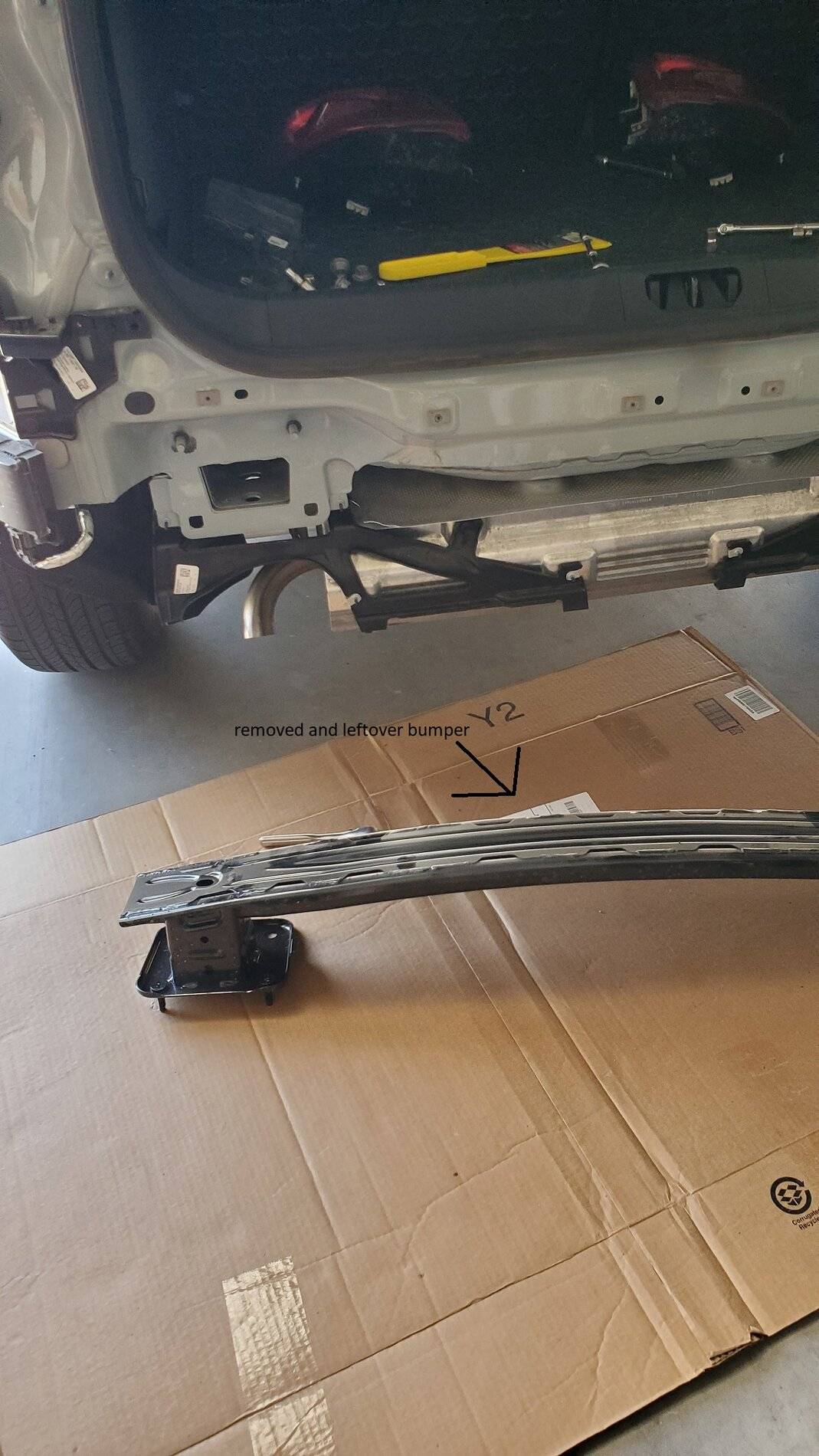

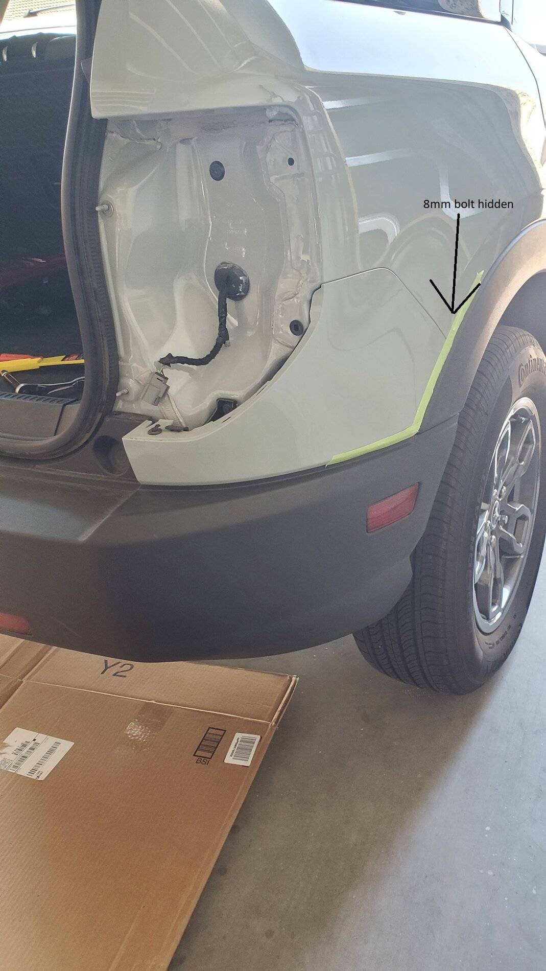

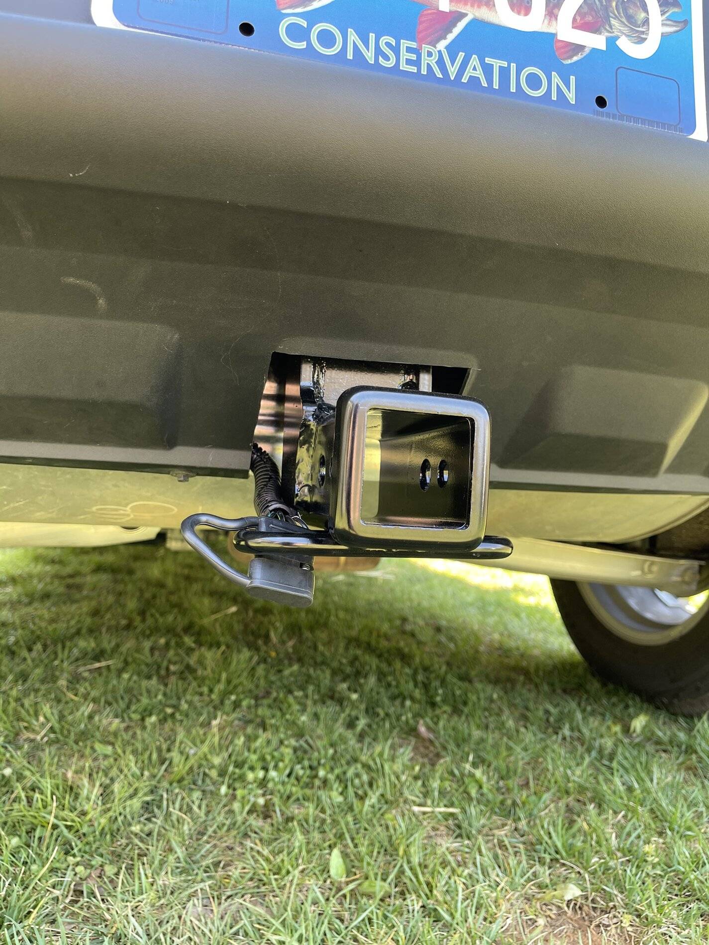

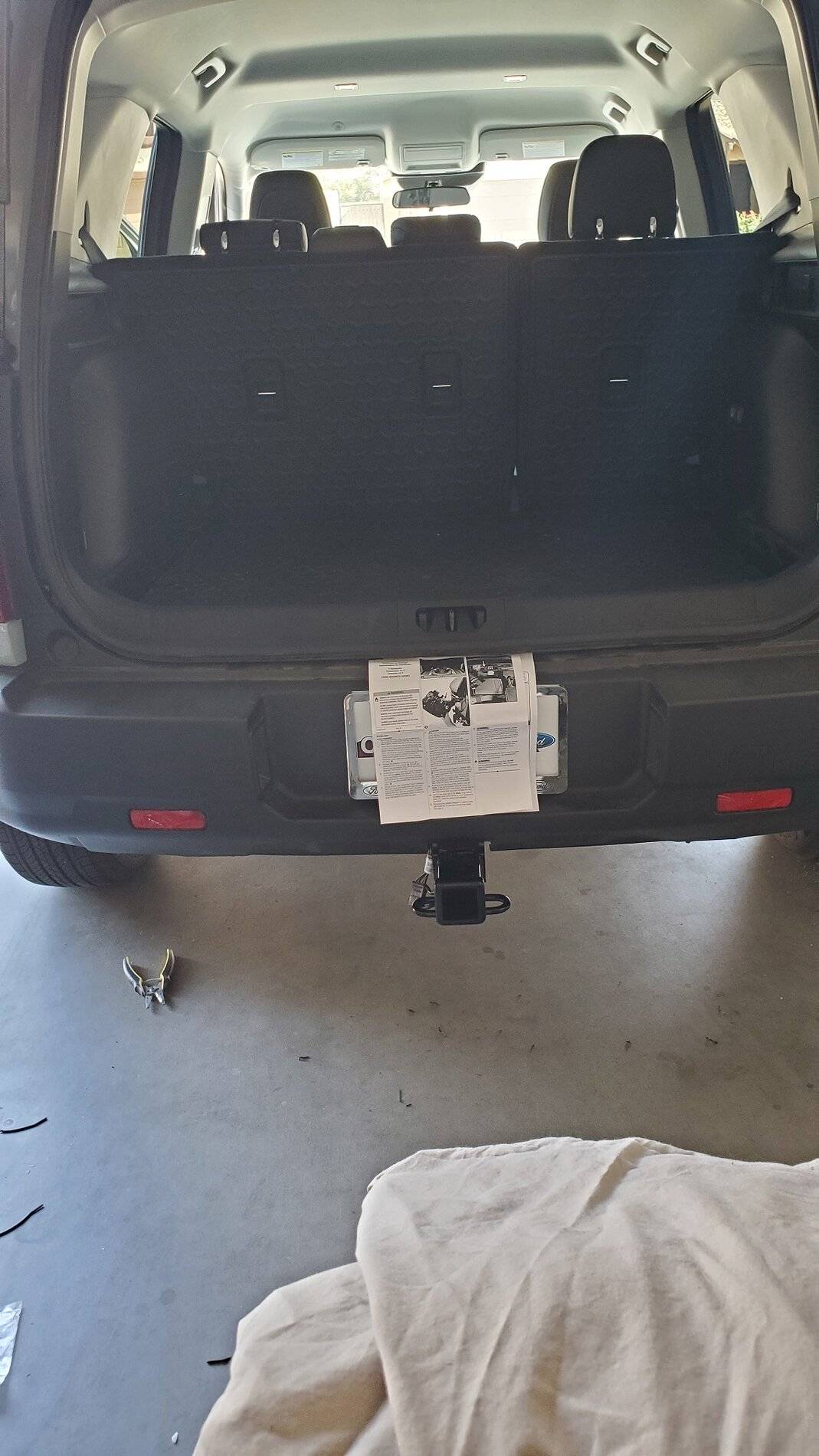

So it took me a few extra days to get around too, but I got the Drawtite hitch installed and here are a few photos and thoughts about the install
1. Instructions are good with one major exception, there is a hidden 8mm bolt under the rear wheel trim. The instructions call for removing it, but say to use a socket wrench. Good luck with that. I fortunately had a 8mm offset wrench that I was able to patiently use to remove it. The bolt is there, but you really gotta bend the rear wheel well trim to see/get at it.
2. The rear fascia cut out does not need to be as large as stated in the instructions, my cutout is 1/2 smaller all the way around.
I also installed the wiring harness. Only slight degree of suck is running the power wire to the battery. Pretty easy to keep it safely hidden on the underside.
Pics below.
