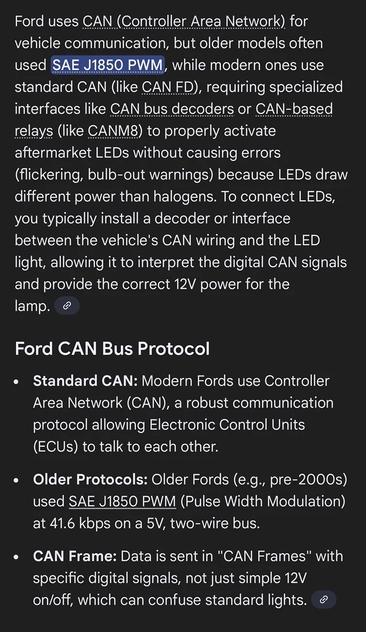

As far as the CANBUS system, it is essentially a more efficient way of communication amongst modules in an electrical circuit. Instead of each module/sensor having its own wiring which creates huge wiring harnesses and more points of failure, every module connects to the same two wires.
The issue is if you damage those 2 wires anywhere on the circuit you disrupt communication amongst all modules.

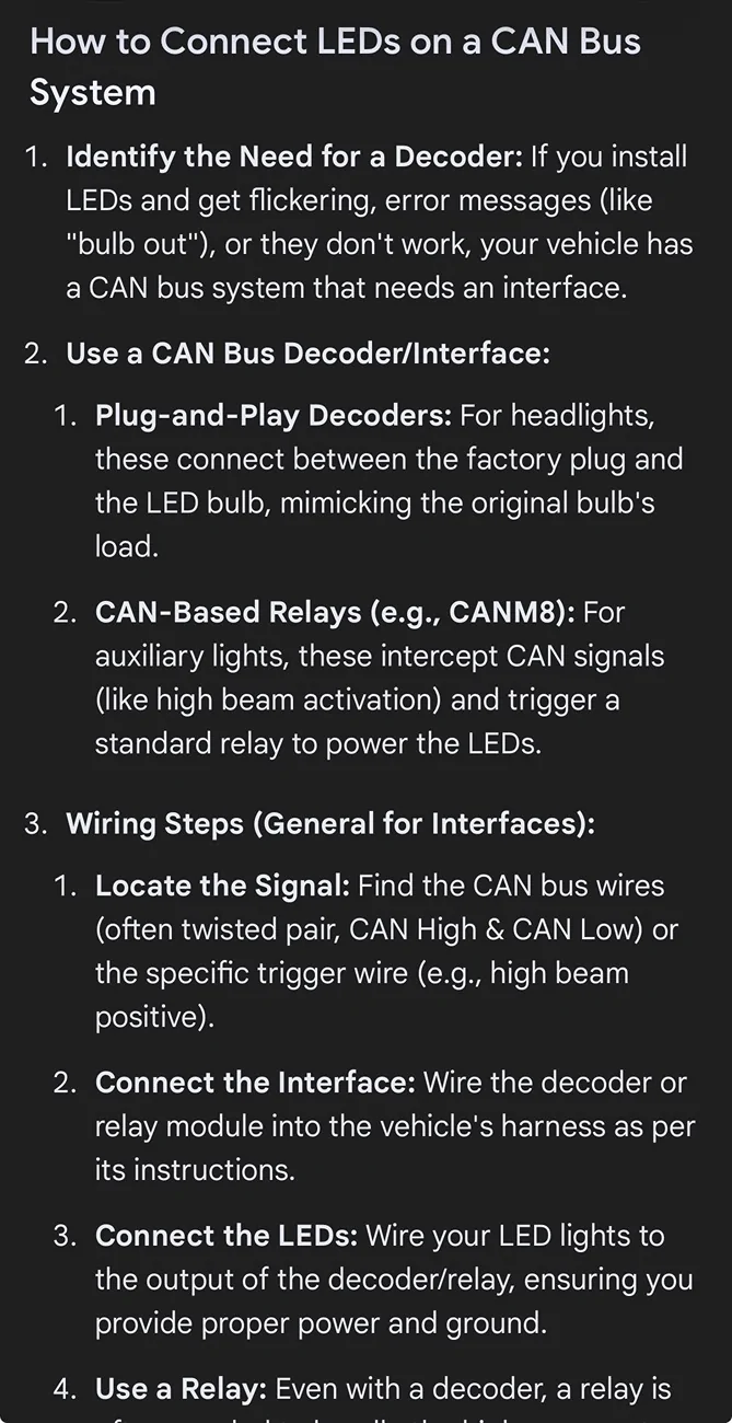

I understand “what” Canbus is. I’ve been dealing with it since I got my truck in 2006. One of the first few years it became more common. And what a nightmare coming from late 80s early 90s car electrical systems.
What I don’t get, is when people say “oh, it’s canbus you’ll screw up everything and void your warranty”. Which, I understand in theory, that’s possible… but then people say “adding this will void your warranty”.
How is it that places such as U Haul, your local mechanic, etc… can install these things on a daily basis, and have zero issues?
Because, simply tapping into a tail light to pull probably 2amps from turn signals, and maybe 5 from running lights, isn’t going to do anything to the system. Same concept as people who tap into the factory input wiring to add amplifiers, which draw SIGNIFICANTLY more amperage (which come from the battery directly)… but the input for the amplifier signal is ran off that same Canbus logic.
Now maybe if the circuit got overloaded, and someone had a grounding issue, and popped a fuse, then ya… it would probably mess up the sensitive canbus system then.
Easiest way, in my opinion, to bypass the canbus paranoia, would be to connect a relay to the battery for both the turn / running lights, so that additional amperage draw comes from the battery, rather than the cars dedicated electrical. Therefore, using the OEM turn / running light wires are solely used as a “signal” to turn the relay on, and draw its power directly.

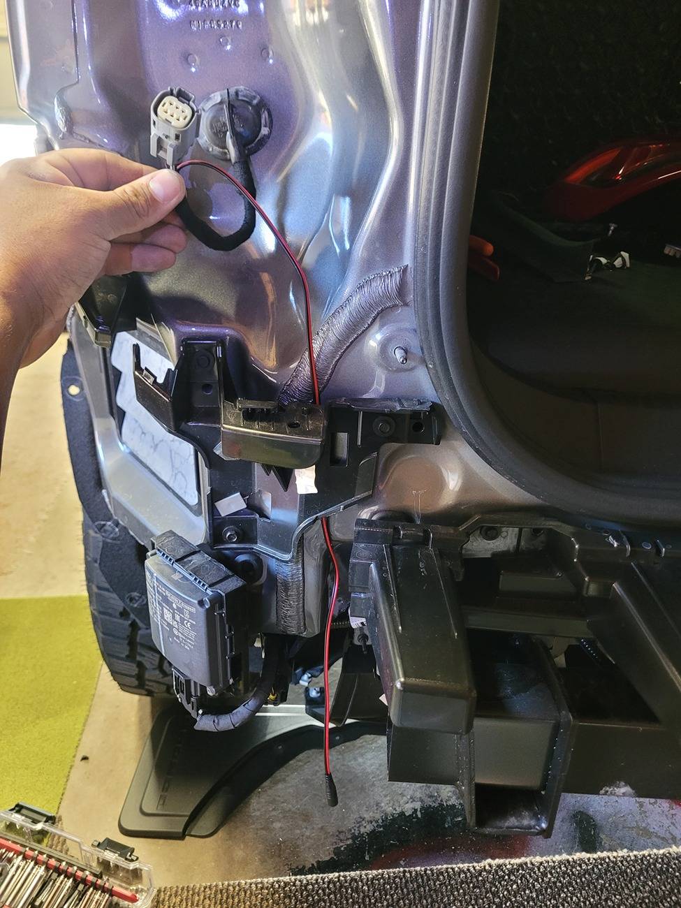

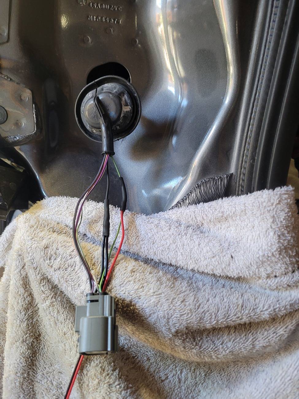

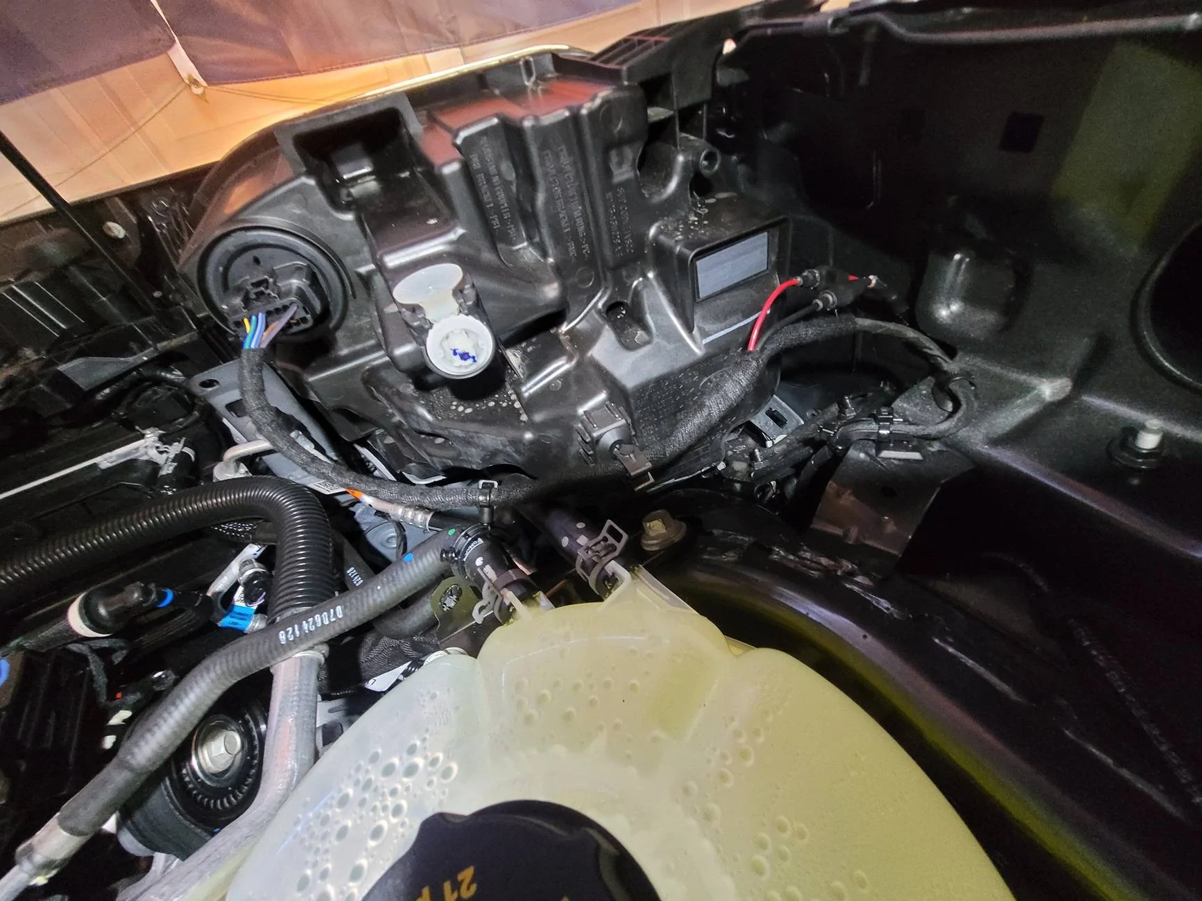

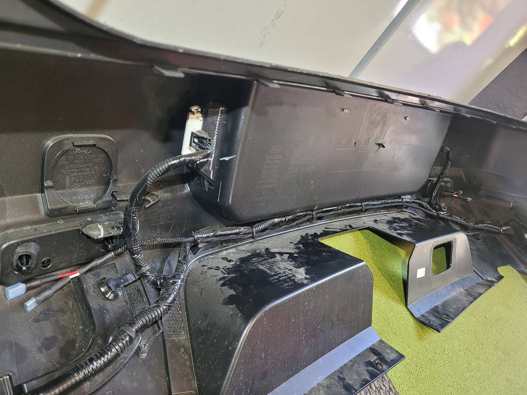

i haven't had any issues. i trust my soldered connections with glue lined heat shrink more than a crimp connector or bullet/spade connector. when i do use spades i still heat shrink the ends and also heat shrink again over the two connectors so no moisture gets in. i would rather my connections be secure and look as clean as possible, than it be "plug and play" or not. if i need it on the car it should probably be more of a permanent thing anyway.
from my ride thread
