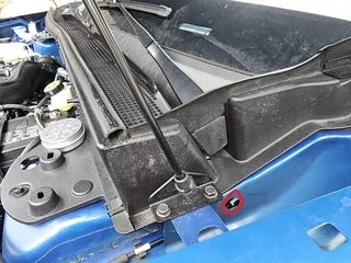

I did use the fiber optic camera to confirm a theory: the most likely source of ingress to the cabin air filter. These two holes go directly below the windshield cowling and are plenty big for mice to get into. If you park your BS BL outside, I would strongly consider covering these holes with metal mesh (which will still permit drainage, but the mice won't want to chew) so you might avoid the escapades I have experienced, at least to the extent of them nesting directly on the cabin air filter:

Thanks for the photos. Those could well be access points for mice. They aren’t drain holes so they could probably just be taped over.

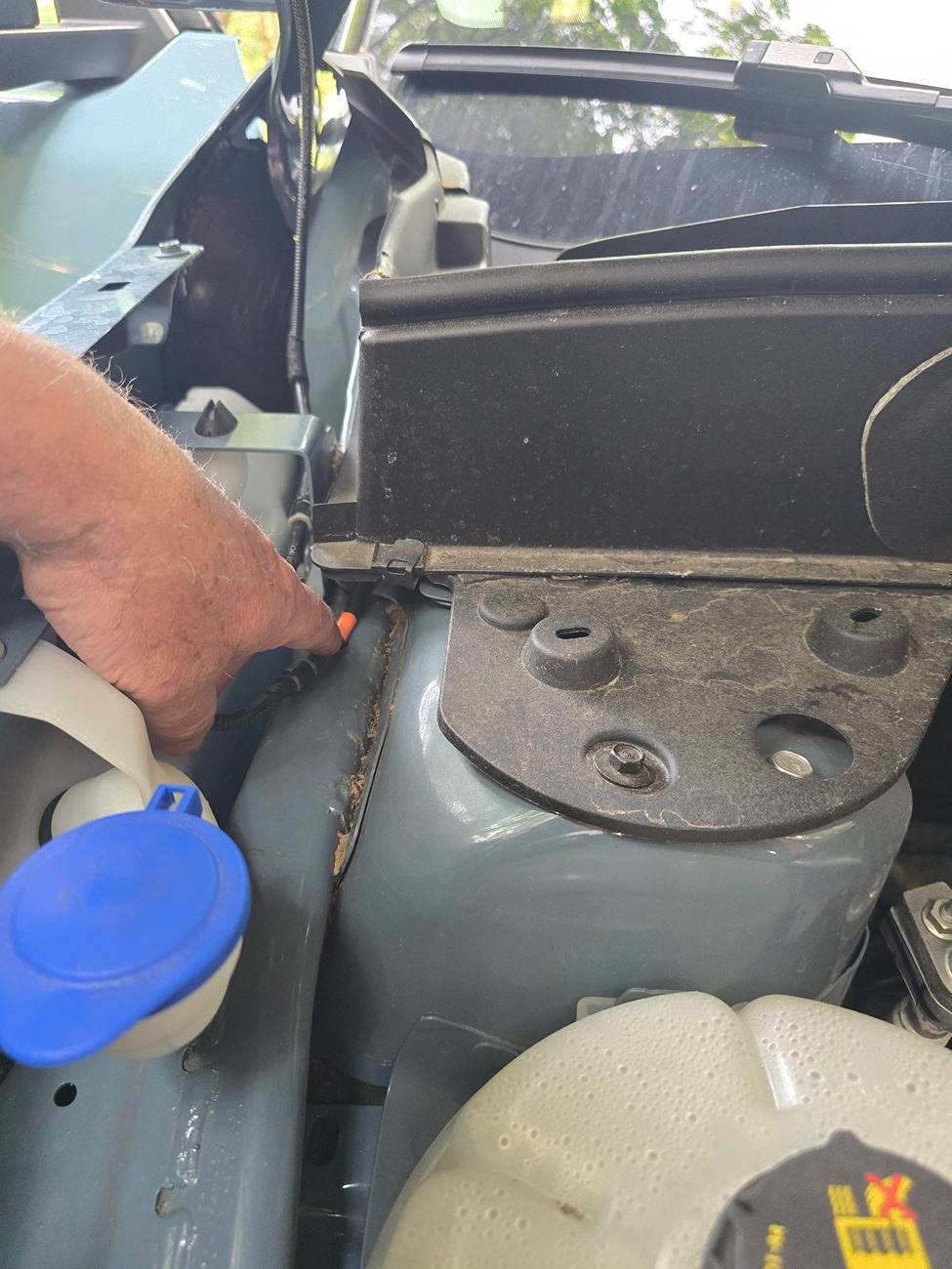

To add to this post: The two holes previously mentioned, (one on each side of vehicle) are not the only access opportunities. There are several more holes. See pictures. There are also drain flappers that are hidden. They do not close completely. Mice can crawl in those holes as well. I have yet to figure out what to do with those. They can't be plugged. I suppose I could stuff them with steel wool, which will quickly get fouled and cause water intrusion into the cabin. What an absolutely horrible design.
Ford Bronco Sport Deterring mice from the BS (nesting on cabin air filter) 17498432805696672512870669808544
Both sides of vehicle. Wire running into air plenum, unsealed. This is just below and forward of the obvious problem hole.
