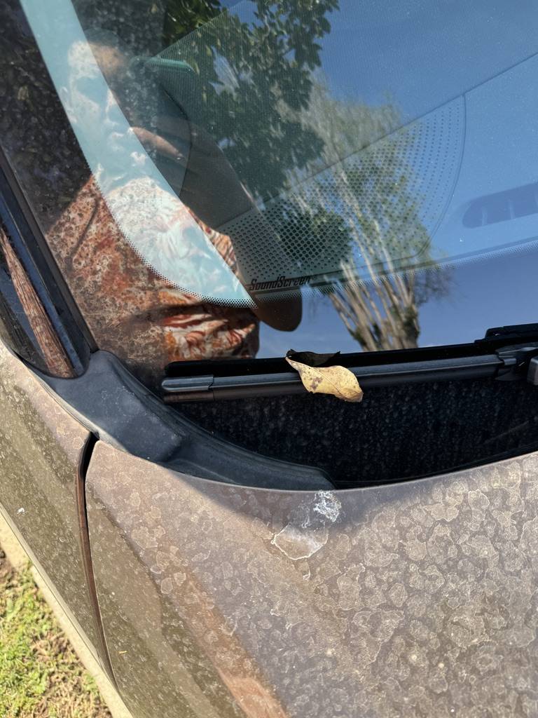

This is where the replacement proper length passenger side 22OE lands when down. Close, but not touching.

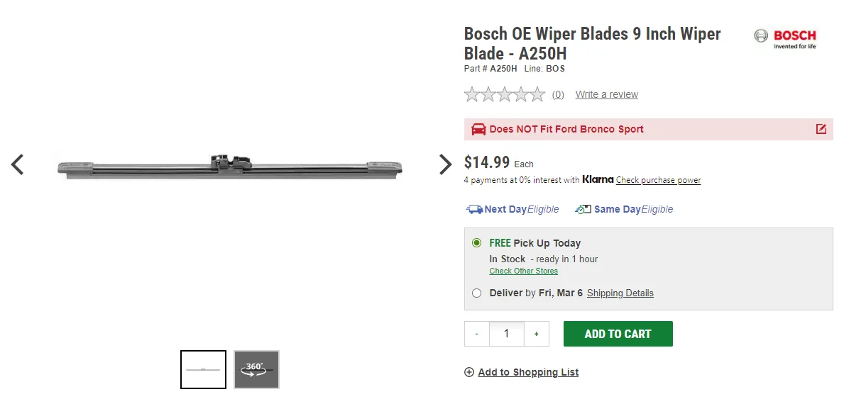

When it came to the rear wiper the official guides on their site and Amazon came up with nothing. I did not want to have my vehicle imbalanced between the front and rear wiper manufacturers and I did not want to let my rear suffer a worse wipe. I could have gone with OEM parts but I was deep in the sauce by now. With some research I found the Bosch Rear 10” (A250H). Most rear wipers are the wrong design or have the wrong connection, this one was perfect in both respects. Now the OEM rear wiper is 9” and had referenced online that some had said the length was so specific it shouldn’t be any longer or it will affect the lift gate or jump the window at the top touching the body.
I am so happy to report that the A250H does NOT jump the window nor affect the lift gate. (It'll never be straight up when I open the window hatch anyways.) Also, no streaking or other issues to be noticed. While it is longer, it still is within the window, admittedly barely, and gives you 5/8” more vision on each side than OEM which I’m sure we have all seen how small the wiper patch/view out the back is. Any additional width is greatly appreciated and I can confirm that it is a beautiful sight.

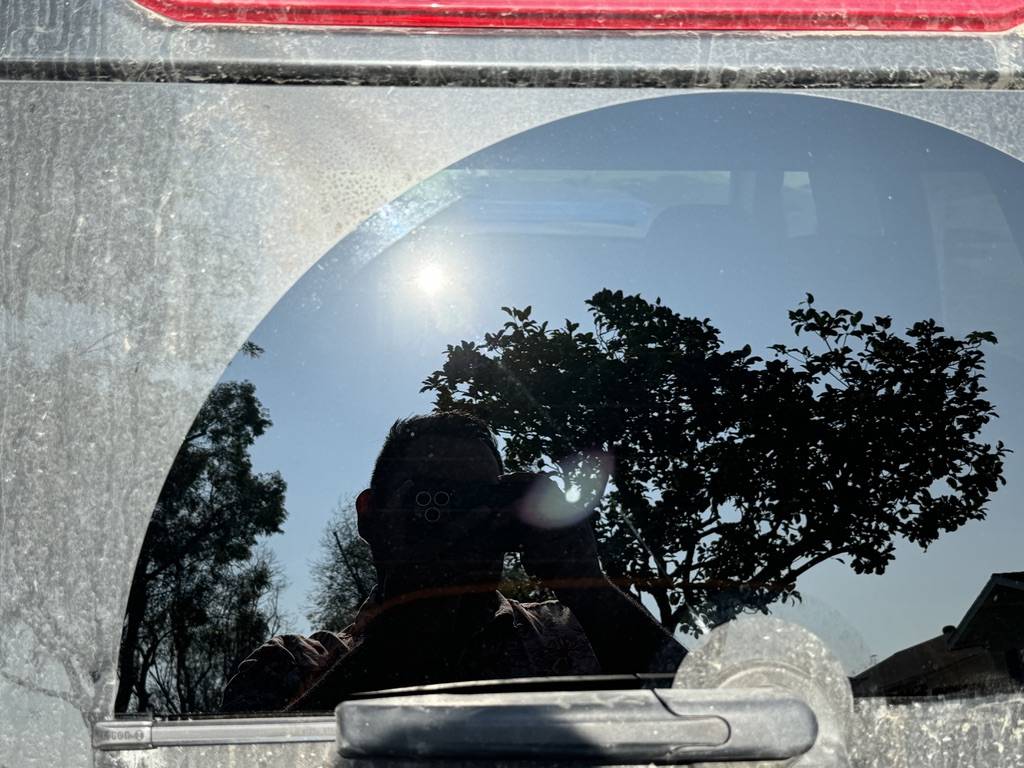

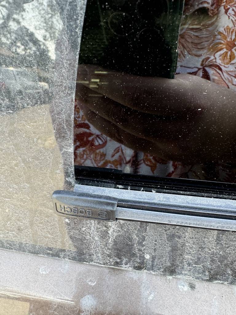

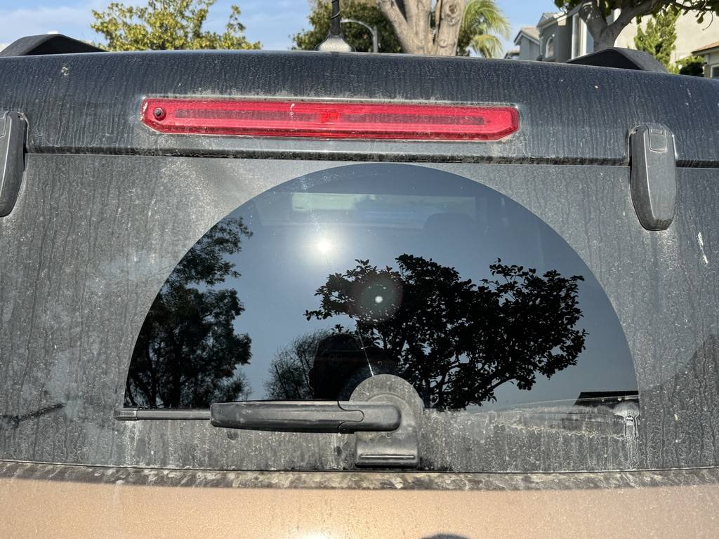

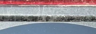

These last photos are of the extra width of visibility I get with the Bosch Rear. You can still see a bit of the old OEM stroke path to see how much more visibility you get on each side. This was still the first day or so, I've since taken her through the carwash and that old path is gone.

I saw your post on FB about the rear wiper and came here as well. Thanks for pointing out the front wiper issues with measurements. I bought the recommended wipers previously and noticed they didn't fit right. I simply swapped the driver and passenger. It works pretty well, but yes it does contact the rubber boot you mentioned. Really appreciate this post.
Thank you for sharing your research. I just purchased the Bosch A250H at my local O'Reilly Auto Parts based on your recommendation and it's a perfect fit. The cost was $14.99 plus tax. I called two dealers for the Motorcraft rear wiper blade and one wanted $33.00 and the other wanted $28.00. And the plus is that I got an extra inch. I mean, who doesn't want an extra inch?!
As a side note, I did set the wiper at 12 o'clock using the ignition/start button and opened the back glass to check for interference of which there is none whatsoever. The top edge of the glass moves away from the body as it lifts up so there's zero issues. The wiping pattern is identical to that which you posted.
