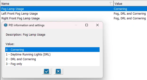

so yes, I'm sure the FLUC need to be set to "cornering" to work - but you also need to set each Fog Lamp Usage to include Cornering, and then it will start working.
so here's my current config in easy mode - which i don't recommend anyone model as it currently does "bizarro cornering":
Ford Bronco Sport Cornering lights enabling 2025+ 1777146364206-sc

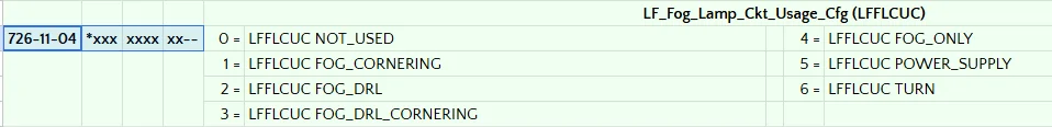

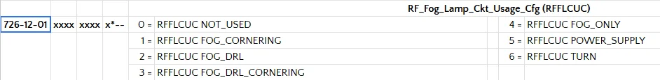

so the other 2 settings correlate with these in the 2025+ as-built data:
Ford Bronco Sport Cornering lights enabling 2025+ 1777147033257-84
Ford Bronco Sport Cornering lights enabling 2025+ 1777147131907-gn
IIRC, if you set the LF & RF Fog Usage settings to FOG_CORNERING (1) they will behave "correctly" and work as expected. I will try this tonight when i can park in front of my garage and see the behavior as i change parameters lol...
