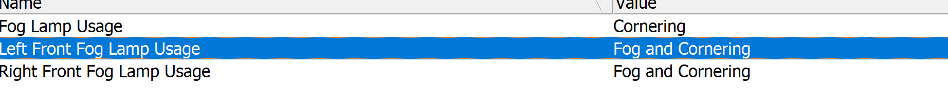

thats nothing new for the 2025. any bronco sport with fog/driving lights can do that. I don't only because my driving is out in the country and I have the driving lights on full time to light up the ditches looking out for deer moose and bears. haha

No, it's not new. But the 2025 version doesn't include it.:muscle:

Can you tell me how you did it in the BCM? By the way, I don't know what the BCM is, but if you can give me some information, I'd like to implement it because, as you correctly stated, the BS Badlands 2025 doesn't come with it from the factory. I'm writing it in English to respect the forum's language.

The BCM is the body control module. You would need FORScan to enable the feature.

The BCM is the Body Control Module.
These types of modifications are done by changing the configuration/programming of "the computer." The computer has many modules, all programmed similarly. The BCM is one of those modules.
For that, you need two things:
A) A cable to connect the car to the PC
B) The configuration software.
For Ford, and other brands in the same line, ideally you should have the FORScan software (it's not exclusive to Ford, even though the name might suggest it) and a cable compatible with the software and the car.
The FORScan website lists the recommended compatible cables.
The software is paid, but you can use a free trial version with some limitations, which you can renew as many times as you want.
It allows you to do a lot of things (including messing things up). Pay attention.
If you have any questions, write to me. I'm learning about this. I'm also from Buenos Aires, and I have the cable. @pantera155 is a genius on this subject.

Ok I tried this. And it would not work.
I don’t know what I did wrong, but I couldn’t get it to work for me.

What change did you make exactly and where?

I don’t recall at this point. It was one of the first things I tried changing.

Ah ok. We will wait for Pantera to confirm what spreadsheet he used. I assume he used the Maverick spreadsheet to get the BCM change....or maybe he used easy mode?

Are you calling the fog lights "cornering lights?"
Yes, you can have the left or right fog light turn on when you turn the steering wheel to the left or right to light up the road while you are turning. If you keep the fog lights on always like I do, this feature serves no purpose, but otherwsie, it works well.

Tenes que tenerla clara con Forscan!. Si nunca hiciste algo parecido te va a costar!.

It was definitely included on my 2025 Big Bend. I had to deactivate it with forscan. I find it a useless option especially since I run my fog lights all the time anyway.
