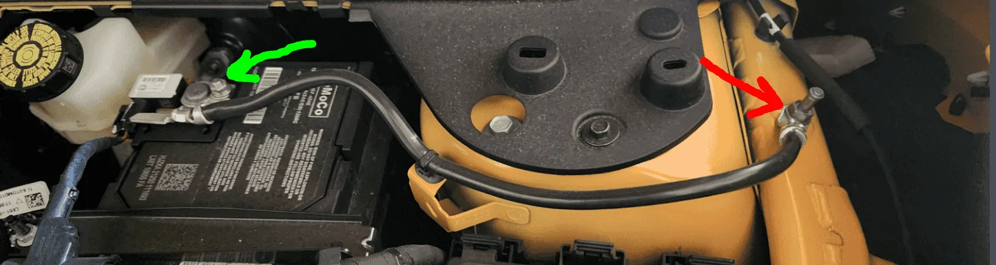

The negative connection to the right of the battery on the body?
Correct.

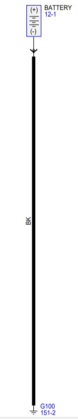

All negative returns (body grounds) go through that connection. So if it were disconnected, nothing would work. If it is loose, there could be any number of intermittent problems.
Some electrical issues do appear to be caused by a bad battery -- like Robert describes above. Especially since he checked the body ground and it was tight.
In other cases I can't help wondering if the cause was a loose body ground that was tightened when the battery was replaced.
Another possibility is a resistive ground connection. For example, the body is painted before that connection is made. The contact area should be bare metal with an oxidation inhibiter applied. There's a good chance Ford (and most other mfrs) do not bother with that, and just rely on current being able to flow from the stud > nut > cable lug. Whatever they are doing obviously works fine in most cases, but that could be a problem.

There are a lot of grounds all over the BS, but the return path to Bat(-) for all of them is through that main body ground connection > cable > Bat(-):
