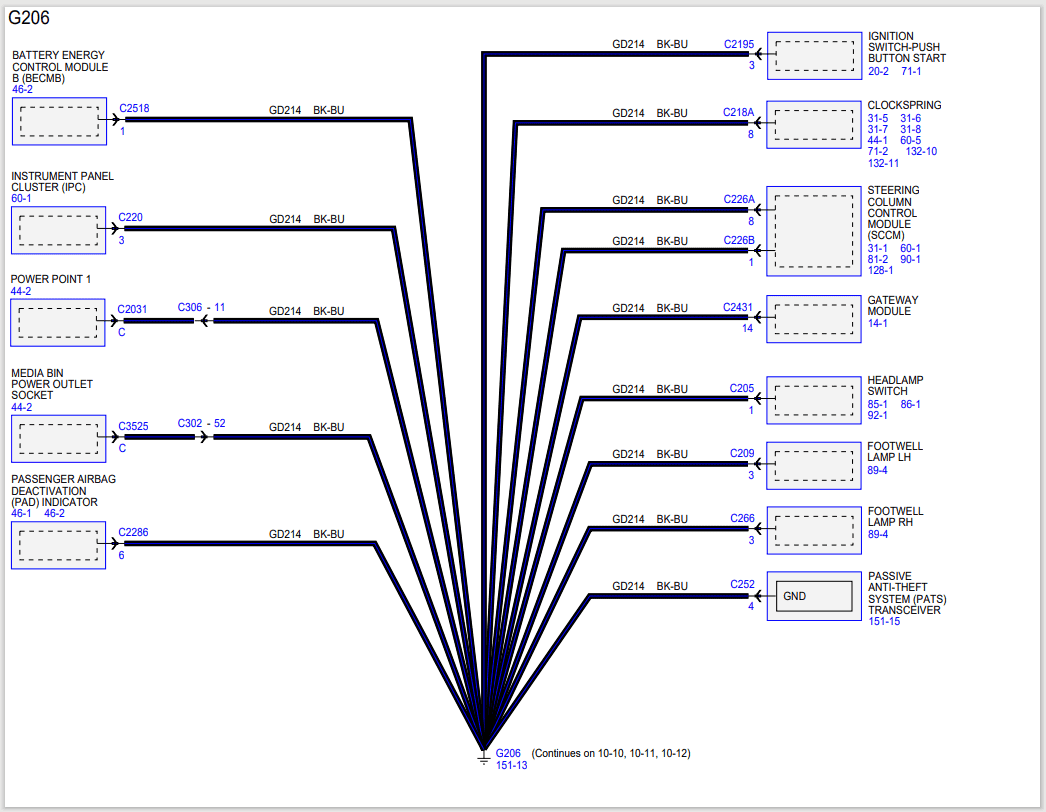

I got the Bronco Sport service manual DVD today (see post #32).
I could not find any other grounds like the neg(-) battery cable > fender. I thought there would at last be an engine block > body ground strap. I don't s one in the manual but I need to look more closely under the hood too.
There are multiple smaller grounds for individual components, and there are often many ground wires attached to one grounding point. There are 20+ pages of grounds! This page is a good example --14 ground wires:
Ford Bronco Sport Complete shut down while driving 1702355174834
Most components will not cause the BS to stall and not start if they lose their ground connection, but some clearly will -- like the ignition coils, which share a common grounding point (not shown here).
Ordinarily I would not suspect a loose ground, but there have been a few posts here in which the owner said the Ford tech told them they found a loose ground -- but no one has specified which one (AFAIK).
