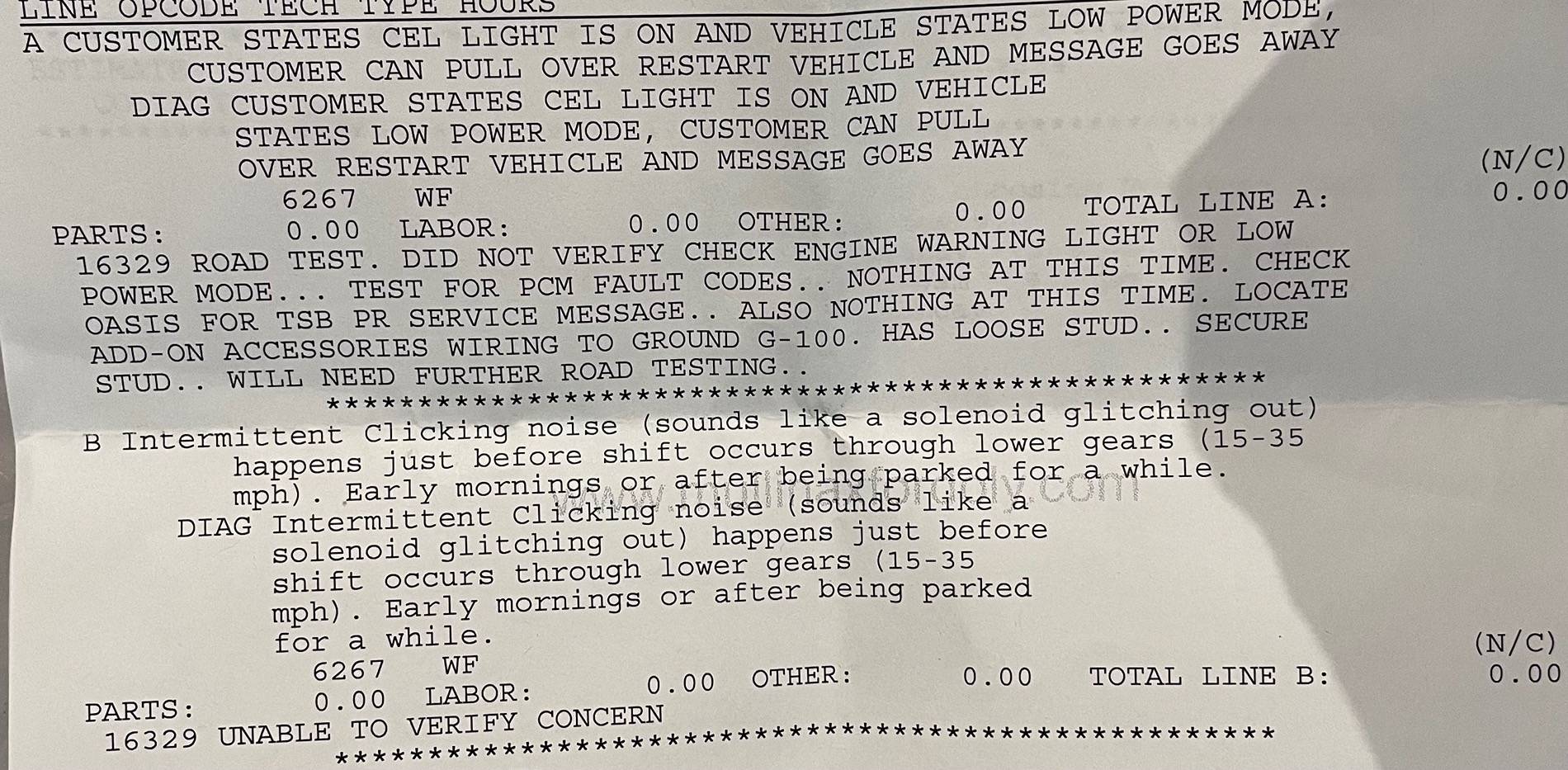

Update: got the car back from its appointment. Had a “powertrain malfunction/reduced power” code pop up. No effect on anything, went away after restart. Has happened 3x in the past year the exact same way.
Work order says it was a loose ground(I’m an idiot and although I do the best I can I’m not a professional. I thought I had the ground tightened and optimal but I guess not. Was very nervous to strip anything so makes sense. Feel very dumb now haha)
Clicking is gone.
But what’s interesting is in my dashcam clip the conversation goes as follows
“Look what I found here though”
Moves to be what I assume is my ground
“With all this add on shit I wonder if they stripped the nut”
Tech 2 “what’s the code”
Tech 1 “coolant bypass”
I’m confused cause the work order states nothing about a code or coolant bypass or anything of the sort. Not that it really matters. I’m assuming my faulty ground was causing the clicking and effecting the coolant bypass(which idk if coolant bypass would make that sound?)
Lesson learned. Gonna beat myself up for a bit over it haha but for future readers. Check your ground always.
Clicking is gone.

So clicking is fixed and the reasons for those noises due to loose ground? As far as I understand, was it ground near (under) the engine compartment fuse box?
Yes sorry for not being super clear about that. I believe it was the ground up top where the negative battery cable runs too. I had it secure but in the video you see the tech move something so maybe due to me being afraid of stripping it I didn’t have it fastened tight enough or it was off just enough to cause issues. Whatever they did stopped the clicking completely and according to the work order it was tightening that ground.
One more clarification for me pls:)
First, you reset KAM, and after clicking noise is gone.
After some period of time, it's returned?
And after, Ford technicians did something with the ground and again noise is gone?
Exactly! I’m so sorry for being all over the place with my story.
I thought it was there since new but I installed my aux lights shortly after getting it so my memory is probably mistaken and it started after screwing with that ground.
Did KAM reset and it went away. Than it came back but super quiet and even more intermittent shortly after.
Took to dealership and it’s gone completely after what they said was tightening that ground.
