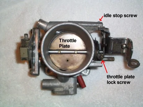

Here's a SWAG for you:
These vehicles use drive-by-wire technology. That means your accelerator pedal is not mechanically connected to the throttle plate. The pic below is not a Bronco Sport, it's just to show you what the throttle plate looks like. The throttle plate in your car is positioned by an electric servo in response to commands from the powertrain control module. It's possible the rattling you hear is the throttle plate vibrating. The servo may be going bad, or the plate may have a loose connection to the servo. The only way to determine this would be to remove the intake tubing in front of the throttle body and either try to manipulate the plate by hand, or observe it while the engine is running.
Ford Bronco Sport Clicking noise captured on video Throttle_plat
I’ll take a look at that this weekend. Thank you for some input cause I’m completely lost. I watched this video (anyone who wants a full overview of what’s going on beneath the hood of the 1.5L I recommend watching this) and the clicking honestly sounds like it’s coming from where he points out is the electric motor to the gear selector but it’s impossible to really know. Plus wouldn’t explain why it’s happening upon shifting through the lower gears I don’t think

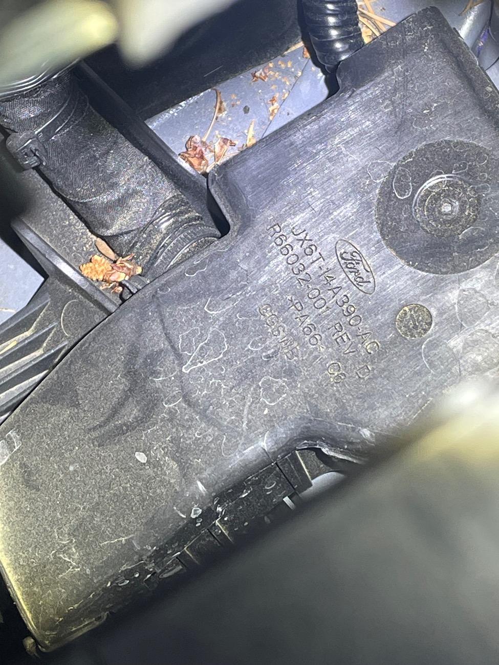

It honestly sounds like it’s coming from inside the black box in my second video. But I don’t imagine that would make any sense at all. This is the view of it from above directly below and behind the battery. Anyone know if there is any relays or solenoids of some sort in there?
