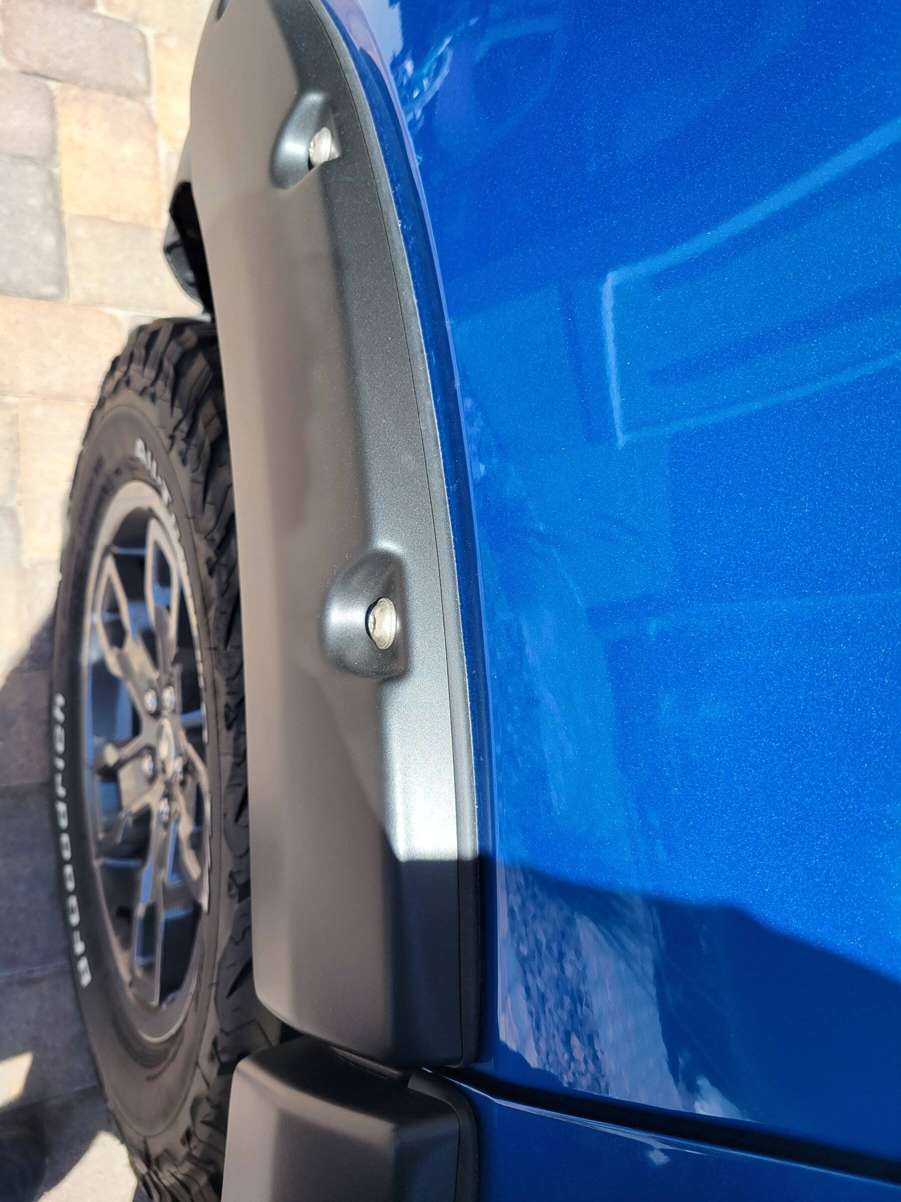

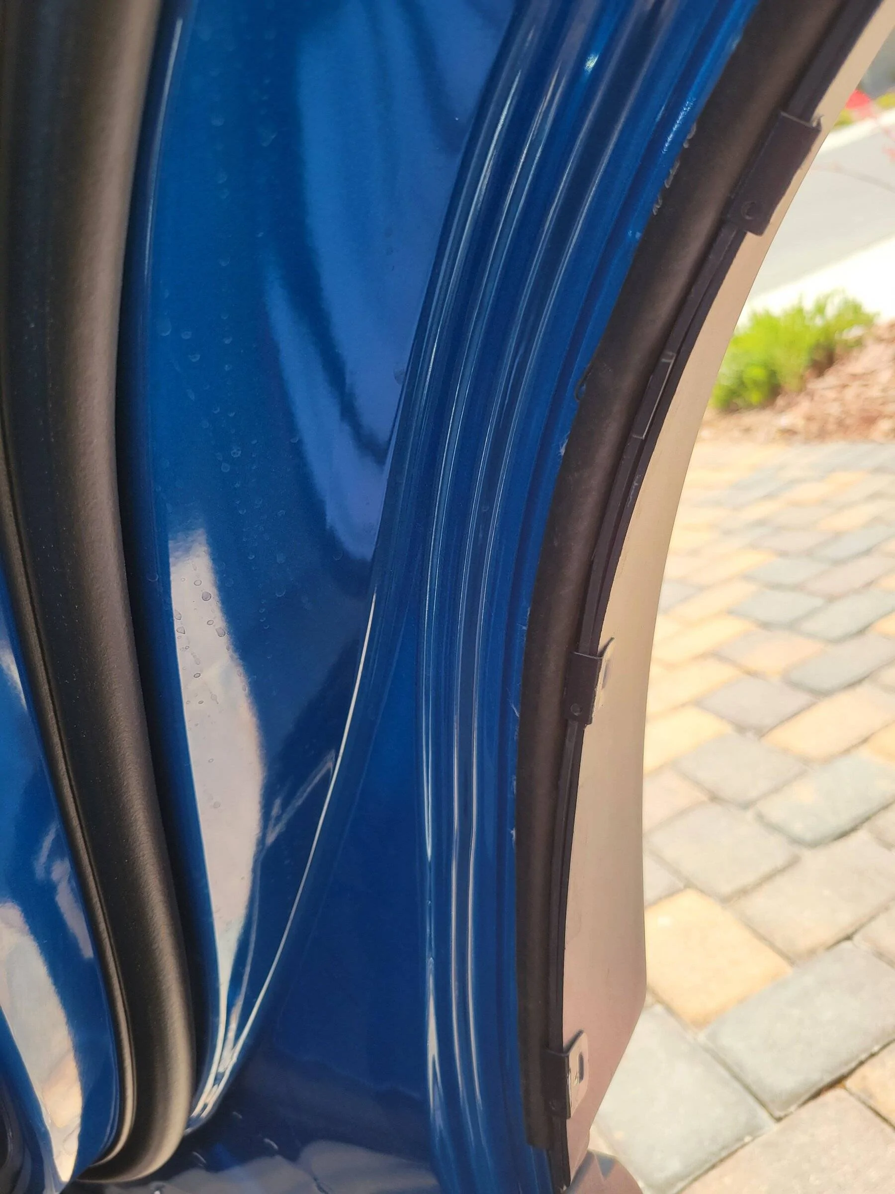

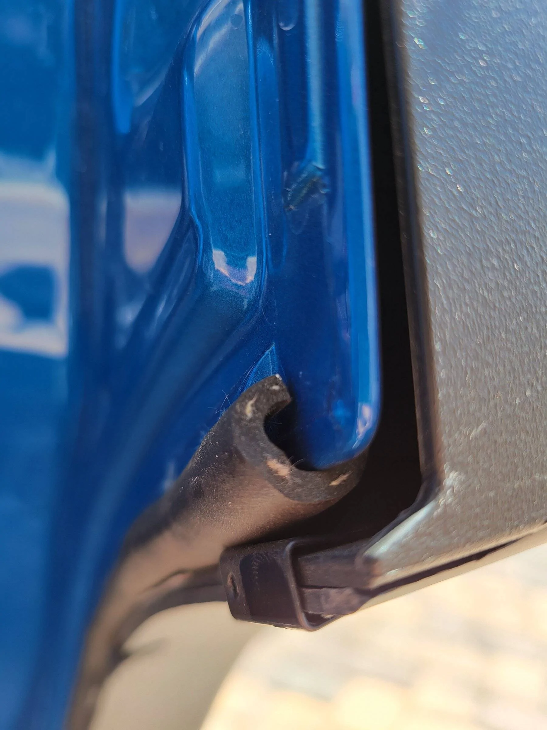

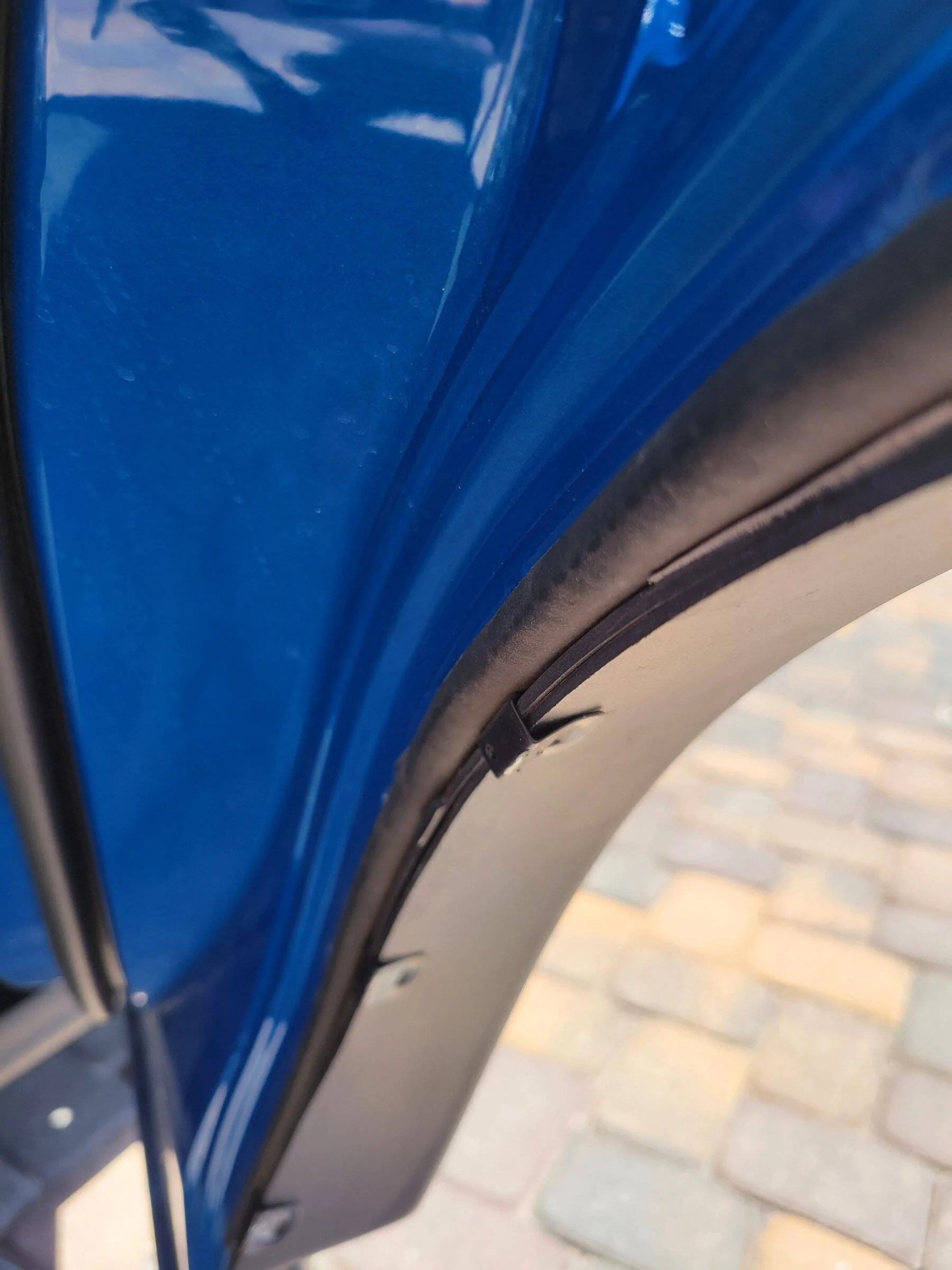

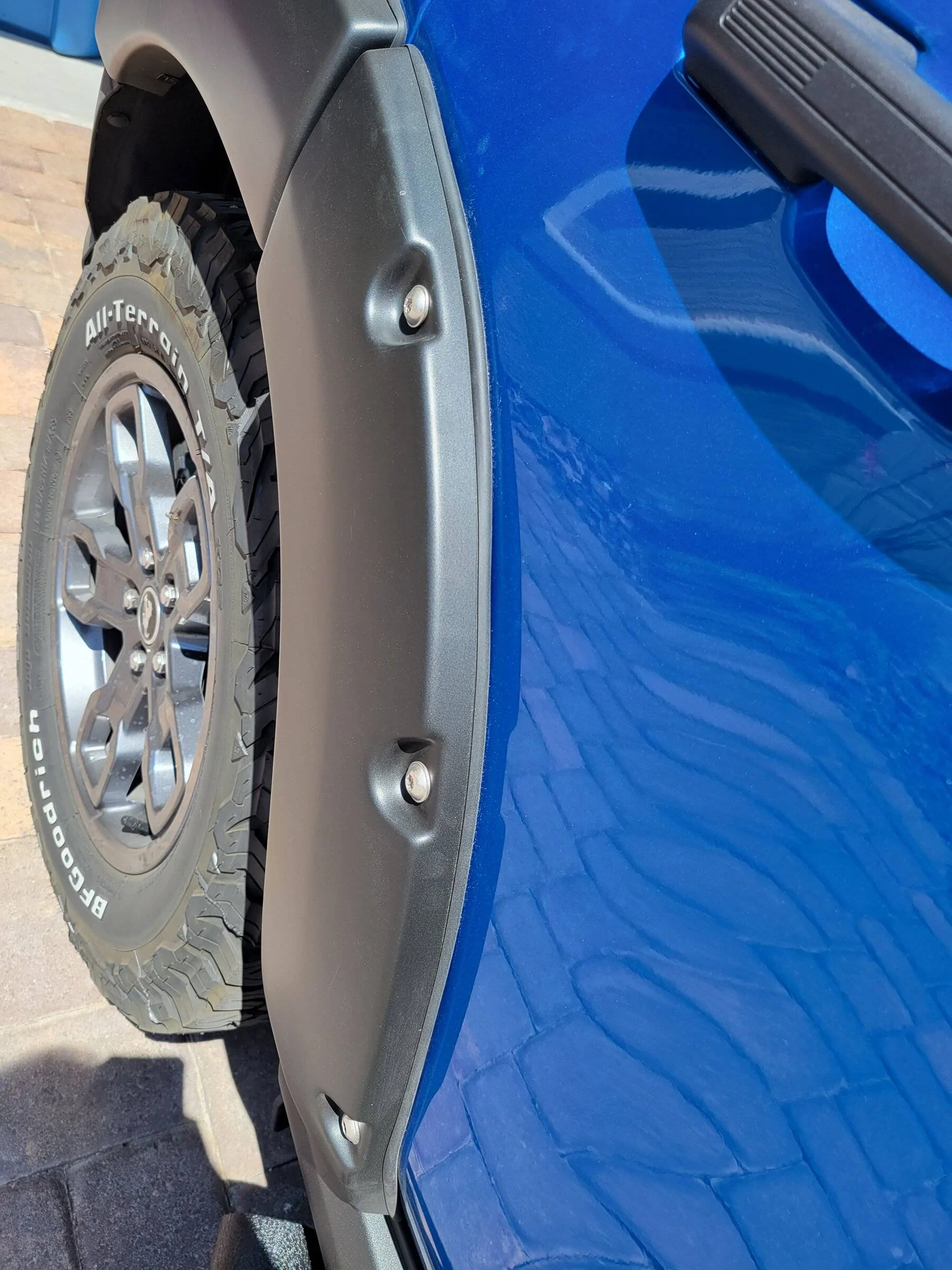

So I had the same issue with the Rough Country ones I installed. Also almost lost them from the insane winds here in Vegas. I tried everything I could with the included clips to modify it to fit more snug. The only issues I had was with the rear flares on the doors. I noticed a tiny gap between the molding on the doors and the metal where the clips snap into. My dad who's been in the automotive field for 50 years suggested we try inserting a fuel hose that has been sliced to prevent it from flexing. I have attached the modification we made and can report after a week and taking it almost 80 mph. It has fixed the issues I was having with mine. Hope this helps! Some people said they didn't have a gap in theirs in a different thread but mine did.
