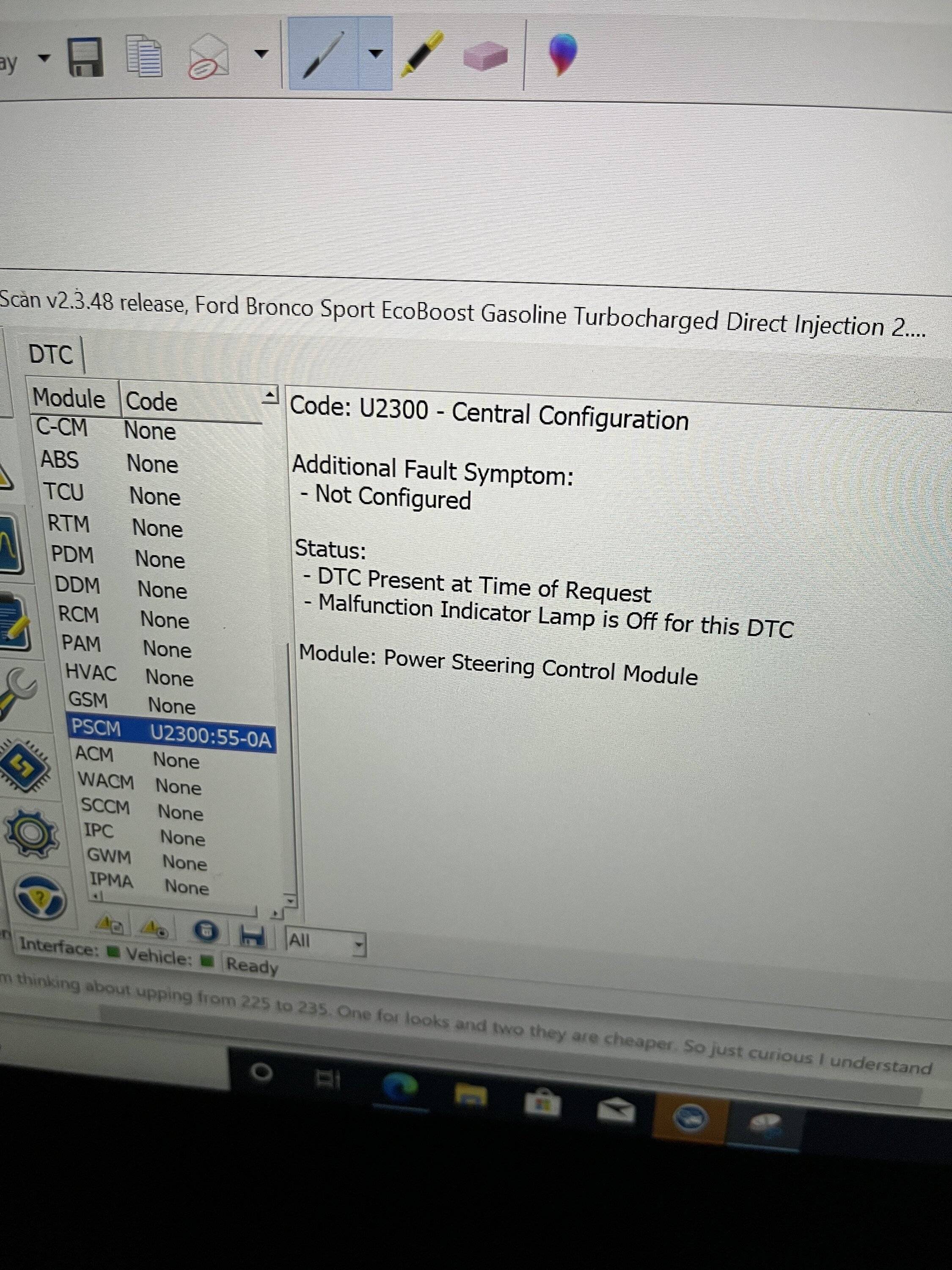

Changed my tire size today, no issues. This DTC was present before I did anything. Seems to be related to power steering.

Well my tire change was a no go. The AWD module relearned no issues but the PCM will not relearn. When I go to relearn it states tire circumference outside of module range. Looks like per the workflow that was listed some modules have a max range so mine must. Thankfully I only went from 225/65/17 to 235/65/17...2204 circumference to a 2314...so it only causes about 1 mph difference. I can live with it.
