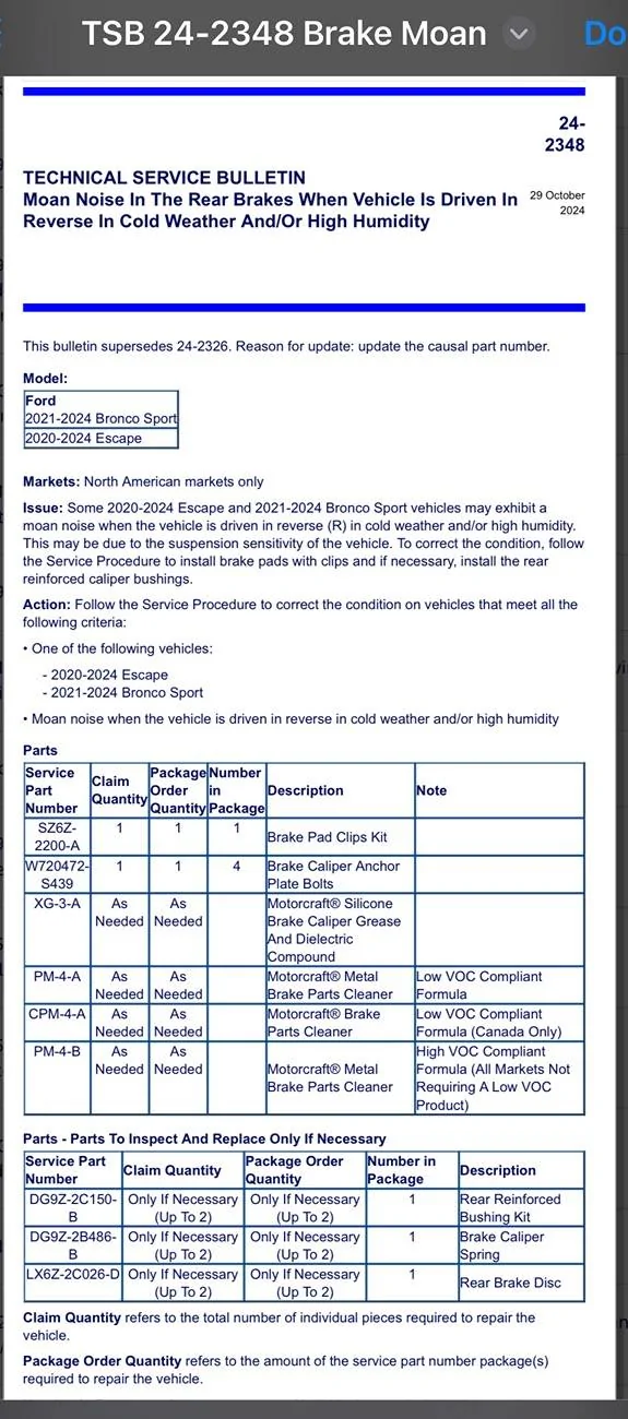

TSB-24-2326
Brand new TSB just released today....updated parts, including new brake pads with clips.

TSB-24-2326

@EARLSAYS I’m not able to locate TSB 24-2326, can you please post a link to the PDF or post pics showing 24-2326 content? Thanks!
Never mind about 24-2326. There is the new TSB 24-2348:
TSB 24-2348
This bulletin supersedes 24-2326. Reason for update: update the causal part number.

Had TSB 24-2348 completed 12/5/2024 (covered under the 36 month 36k mile warranty):
SOP INSTALL BRAKE - IN REVERSE VEHICLE MOANS, REFER TO TSB 24-2348
BRO1 BRAKE CONCERN
2 DG9Z*2C150*B BOLT
1 SZ62*2200*A PAD - BRAKE (possibly is Brake Pad Clips Kit)
2020-2024 Escape, 2021-2024 Bronco Sport: Replace The Caliper Bushings, Guide Pins And Brake Pads On Both (2) Rear Brake Calipers
Following The Service Procedure Includes Time To Clean Bushing Housing And Add Grease (Can Be Claimed With Operation C, D, E, Or F) (Do Not Use With Any Other Labor Operations Outside Of This Article)
2021-2024 Bronco Sport: Additional Time To Machine Both Rear Disc Brake Rotors On Vehicle (Can Be Claimed with Operation A Or B)
242348E0.7 Hrs
242348B1.4 Hrs.
