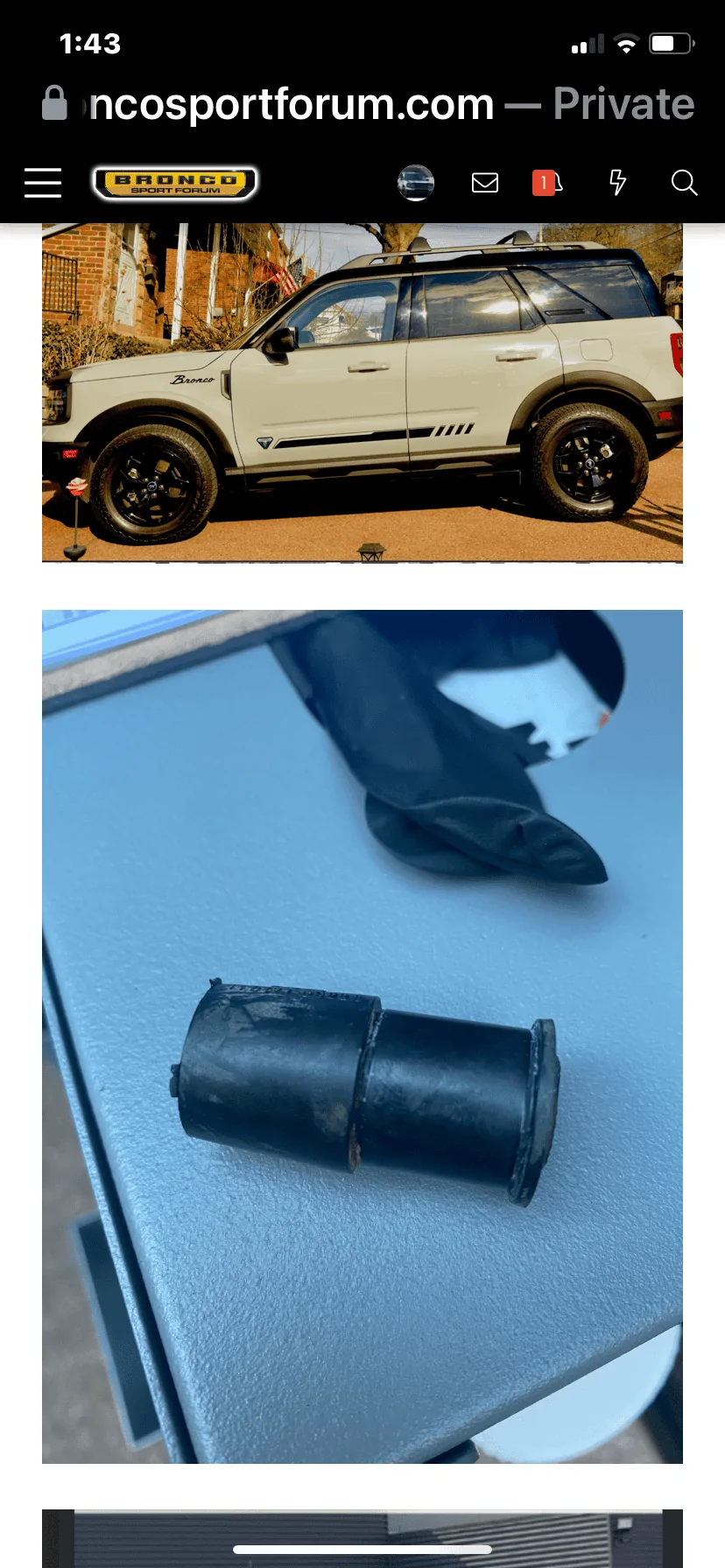

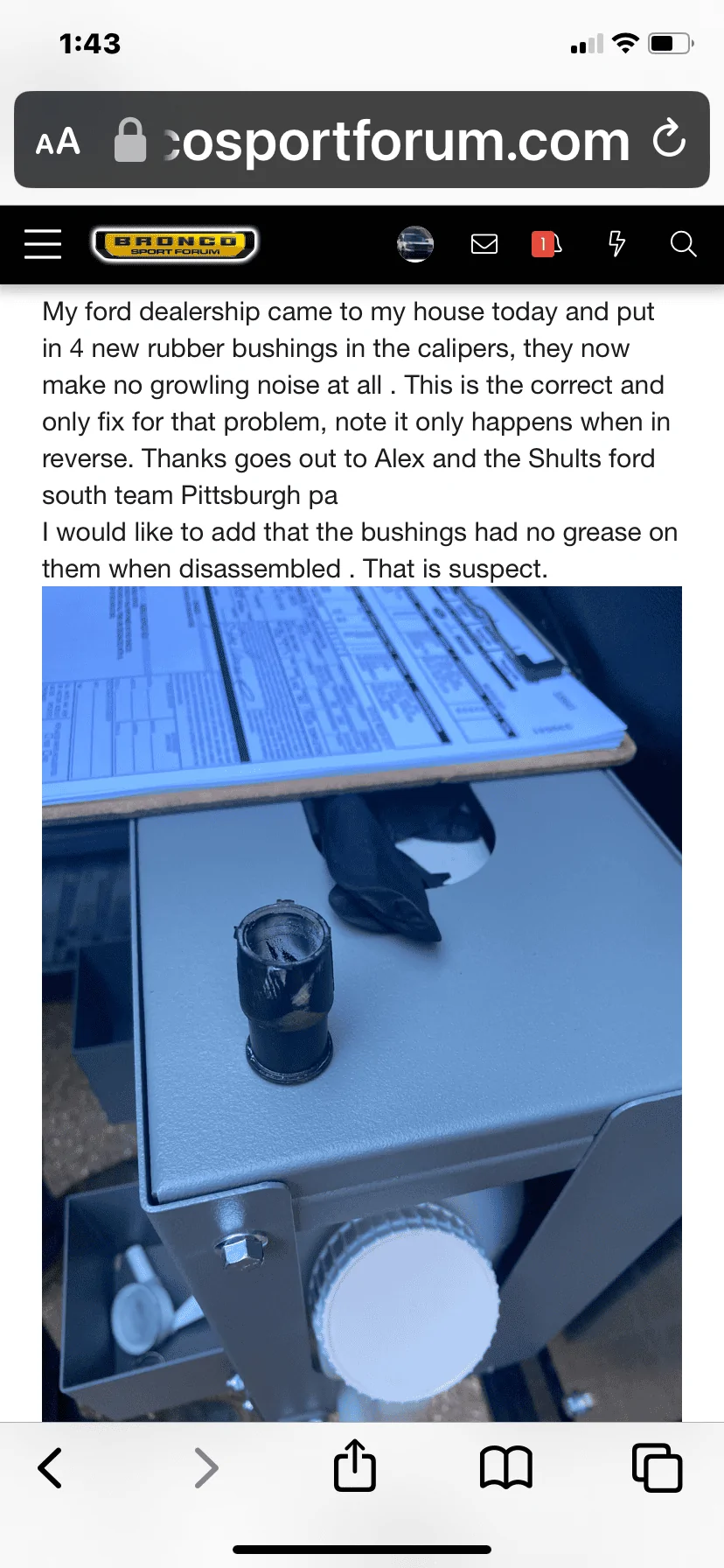

I waited about 4 weeks and then they came to my house and did repair . Took about a half hour , slide rubber bushing. Two per side . My opinion is it has something to do with that hold feature, which by the way is one of my favorites . Been fixed about 2 months now ,all good . Just a note , mine only started when it was18 months old .

There is a tsb on that .It is the caliber bushings rubber boots . They will fix , paid for by Ford . Look it up on this forum , you can see my post .

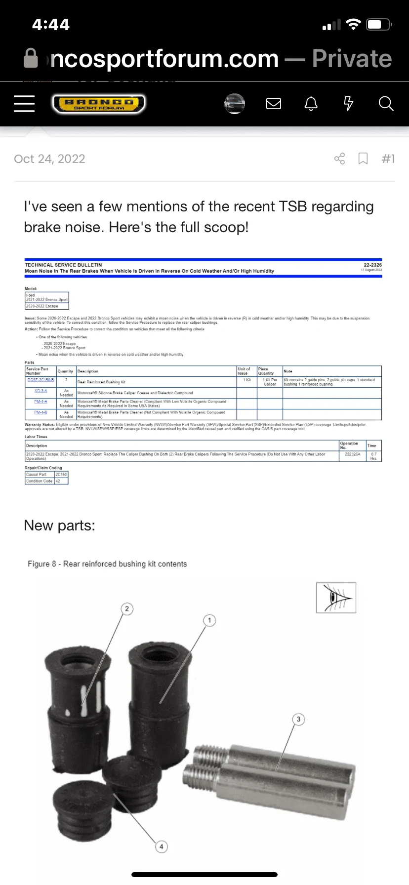

Ford released a TSB recently which instructs dealer service to replace rear caliper bushings to fix the noise problem. Prior to that dealers didn't know how to fix it.
Thank you for this information. Would you happen know the date and or the reference that this was advised to all Ford Dealers?

aug 17 22
T S B-22 2326 read
