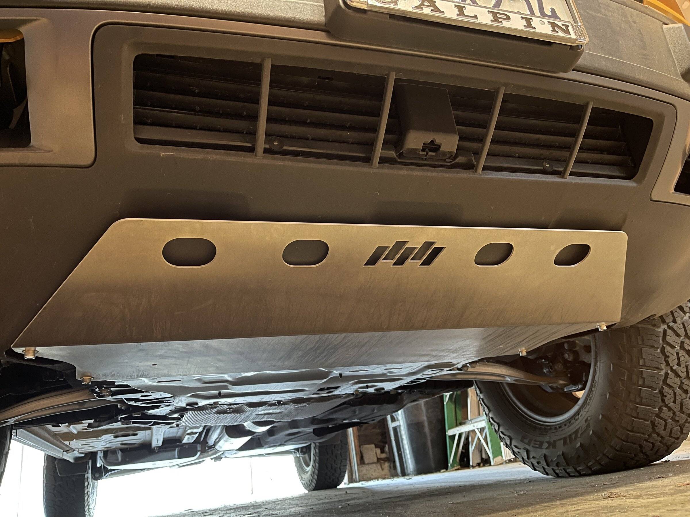

So I have the Rally Innovations front skid plate installed along with the 1-3/4" lift from Robby Woolworth and the 245/70/R17 Falken Wildpeak AT3W's. Total added ground clearance is about 2-1/2". The front skid looks pretty nice, it's made from sturdy aluminum and it does not impact approach angle at all. Took it through a pretty tough trail today and it all worked great. About the only less than great thing is that there doesn't appear to be any way to attach the front/top of the skid plate to the vehicle. I think that the skid plate will do a good job to protect against the most common kinds of front end damage caused by not enough clearance for the obstacle. But, if you really plant the nose in a hole or something while descending a steep hill, it seems like there's a good chance it will peel back and under the car. Also upgraded the attaching bolts for a little more strength and to an internal hex type to make them easier to remove after a rock has damaged the bolt head. Overall very happy!

Looks great! Saw on in Moab this weekend at Off-Rodeo. Looks like you did not use conical washers?
Also, the one I saw had adjusted the the back spacers to make it closer in the front. Did you keep all the spacers the same?

You might want to look for some button head screws, maybe a little less likely to get sheared off.

Shop decided against the washers thinking that damage would still occur and the washers would make it very difficult to remove and replace damaged bolts. Not sure if I agree or not but am going to run like this for a while and see how it works out.
