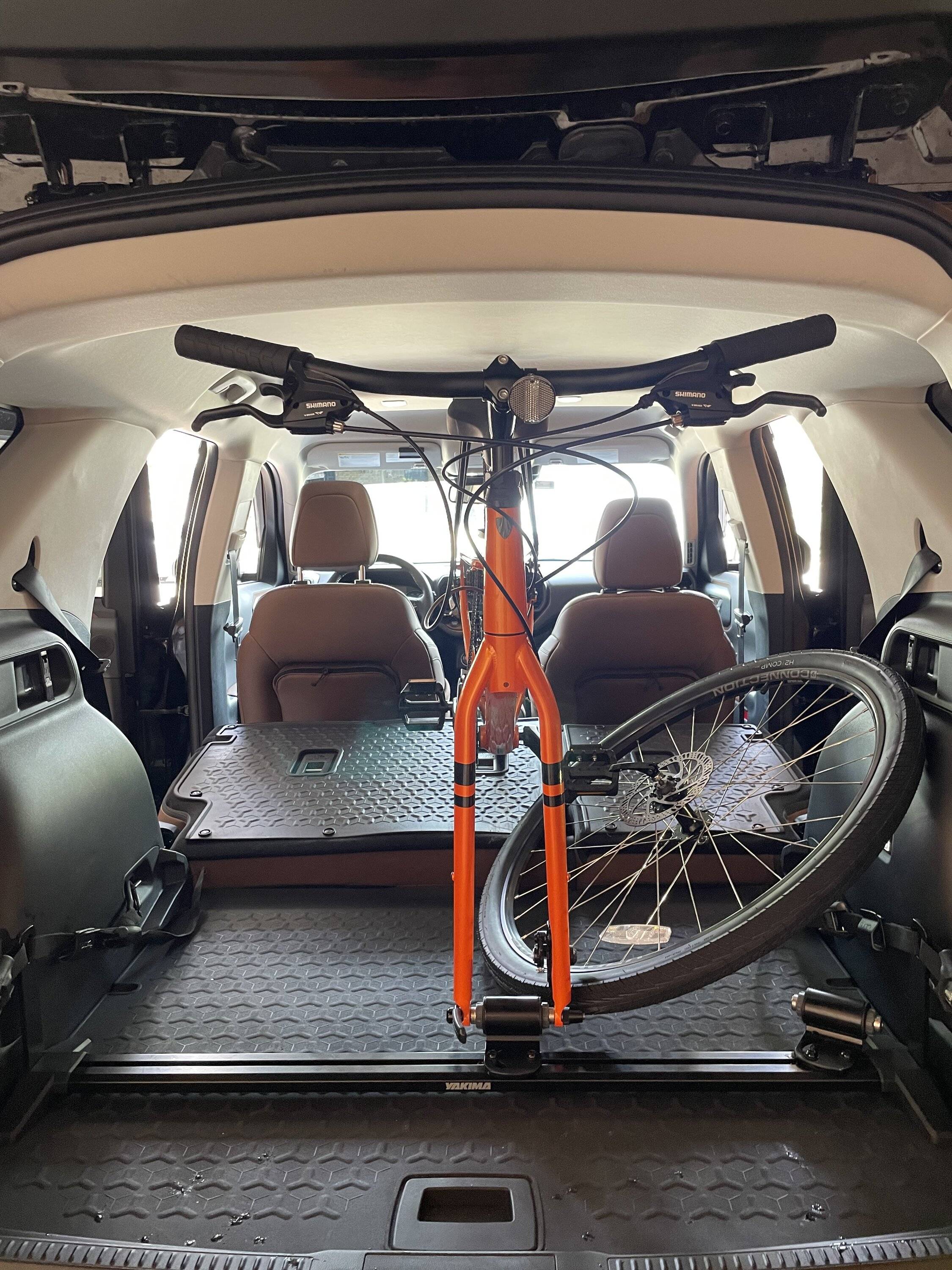

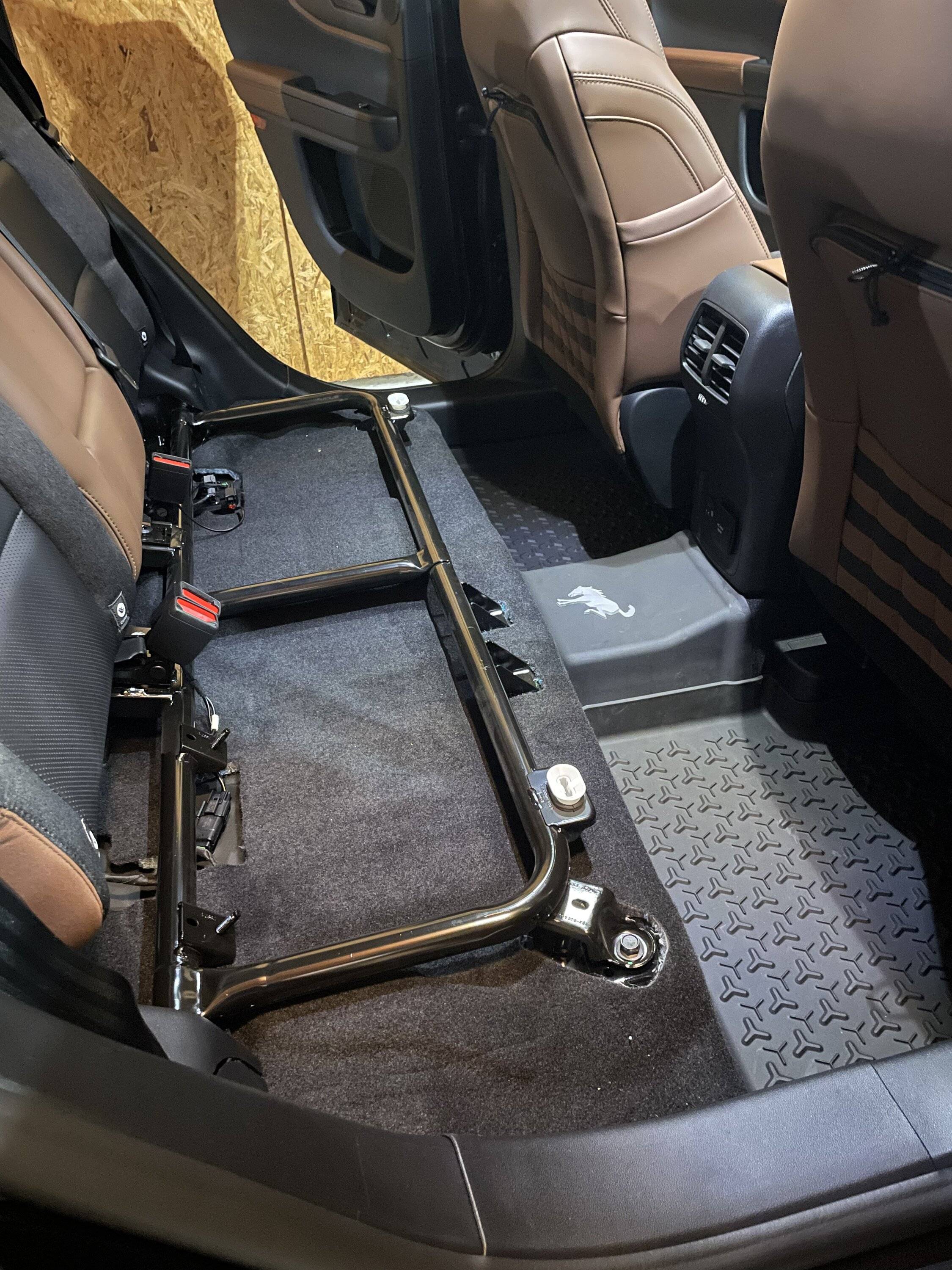

If you look at the pic that was posted from Ford it does appear they have seats and handle bars lowered. I have also attached a pic of when I removed my back seat. It’s easier than you would think, and also pops back in. In the Ford pic the way the seats lay flat also appears it was removed for the sake of 2 bikes. The fork mount does swivel and positioning of the mount is important too closer or further from hatch. I haven’t put two, I would imagine it’s possible, but requires some additional maneuvering. Also, the rack comes with additional straps and recommends if using two bike, both rear tires between the front seats then strapping them together with a Velcro strap it comes with.

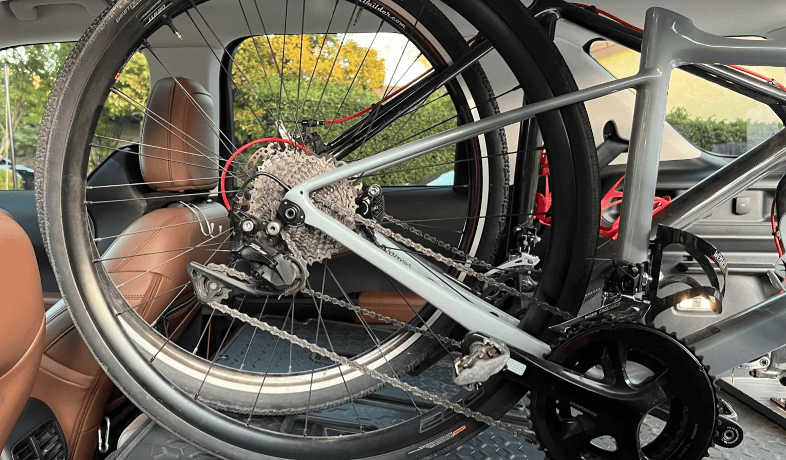

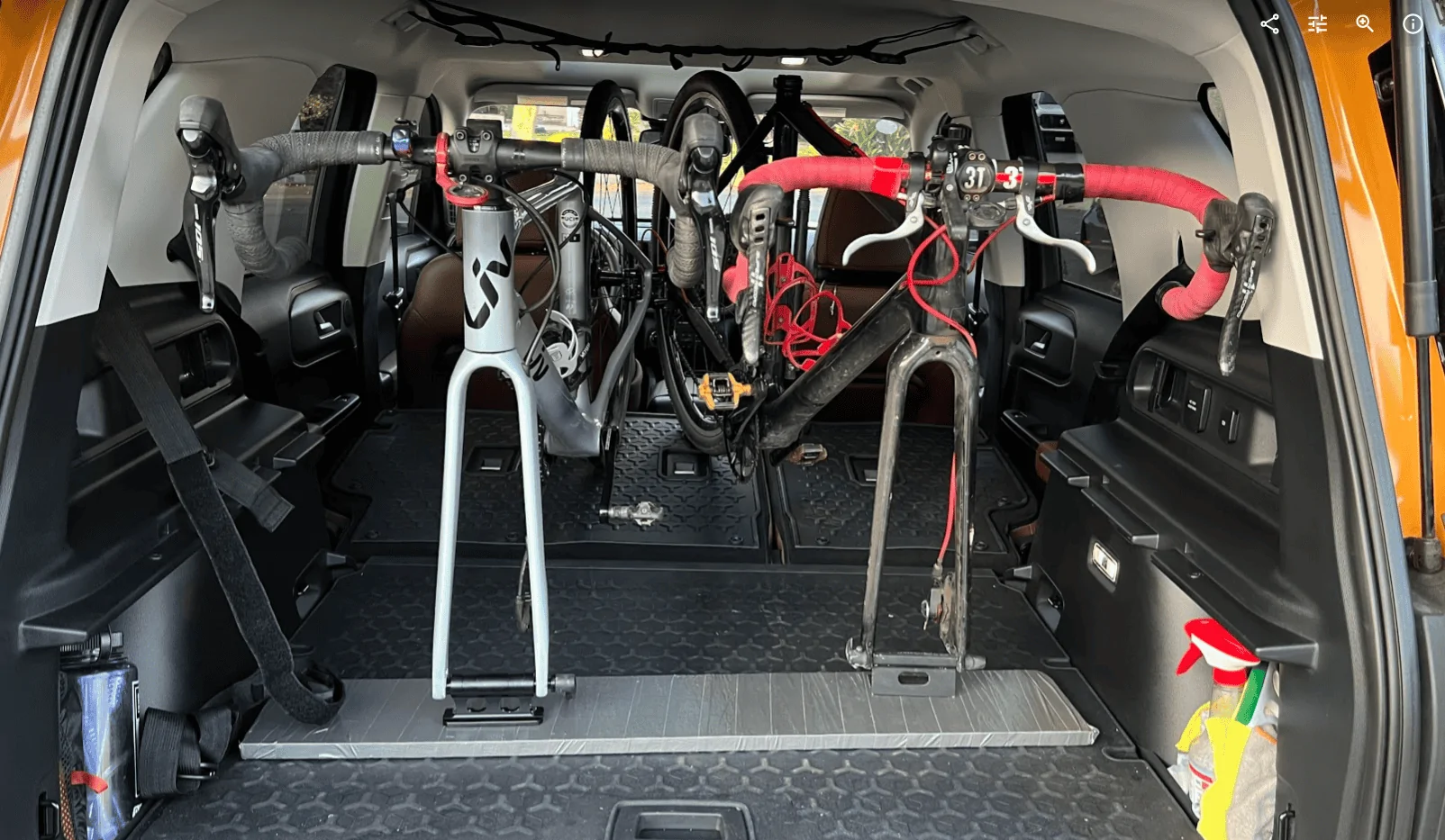

there is no doubt it is a tight fit....The black bike is only a 54cm frame cyclocross bike. The silver one is a size small Giant women's road bike. That duct tape covered plywood rack I've had it for many years. I just had to mount a thru axel fork mount for my wife's bike.

The trouble I have with my mountain bike not able to stand on fork mount is one of it has 150 mm of travel so from the fork axel to the top of handle bar is taller than the available clear height of the trunk area. the only way to do it is to remove the trunk cover (to the spare tire)...or, compress the fork with a Velcro strap.
90% of the time I'd carry bike(s) with rear hitch rack anyway. this is for on occasions if we anticipate stopping at a restaurant

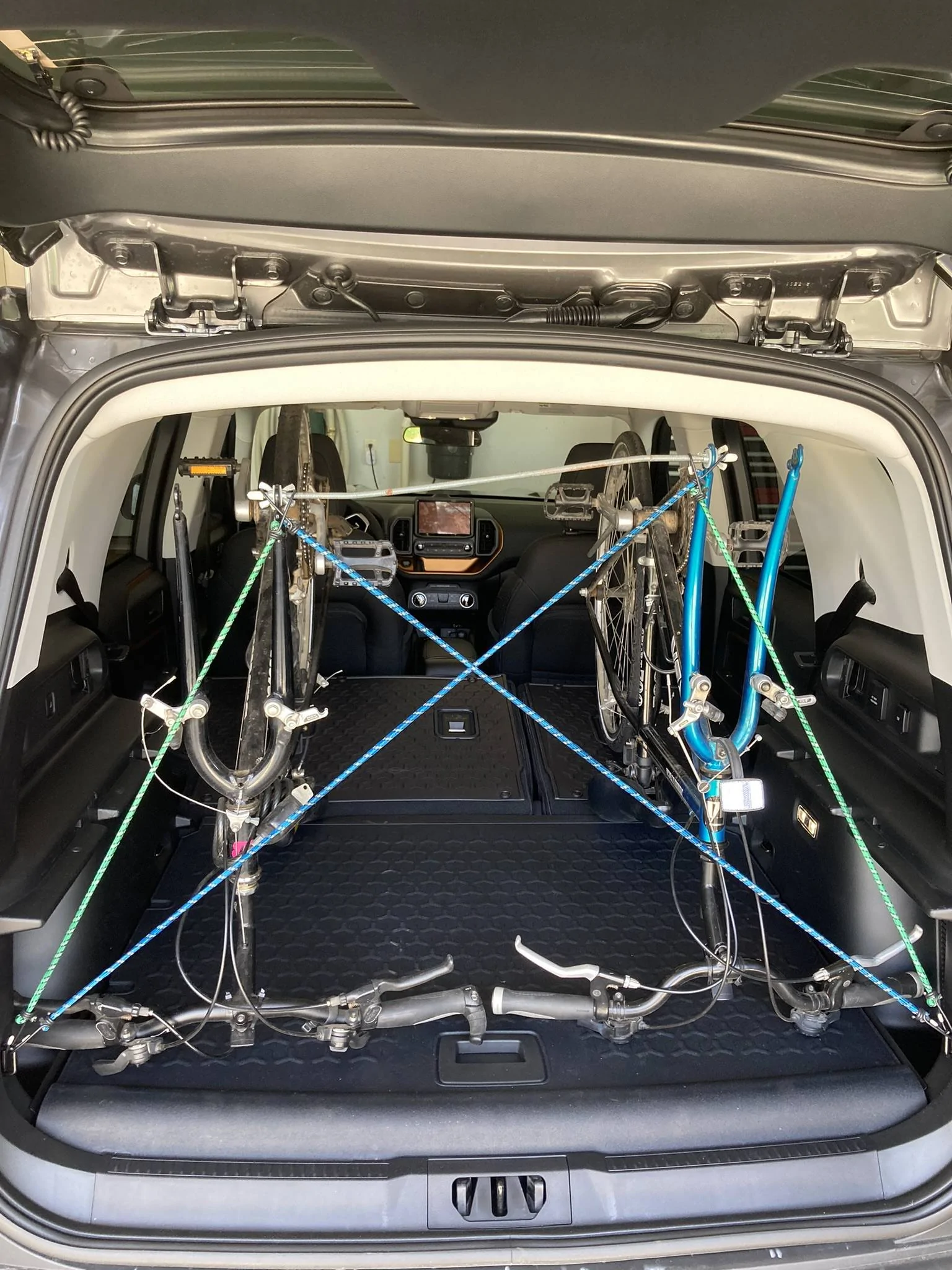

Here is my solution to this problem. Did it the same way in the old Escape.

very interesting use of the fork dropouts to space the two bikes. that just a bent threaded steel bar?!

Yes, bent threaded rod and wing nuts. The back wheels have small bungee's to the child seat latch points.
