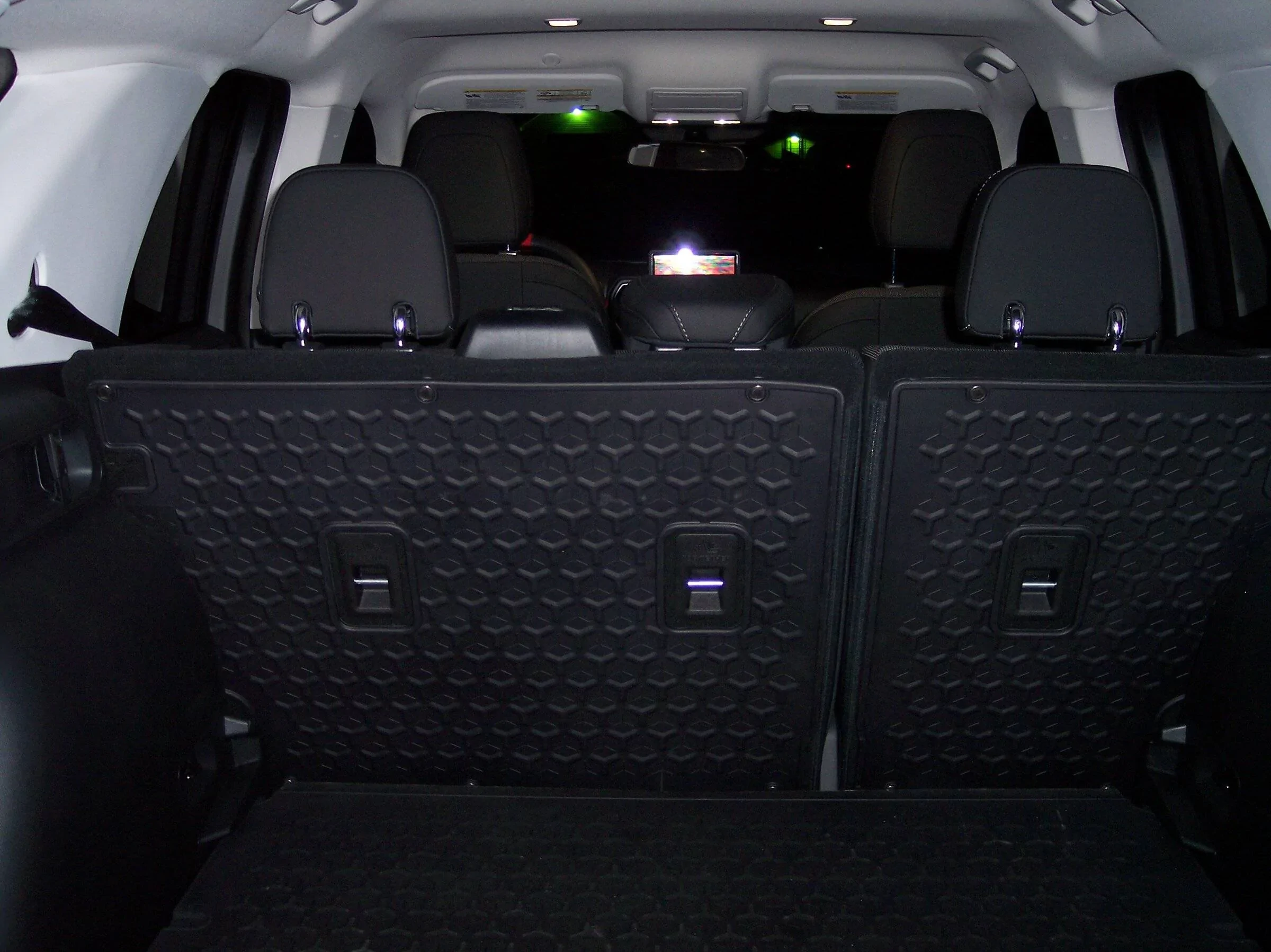

Hello everyone, I just got an Area 51 big bend on wed. And I’m loving it . Can someone post a picture of the rubber seat backs after install? Having a little trouble with them and I’m not sure they sent me all of them . Thank you!
Sorry the pic is a little dark, I just went out & took the pic.

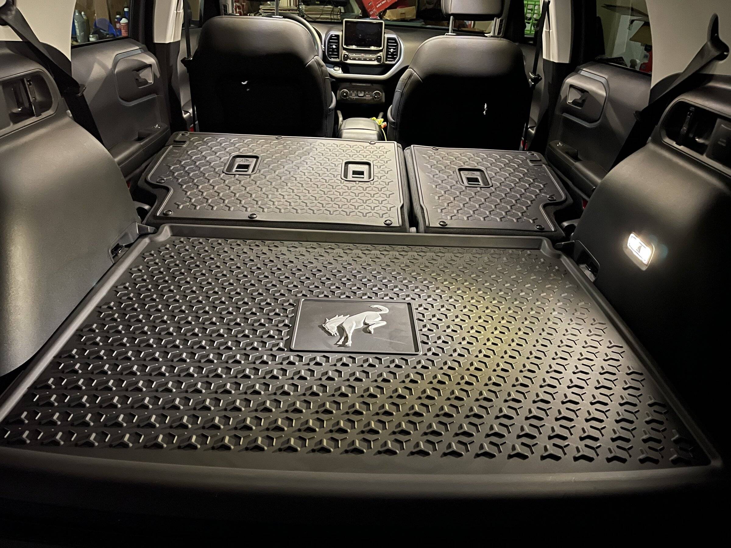

It was tough to snap everyone on but I manage to do it. I figured maybe because it was the cold winter weather that caused the plastic to shrink but now I'm thinking it is just the weird snap design that does not allow for error. All the buttons were in proximity to where it needed to be but was just very hard to push them down.
Deleted member 6568
Guest
It took longer than I anticipated but they do fit. Take your time with the difficult ones and be patient.
