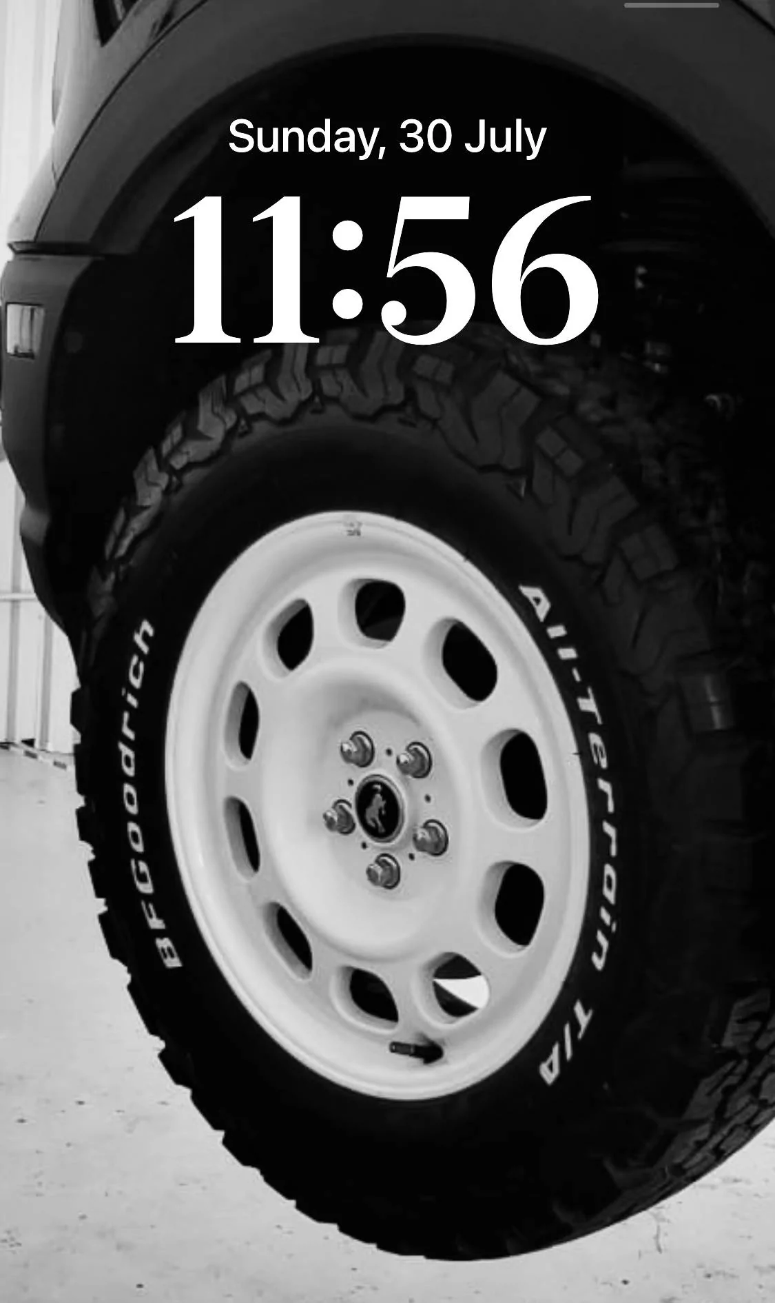

245/70/R17
Ford Bronco Sport Biggest size tires for Bronco Badlands without doing a lift? D2D44889-9806-4F5A-91D0-D220B36688AD
245 70 17? No rub? Most of people in the forum affirm the largest are 245 65 17 or 235 70 17. Do you do some off road? What during flex? Thanks for any answer you can give!
I got the 1.5” lift (recommended)
With the 245 65 17 no need to lift and no rub.
