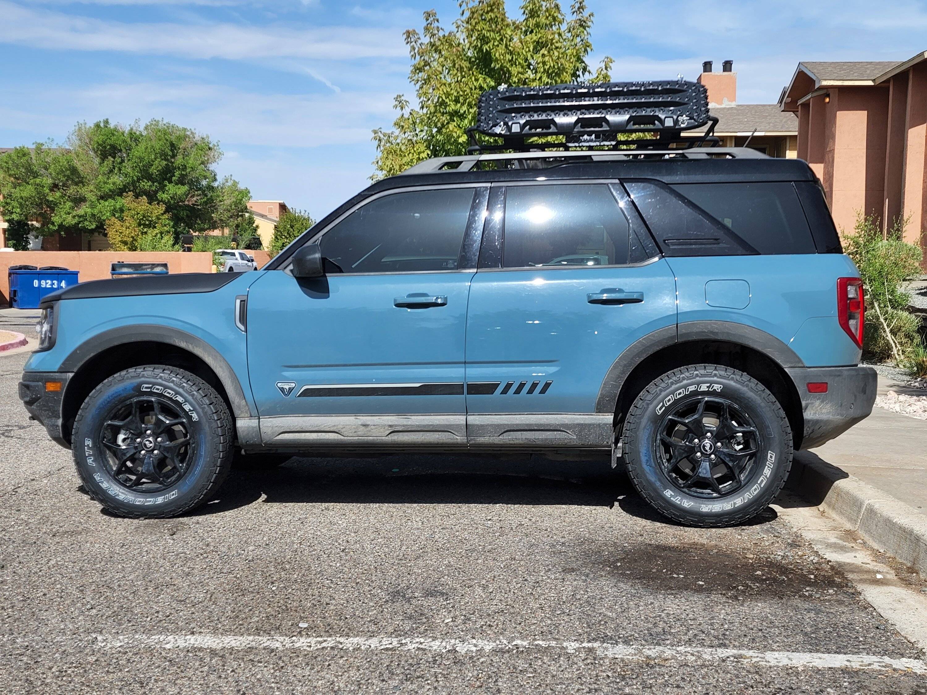

Ford Bronco Sport Big Tires for BS Badlands 20220618_094900
Heres just after I put them on. They're 30.1in, XL rated, only slightly heavier than the Falken OEMs. Quieter ride too. I dont drive aggressively, but no effect on handling that I can tell and no effect on mpg either

Are these 235/70-17’s or 245/70-17’s? Your earlier post says 235’s but I don’t see those listed anywhere.

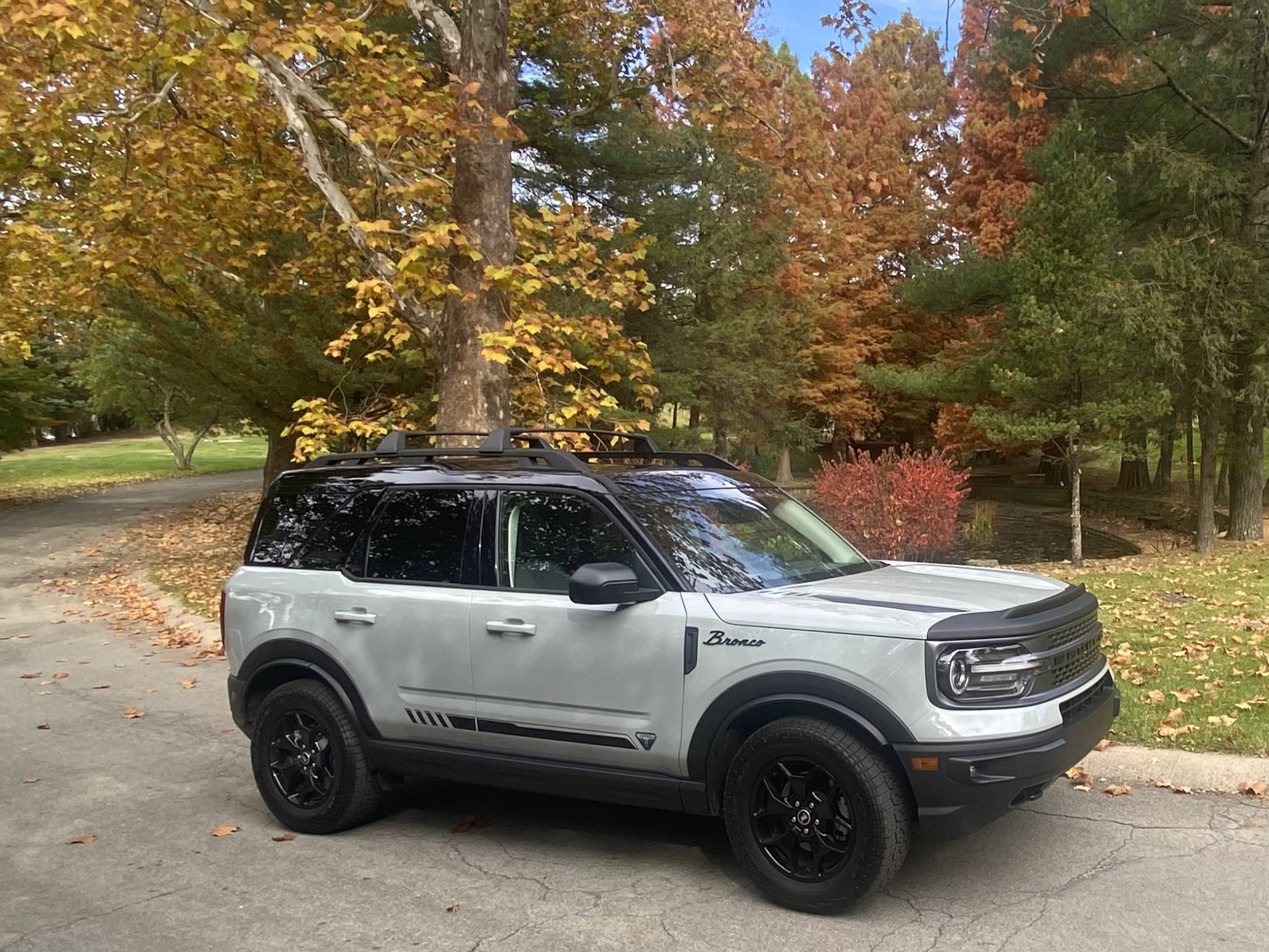

Ford Bronco Sport Big Tires for BS Badlands 35CC4B7D-AB39-4D3B-9D65-8BAA92C8CD17

Are those coopers with an add on lift or are they on a non lifted first edition ? I have. First edition, looking to get a 1 inch boost with a bigger tire , I am a mall crawler type guy . Your thoughts if you would . Thanks jim Pittsburgh
You can run 245/65/17 with or without a lift. The lift doesn’t really change anything with respect to tire size.

Yes thanks Eric , that’s more than likely what I will end up doing , just thought if he had a photo of side view for a look see . Of what they look like with the 235/70 /17 . No lift on mine , didn’t know if they would look out of place . That will be 1/4 inch from the liners getting maybe a little close , what say you ?
I would say that is pretty close to the limit, but I think he is quoting tire spec size, not a measurement. When I look at www.tiresize.com for the 235/70/17 it reports a 30” size though. Since we know the tire rub happens when the wheel is turned, the 10mm reduction in width will probably offset the extra 1/2” in tire diameter over what we know as the limit with a 245 width at 29.5”. I’m betting that is a very good option and I do believe it has been reported here before. The 235 width is also a better pick for snow or mud, as it will cut in to soft stuff better.

Thanks for your ideas, spent some time at a brand new Discount Tire, the manager and his crew went all out and was learning as they were trying a few different tires , they definitely are right on with your pick , so when I get back from Florida , I have a set of cooper 235/70/17 to try out on my bronco . I will follow up down the road with a report on how they are . How is your project on your rebadge front end coming along. Thanks again .
