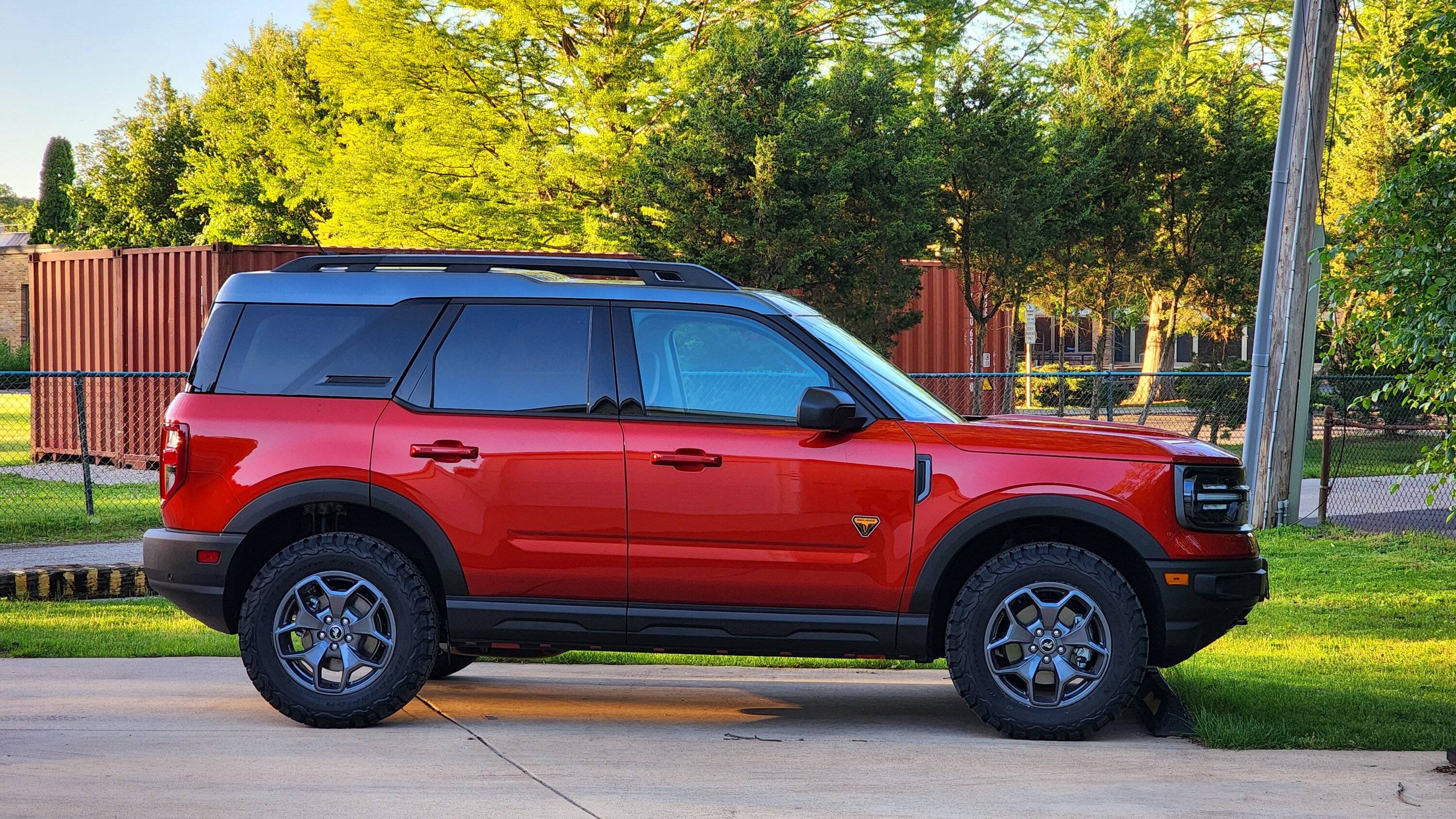

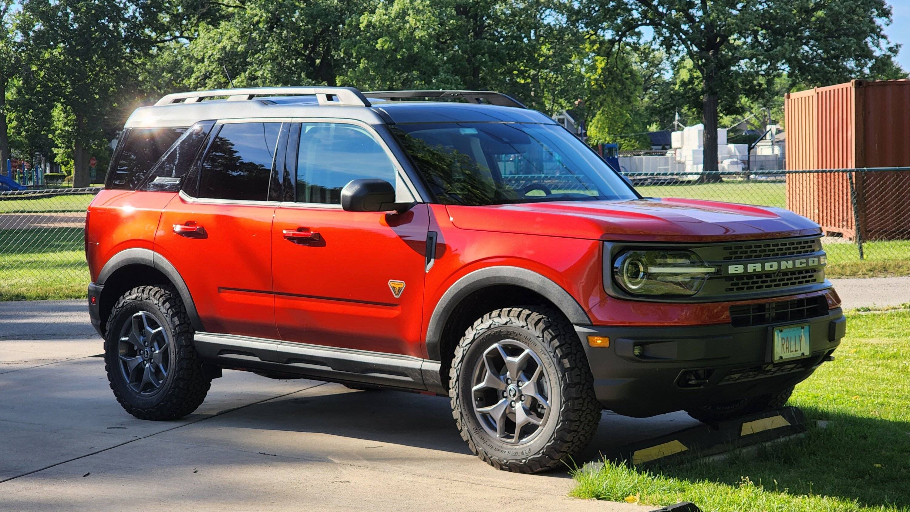

245/65/17 BFG K02s, no lift. The K02s are definitely louder than the stock Pirelli Scorpions that came on it. But it's a trade off for them being better in every other way. I don't know about the mpg hit because I traded out the tires before my first fill-up. Acceleration seems to be the same. Still feels fast.

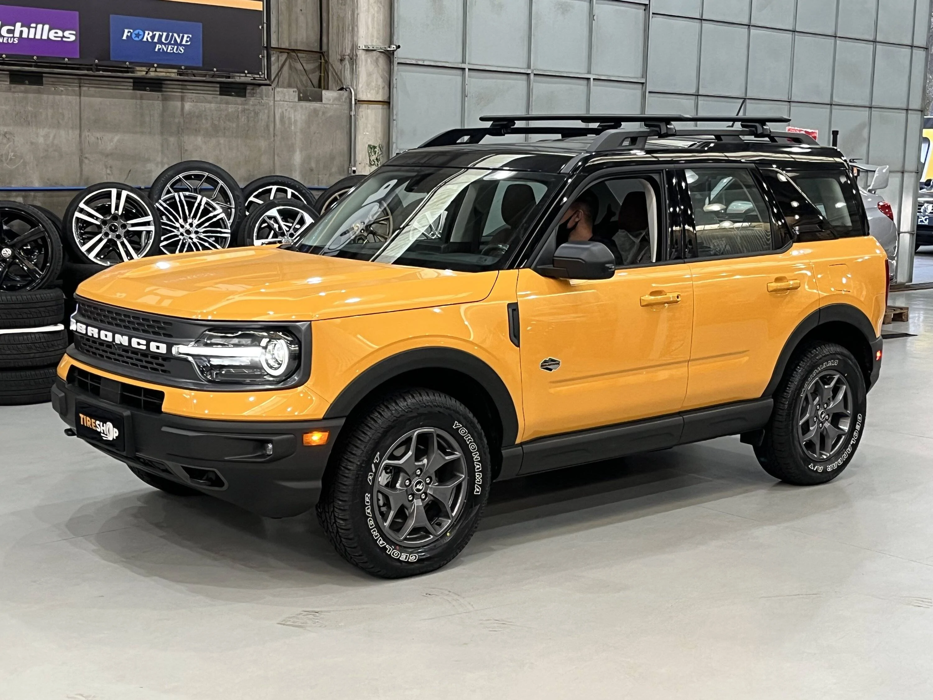

Yokohamas Geolandar G015 are a great alternative for a Bronco Sport. They are quieter than OEM Pirrelis, better on and off road, much lighter than ko2s and nice look also. Thats was my choice…
