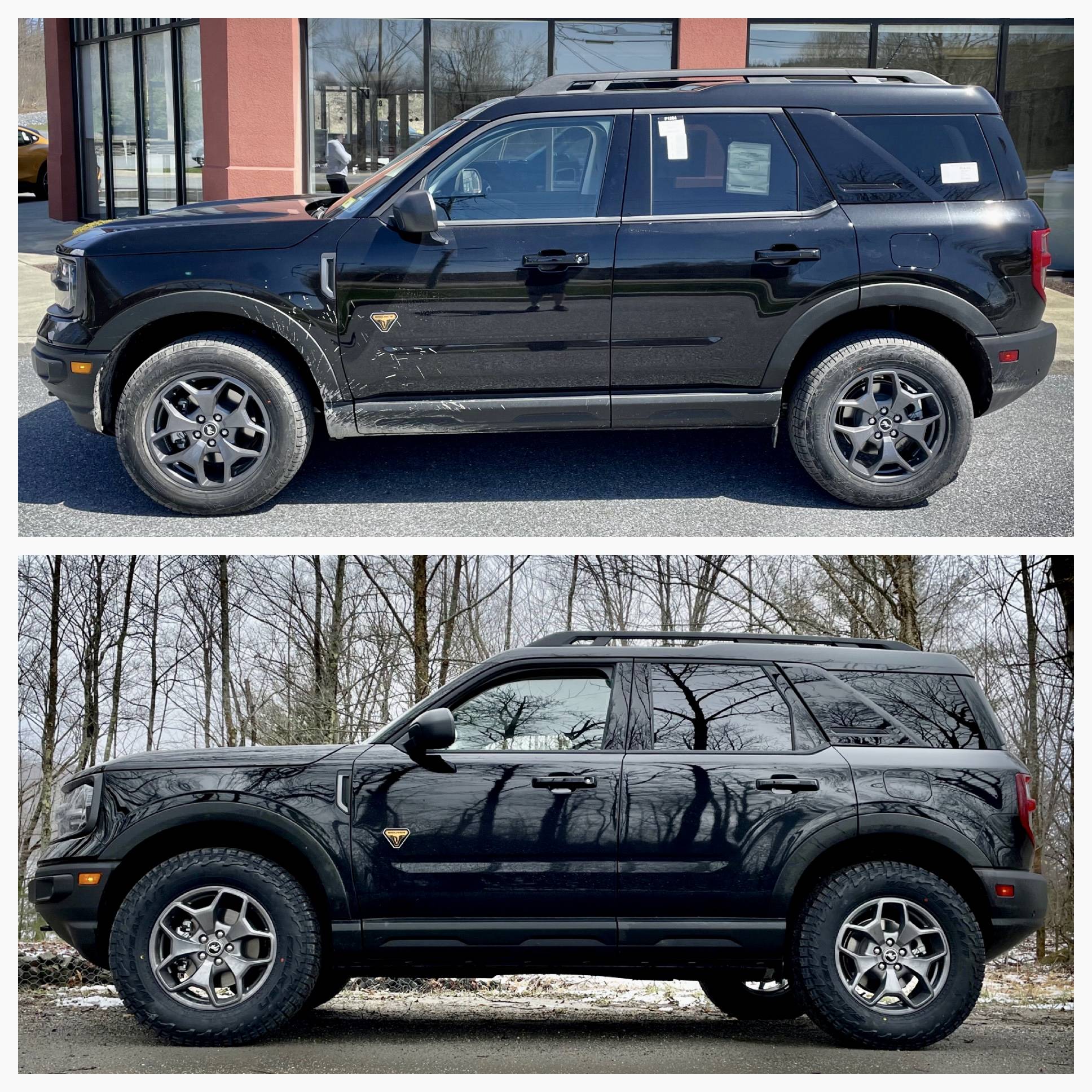

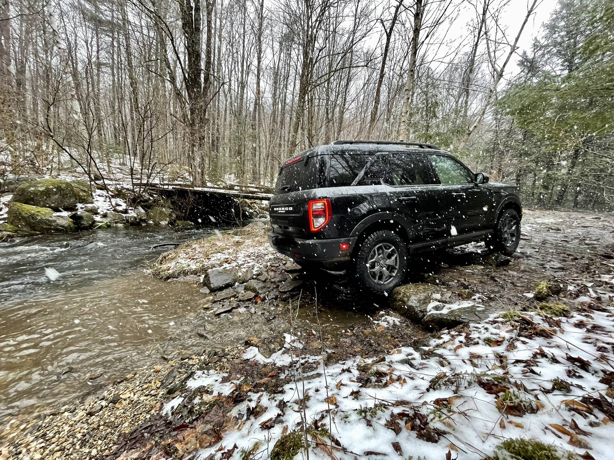

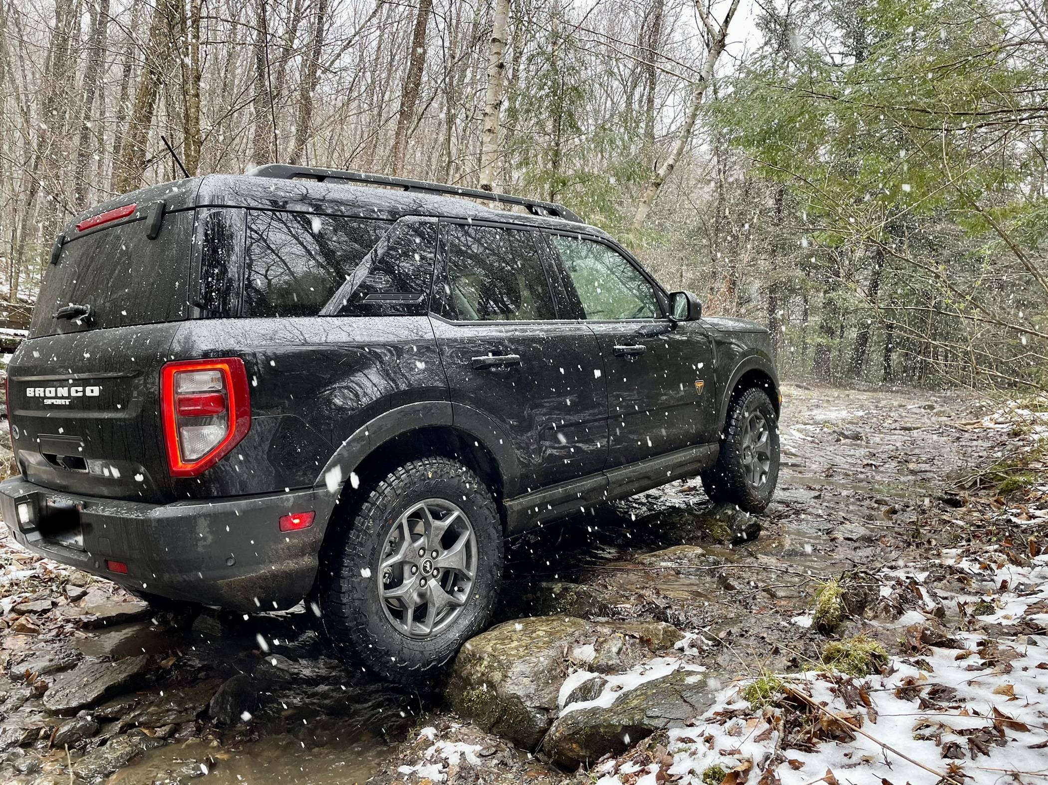

225/65/17 is stockers in top photo and wildpeaks 245/70/17 xl in bottom photo. The stock badlands factory tires lasted 236 miles before I pulled them. Ride is far better, not wallowing like a carriage with the soft ass oem tires. And looks like it should now. Yes it rubs between 3/4 and full lock a little bit on the wheel liner by the pinch weld. And no I don’t care. It’s an easy fix that I’ll address when my lift comes in and then can reassess what’s rubbing. Went wheeling with the falkens right after I put them on. They worked out really well.
