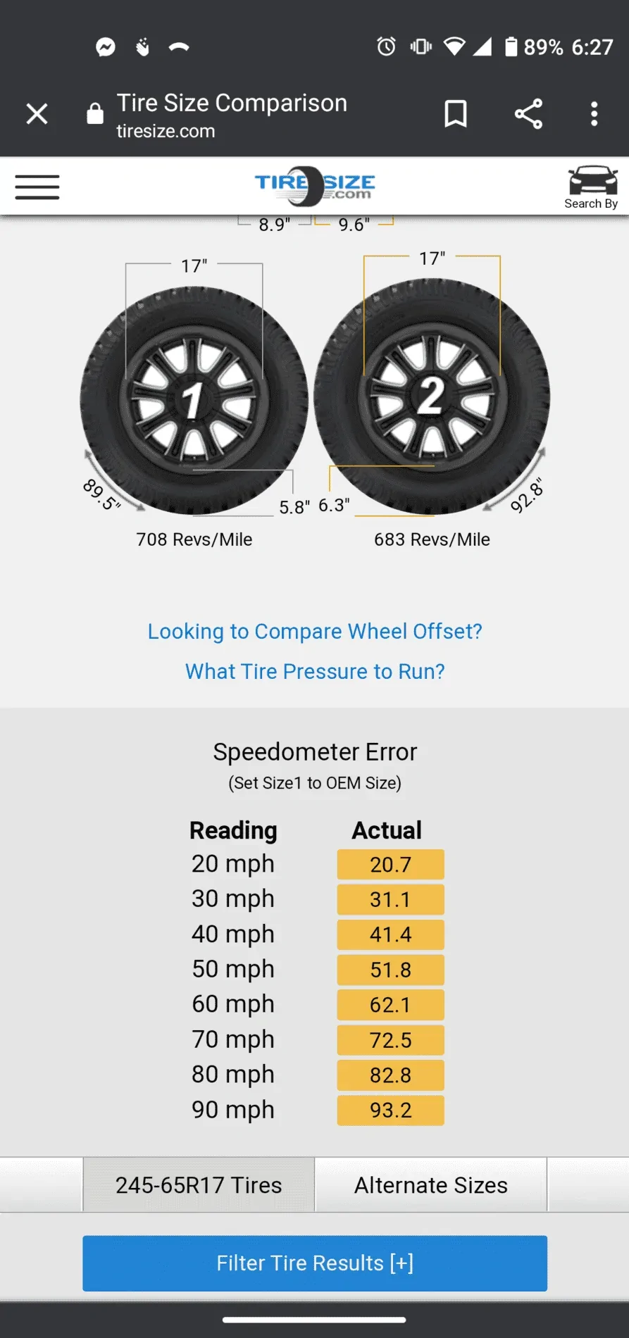

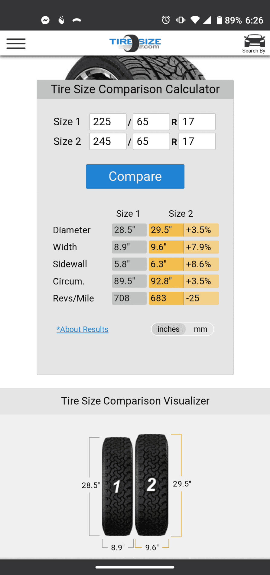

Have you checked on your speedometer difference since your 245/65R17’s are 29.5” tall and the stock Continental 225/65R17’s are 28.5” tall?

@BamaBronco any idea on this? I’ve asked around to no avail. You are the authority on tires now ?
Use a GPS for speed. Here is the comparison of 225/65R17 vs 245/65R17. Notice the calculated speed difference
I have used a GPS app as well as checked my speedo against a digital speed signal in a school zone that tells you how fast you're going and whether or not to slow down. The GPS app on my phone appeared to be within 1-2 mph of my speedo (in most cases within 1 mph). As for the digital speed signal, it was almost dead on. So if I was showing 50 mph on my speedo, the signal would also reflect 50, sometimes 51. Long story short, this is acceptable to me and within the legal tolerance of speedometer accuracy according to US federal law:

Makes sense. I'm also worried about odometer readings too over time. If you hear of how of anyone recalibrating, be sure to tag me! haha

I guess those tolerances are acceptable to me as well. I do wonder how many more miles will be added to the ODO after a year, or two? But then I really do not put a lot of miles on a year across my vehicles but my BB is the daily driver. I really do like your 245’s on your ride. Probably will still not upgrade until fall. Oh yeah, nice info above in your screen prints.
That's a great question and to be honest, that's not something I had thought about yet. But since you asked, here's my two-cents on the way I understand it:
Comparing the stock 225/65R17 tires to new, larger 245/65R17 tires, there is a tire diameter variance of 3.59%. This means that the odometer will read less than the mileage that has actually been traveled by 3.59% if using the larger tires. So for example, say my BS reflects 90,000 miles on the odometer before I decide to sell it (which is about how long I drove my truck before selling then buying the BS; roughly 3.5 years). Using the same percentage (3.59%), with the larger tires I will have actually traveled 93,231 miles instead of 90,000.
Hopefully my math is right. I may be totally wrong but the way I described it is how I understand it. So for some, being 3,000+ miles off by the time they reach 90k miles may not be acceptable but for me it is. An extra ~3200 miles traveled by that point doesn't really affect the value of the vehicle, IMO. Now, does it affect the long-term wear-and-tear of the vehicle? To some degree, probably yes. However, it may not end up making that much of a difference over time. I will probably still look into a re-calibration at some point, especially if I get a suspension lift.
