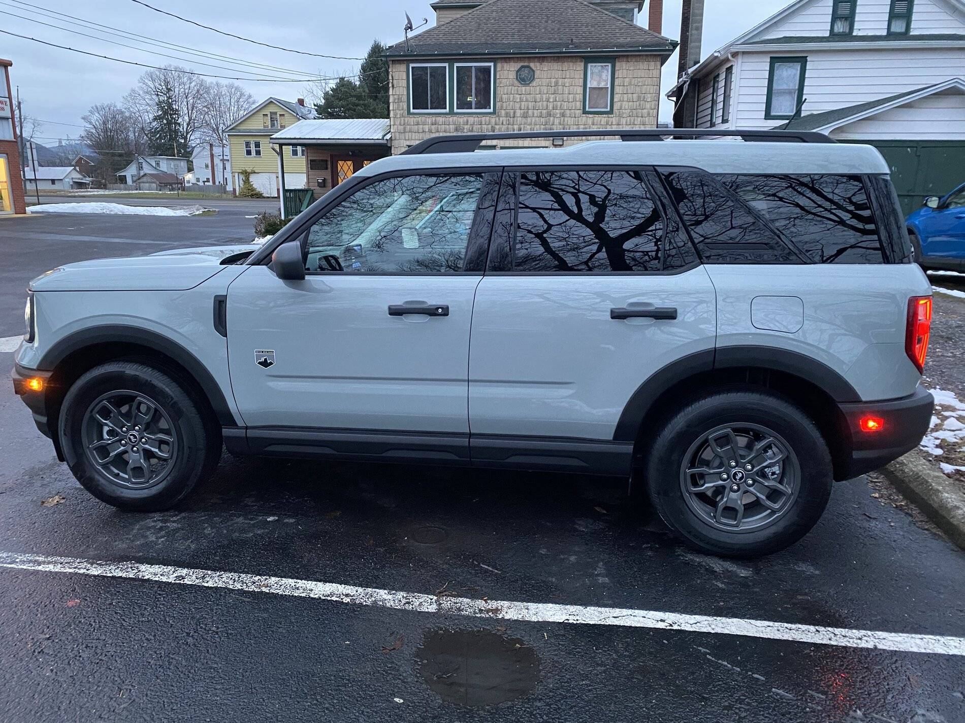

What’s up everyone! Just got a BS Big Bend edition today and was hoping someone can help me out on tire options. I’d like to get some all terrain tires that won’t rub. So please drop your knowledge! I appreciate it!

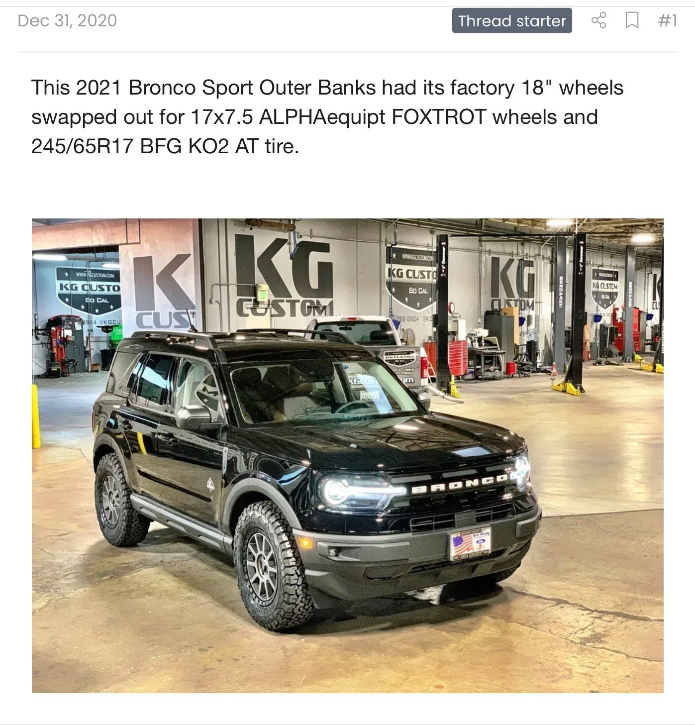

i was thinking the same, then I came across an IG post that someone put some 245/65R17 Falken wildpeak AT3Ws

So in theory, I should be able to mount 245/60/R18 on my stock big bend wheels in the future. Plus 0.1” width compared to the post. This makes me very happy.

Driving on a flat pavement looks to be fine. What about rubbing if you have 245's and some articulation over potholes, frozen and rutted roads, and such...will it rub under those conditions? Otherwise, I may just go to 235/65R17 and no bigger.
