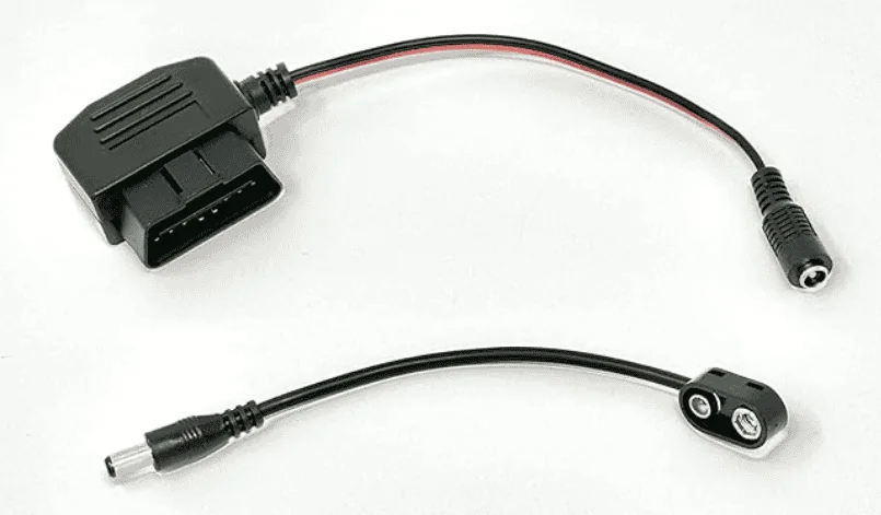

Some plug in a device to keep the electronics happy while replacing the battery
