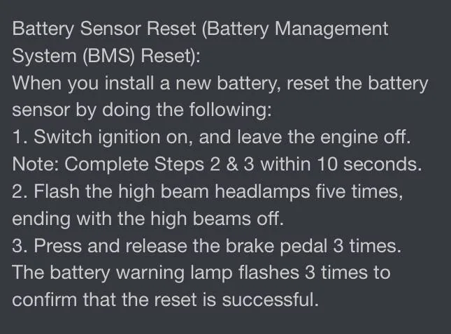

*PSA*——-——the dealership 3 year battery cost is $229 plus $70 for installation. They try to sell the install by saying they have to update software. They are actually simply resetting the BMS. If you have to install your own battery you can reset the BMS using the instructions below…
Ford Bronco Sport Battery recall battery replacement IMG_0219
I noticed on the paperwork they reset the PCM too. You will need FORScan to do that. I’ve done it in the past using ForScan Lite On my iPad.

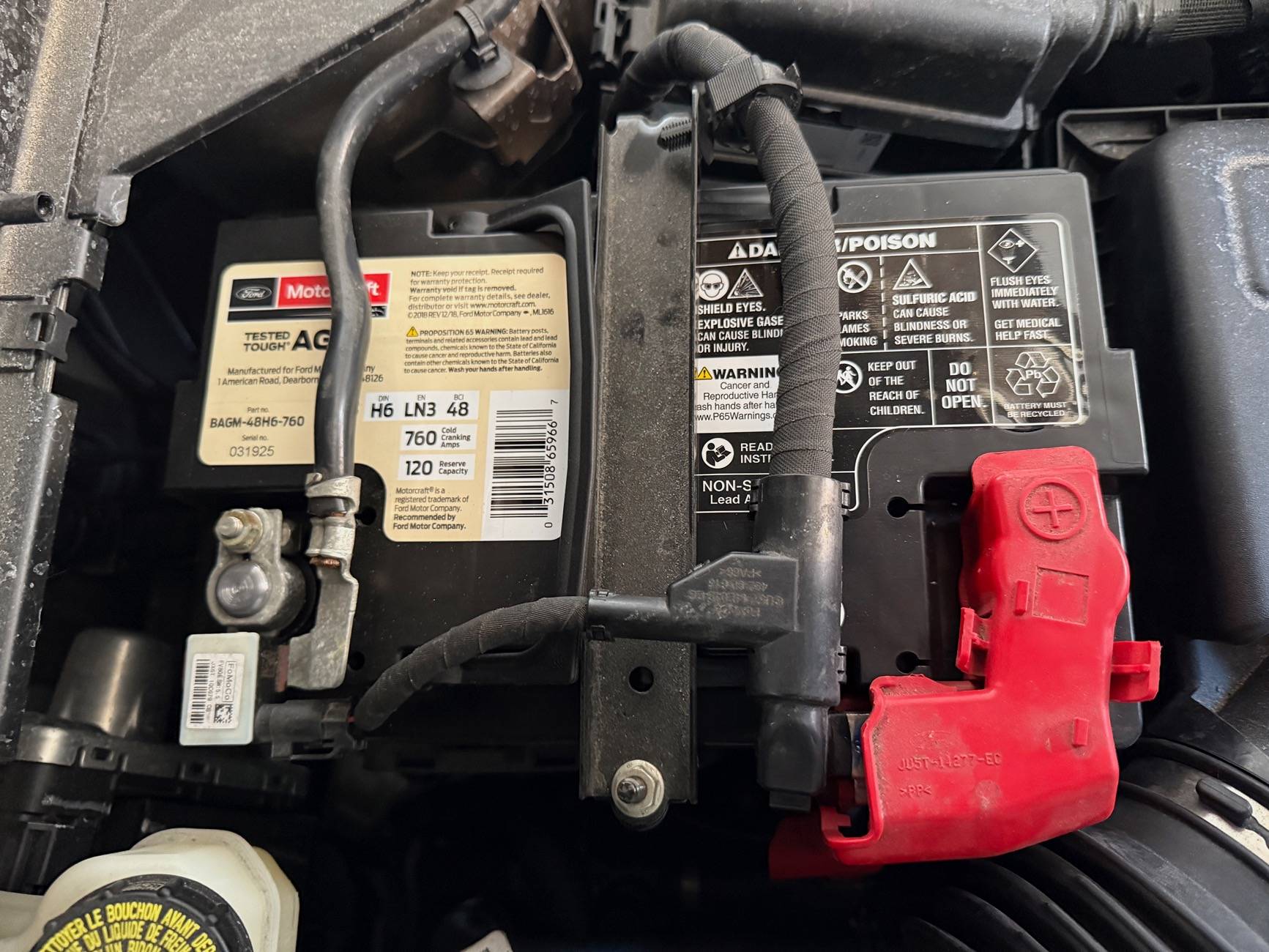

Bronco Sport safety recall involving battery and auto start/stop repaired at my condo by dealership. New battery and diagnostic performed to verify fix. Highly recommend this onsite service, technician and dealership coordinator was excellent ??

Excellent! Glad they honored the recall! Did you get an AGM battery? I use an ODB2 Start/Stop eliminator. I don’t like that feature at all….

Yes, new AGM battery and tech checked for any error codes, none observed. I’m interested in that start/stop eliminator, did some digging and ordered one (plug-n-play). Not a fan of the feature either.

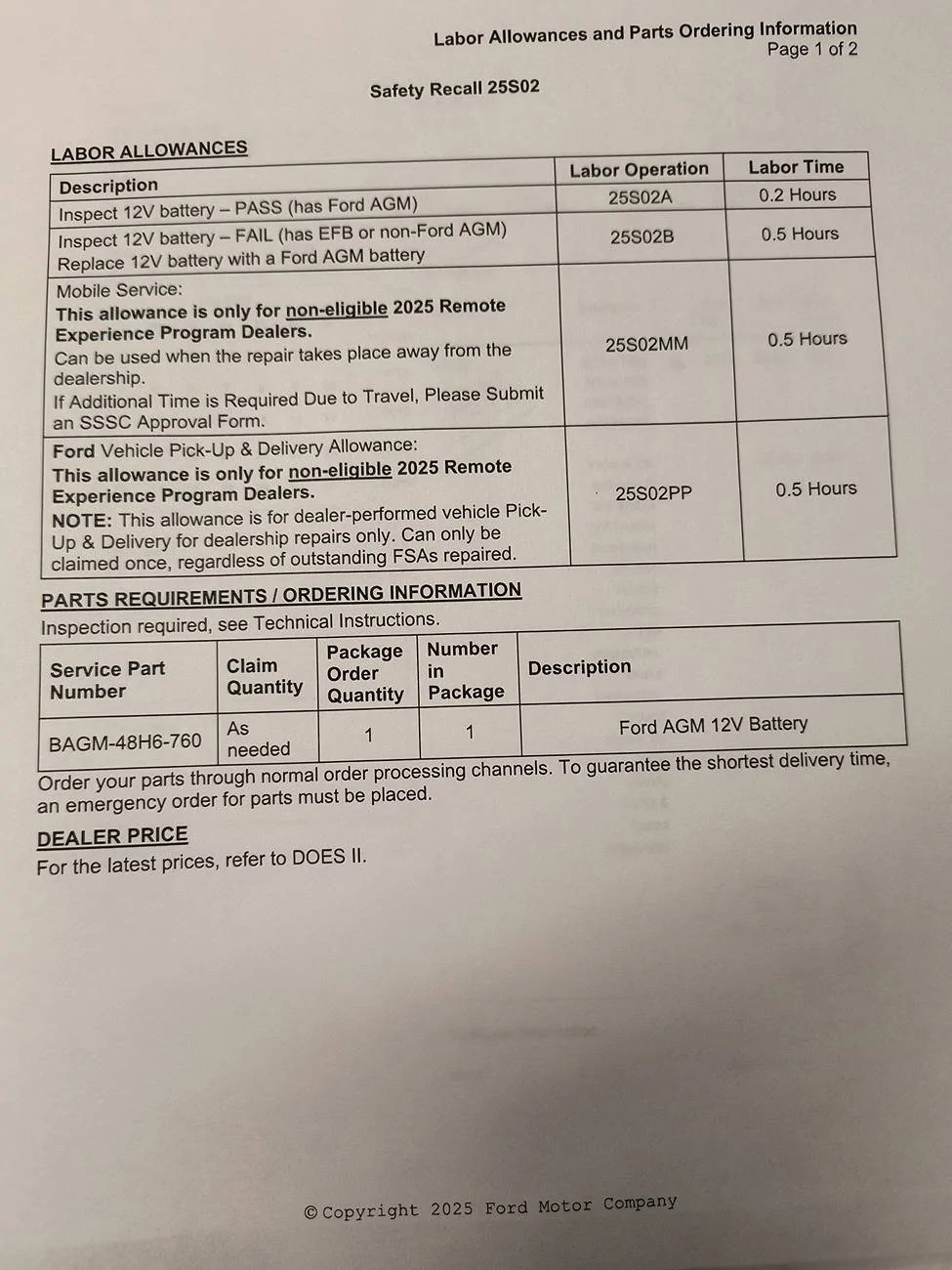

The recall instructions on this one direct dealerships to fail (i.e. recall) any Bronco Sport with a non-agm Ford battery or a non-Ford battery. In other words, if you had to replace the battery, Ford is accepting that the original equipment failed.
This was posted to the forum FB group
