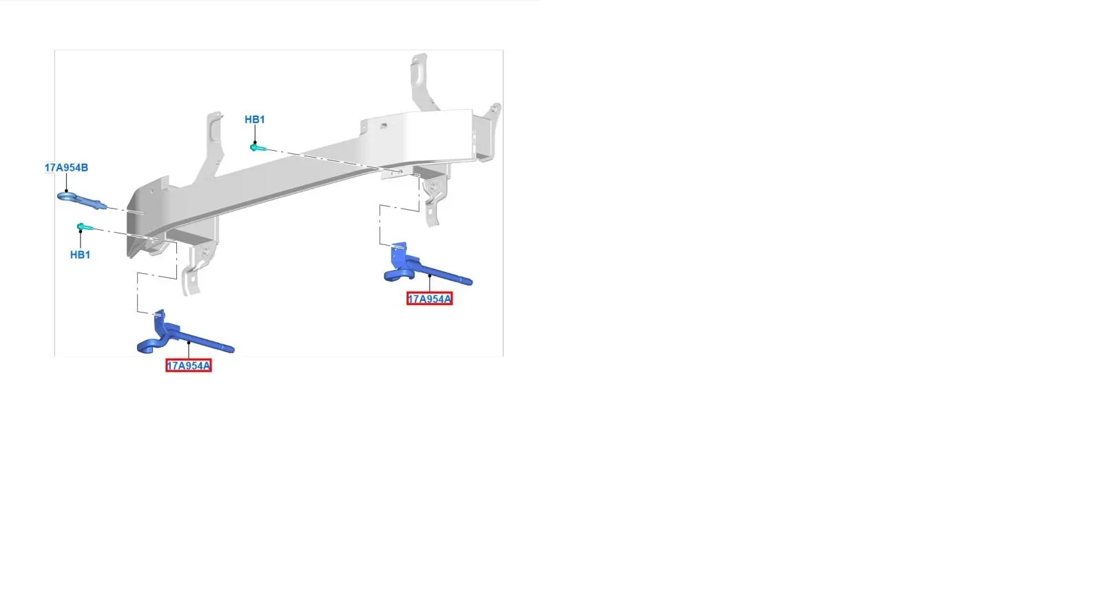

I work as parts person at the local Ford Dealer and had a customer come in to ask if this was possible. this is the catalog page for the tow hooks. Ford does not list a replacement procedure on their tech portal. from what I can see you should be able to remove the bumper cover and order the 2 hooks and 4 mounting bolts to outfit any Bronco with them. I will inform you if the customer approves us to do this and if it works or not.

This is 100% possible (and apologies for the delay if they have already okay'd) I did it to my OB, no problems with the cutout and install of the hooks and 4 bolts. The issue is the lack of rear bracket and nuts on any available parts site, internal or 3rd party, and without the rear bracket and nut to screw on the back of the hooks, the best you could tow is a plastic 4 wheeler, given the hooks will have almost no weight bearing capacity. I suspect we will have to wait until the tech portal shows more information, or the full parts and repair manual is available to customers directly, for an answer as to what these part numbers are.

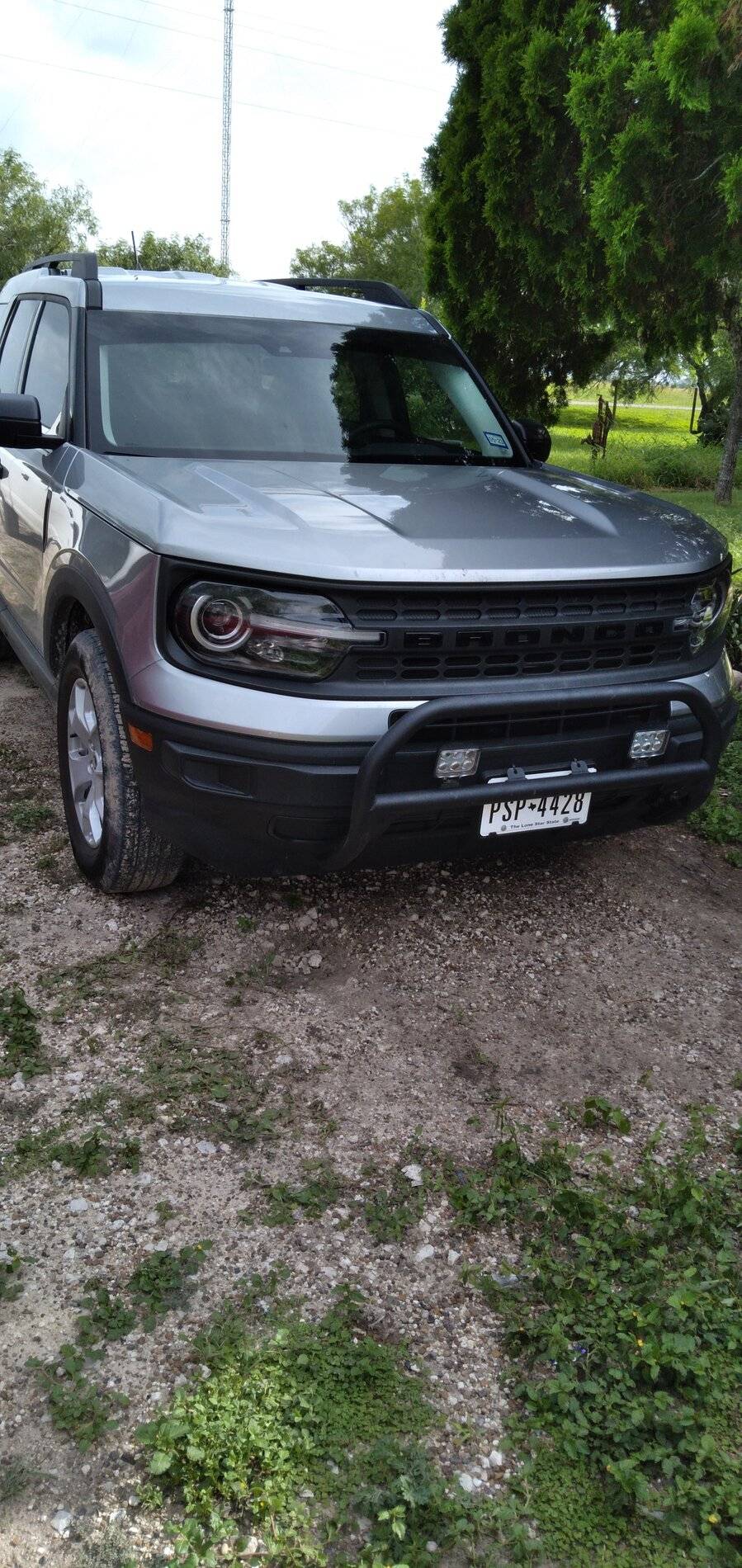

I was emailing them and they assured me that this thing only needs to be bolted to where the tow-hooks would be. There are tow-hooks built onto the bar and they seem to only be secured by the two bolts. I think he has a BL or FE Bronco Sport. That said, I don't know how sturdy it would be on a BB or OB. For looks, probably great, but if you really needed to be pulled out would they work?
I still prefer the look of tow-hooks though. Have you had any success with finding a way to support the rear of the tow-hook parts? They look like to are inserted into something... is there no way to secure them except for the two bolts in the front?
Rough County has their Nudge Bar, which mounts to the lower frame and I think the two bolts where the tow-hooks would go. I really can't tell on any photos or videos. But I wonder if someone could fabricate something like that to better secure the Ford tow-hooks? Possibly incorporating the rear portion which seem to insert into air.

So a bump bar (used to push if necessary but not rigged to pull) would be pushing on the car, not pulling the weight of the entire vehicle. The (4) screws (2 each side) are part of the bumper assembly, however the bumper assembly on the BS is not part of the frame itself, rather it is an expendable crumple-able part. So those (4) screws used for the tow hooks and for aftermarket parts are really just a very beefy mounting screw attached to a not as beefy flange. In a pinch if its lose the car or try it, I'd try it, knowing I'm likely to damage the vehicle but that's better than a total loss... I am not an engineer but the gauge of the flange, the bolts, and where they're mounted to not seem structurally strong enough to tow from all the reading I have done.
As for the rear mounting, its been located by some BL owners for me in other threads. Unfortunately it is a structural part that is welded on to the frame further back at the rear of the hooks in the BL and FE trims but not anything lower trim. I have yet to get proper measurements to build/bend/weld up some mounts for myself, but that seems to be the only way to make the tow hooks structural unless Ford releases something.
Until I can make them structural I have the tow hooks on for looks, but no plans to tow with them for now.

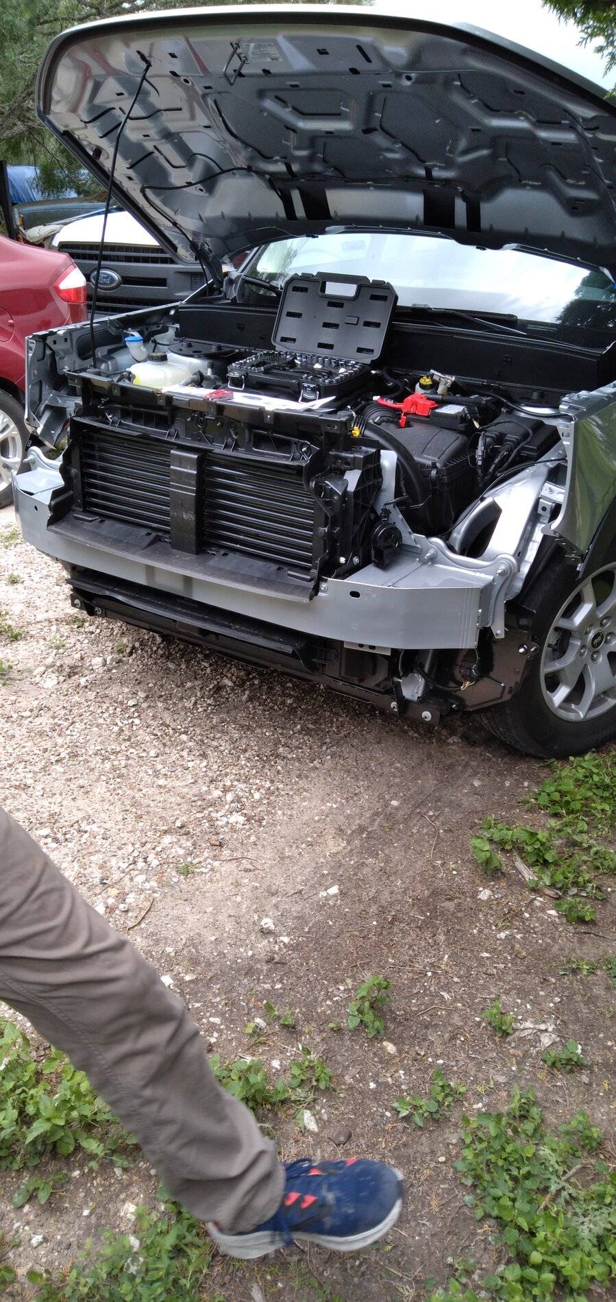

Has anyone with the base model, OB, or BB taken off the bumper and attempted to install tow hooks?
I've also been searching for an answer and haven't been able to find one. I guess I am going to have to wait until there is an aftermarket kit to confirm or spend all day taking the bumper off just to explore.

There are welded structural members on the Badlands that are missing on the other models. I don't believe the tow hooks can be used for vehicle recovery without those missing structural parts.
