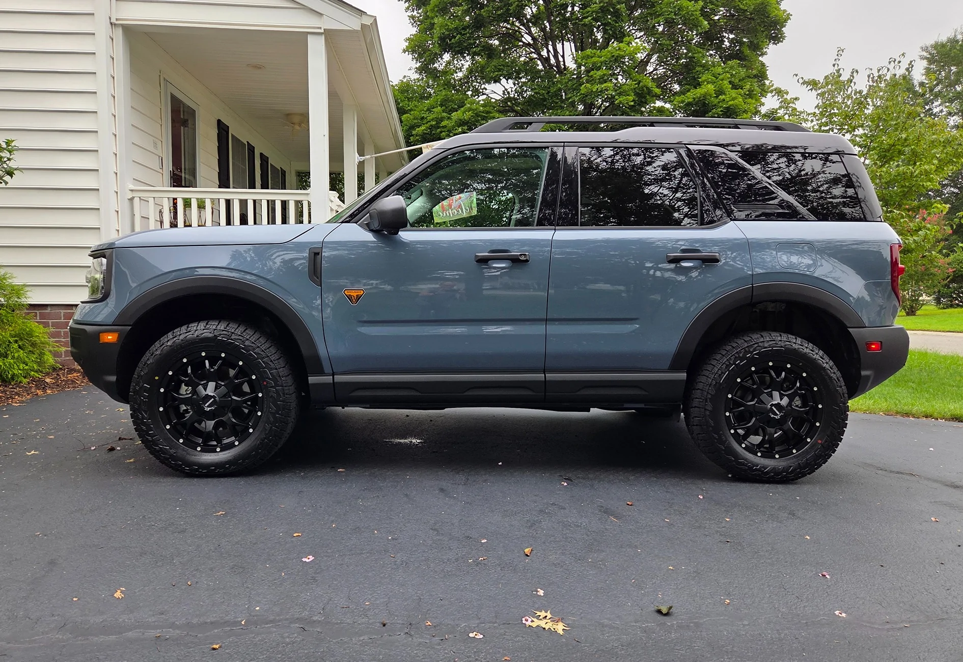

I will be getting my Badlands back from my installer later today. They started on the HRG lift yesterday and he made the same type of comments as your tech. "A very well thought out lift kit, the best quality parts that they have seen so far."
OEM tires 225/65R17, New tires after the lift 245/65R17
Fender to ground before and after
LF 31.75", 33.62" RF 31.75, 33.75"
LR 33.38", 34.62" RR 34.38", 35.62"

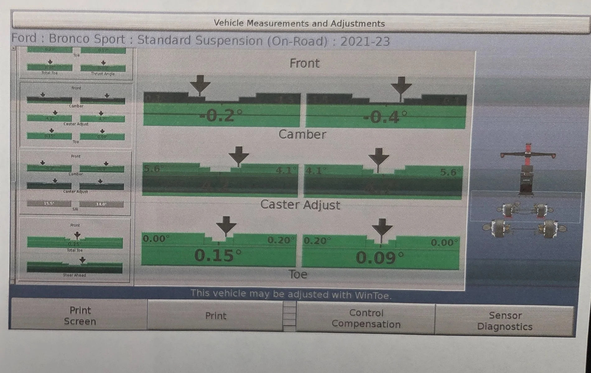

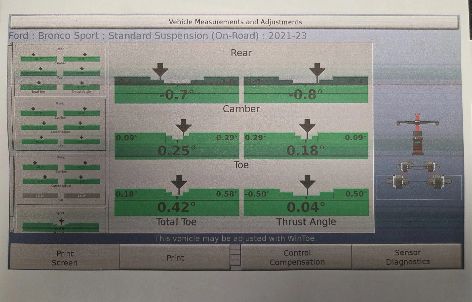

The tires are about 1/2" of the added height, part of the difference from side to side may be in part from my driveway. I gained 1.50" on the front and about 0.88" on the back. I was looking for the rear to be closer to level and maybe the lift needs to settle more in the back. The alignment went very well. The front tires are almost touching when turned full, not sure how peeps are getting larger tires without trimming. It would be great when posting lift results, before and after ground to fender measurements would be shared.
Ride quality really not that much different, if anything the new tires seem stiffer. Steering seems tighter, I like the changes. These are the Falken Wildpeak A/T4W tires.

Your new tires are XL load rated, which can make them stiffer but some other factors may also contribute to that, like wider wheels, which will increase the effective spring rate of the tire's sidewalls. You increased your tire width by 20mm, if you increased your wheel width by 1" (25.4mm), you efectively made your sidewalls stiffer but it may feel like it handles better.
Also, some tires just need a break period, before they are at ther best. No issues with my Baja Boss A/T's but my Nokian Outpost nAT's took about 1K miles to get smoother and quieter.
Lastly, you can take the tires out of the ride height equation by measuring from the wheel center to the fender lip, if you take before and after measurements there. If tires are not a factor, it's better to measure, on a flat surface fron the ground to a hard point, like you jack points. If a flat surface is not available, chalk your tire location, where you measured at and then turn the car 180* and measure again and take the average.

Hi, very good information. So the HRG lift kit doesn't increase ground clearance by 1.5 inches on its own? You achieved that 1.5 inch clearance because you also changed tires. So it seems the increased ground clearance isn't what HRG advertised, and neither was my 1.3 inch RTR lift kit.

HRG Badlands specific lift is advertised as only 1.25” as Badlands is already factory “lifted”

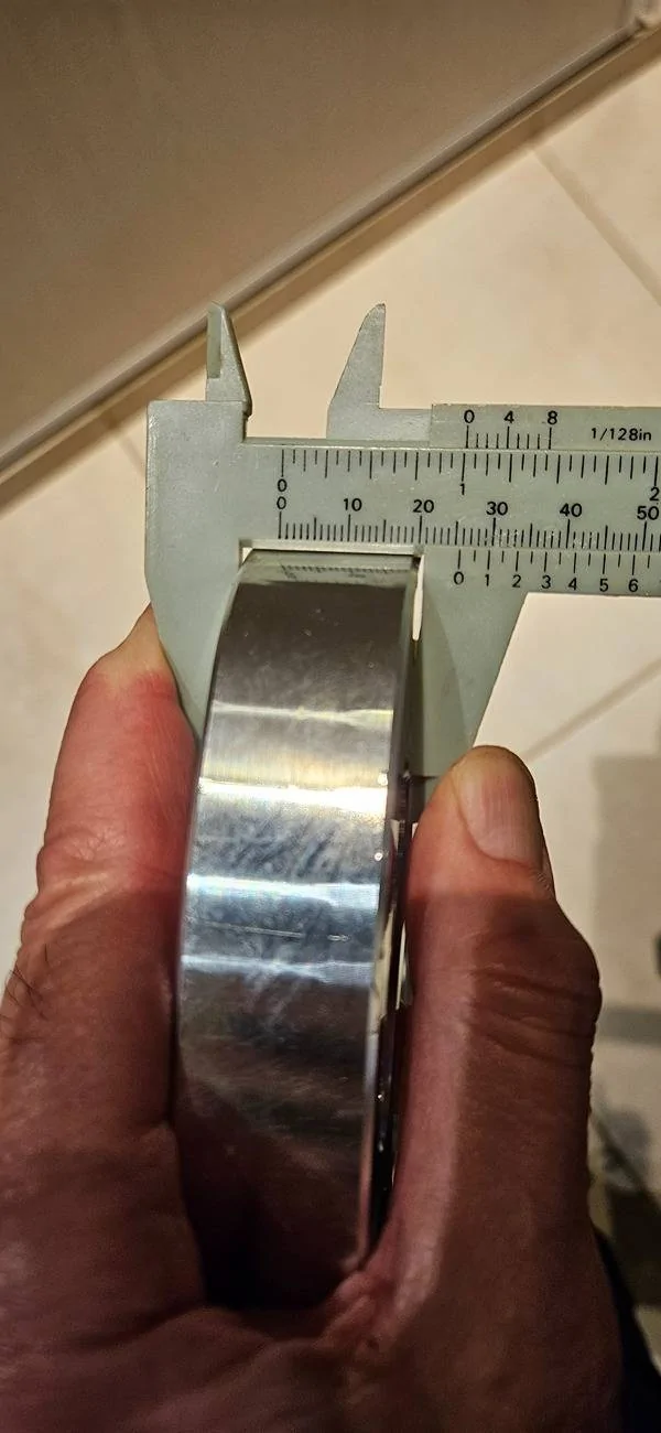

So after a few weeks of driving my 2025 Badlands with the 1.5" HRG lift kit I ended up with:
front 19.25" rear 21"
The rear makes sense as they provide a 1" spacers
The front doesn't to me, 0.75" of lift. Looks like I need the front half of their 2-1/2" lift to be more leveled out. That is, if it truly provides another 1" more lift. That would put my results at front 20.25" and rear 21" which is more inline with what I expected.
