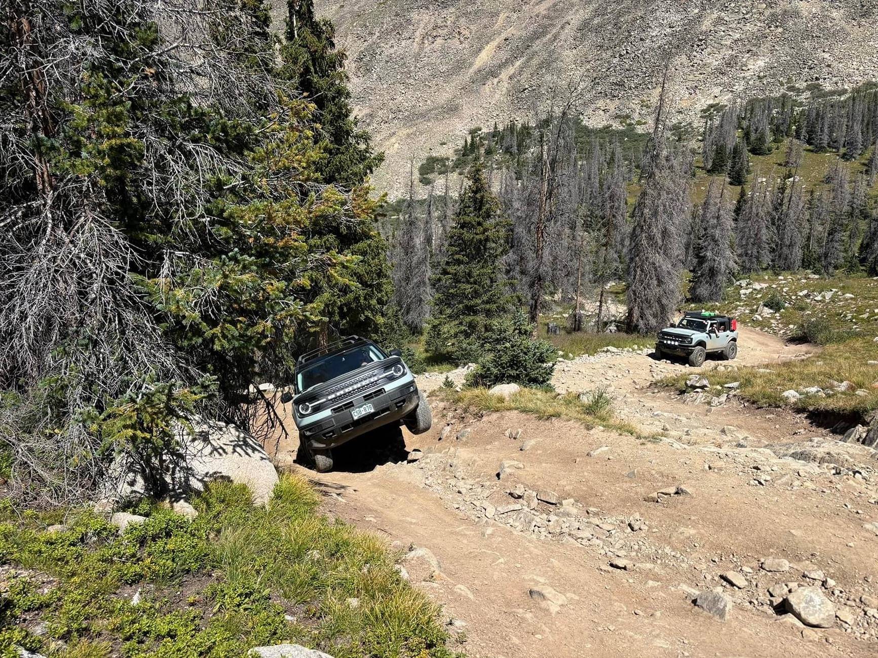

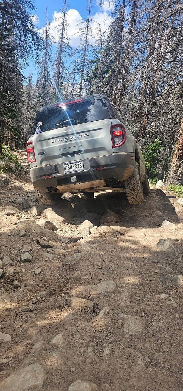

I installed the HRG 1.5” lift. I am still on my 235 65R 17 tires, but I’ll be getting new tires this winter… likely 245 65R 17. I also haven’t yet installed any additional skid plates - but I know I need that.
At first, I felt like my BSBL was top heavy after the installation of the lift. I don’t feel like that anymore. I haven’t noticed any reduction in gas mileage. It really feels the same. The extra clearance - while small - really does make a difference.
