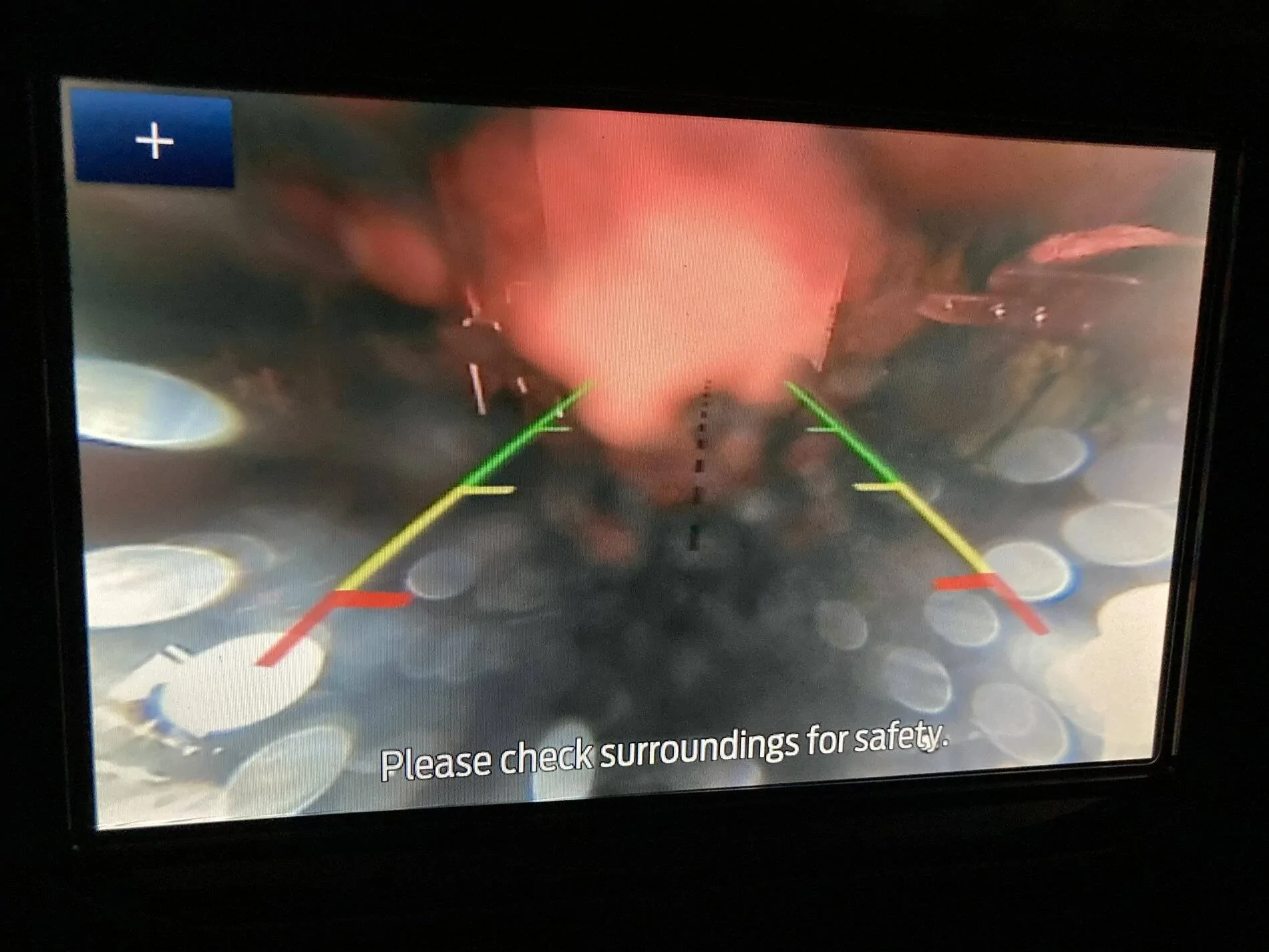

My view tonight lol
Ford Bronco Sport Back up camera glare from the plate lights 899DA019-AF22-4CEB-90ED-2964D765993A
TBH, that looks like fouling on the surface of lens itself, not just glare. Any chance you can get a close-up (cellphone?) photo of the camera's lens itself the next time you see that kind of view?
I'm assuming given your location (PA) and time of year that this is water + dirt not snow-slush + deicer.
