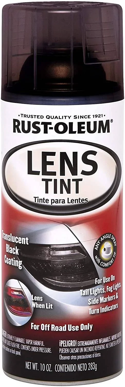

Nice actually never thought of that. Seems like a simple enough try.
thanks I’ll give it try
not overly simple, couple of points,
this product should be considered as permanent, go with light coats
watch the over spray, remove the lights for painting if possible
read as many Amazon reviews as you can stand for tips
