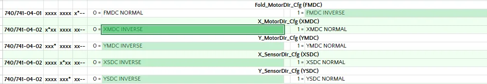

The only thing that's different is that when I adjust the mirrors, up is down and down is up! Something just needs to be changed!
Can you search for anything containing the word "MIRROR" in DDM AS BUILT section?

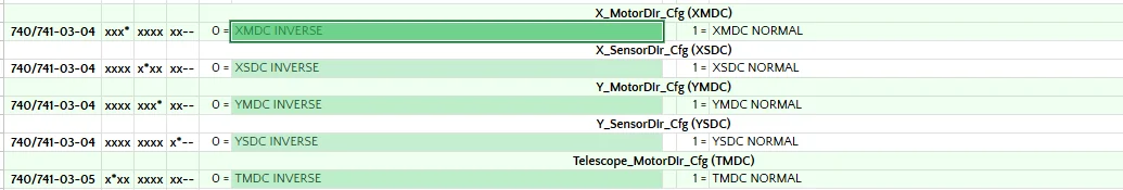

@pantera155 I think I found it. This is from an 24-26 F150 that is on the newer architecture like the 2025 BS is, so this should work. Let us know!
Ford Bronco Sport Automatic folding mirror project WORKED! 1775931186108-hn
Edit: I looked at the 2025 Maverick and it shows these feature configs in a different location. I would maybe try here first instead of what I posted above.
Ford Bronco Sport Automatic folding mirror project WORKED! 1775940937527-3g
Finally, thanks to your help, I entered line 740-04-02 as it comes from the factory and everything worked perfectly!:muscle: :muscle: :muscle:

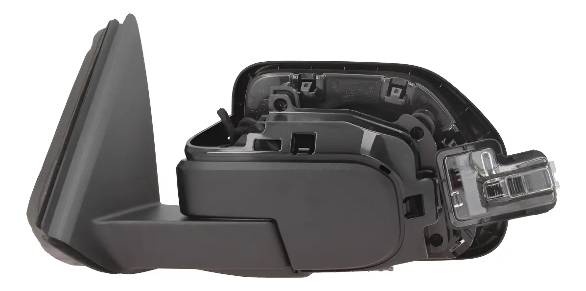

I have the .ABT file to upload with the final configuration without any errors, but the site won't let me!!
For those who want to do it, the hardest part is finding the folding mirrors.
I bought one used in Brazil and the other new in Argentina.
But you don't need to buy the whole mirror!
You need the mirror base, which is where the motor is located; the rest of the parts are from the one you already have.:muscle:
