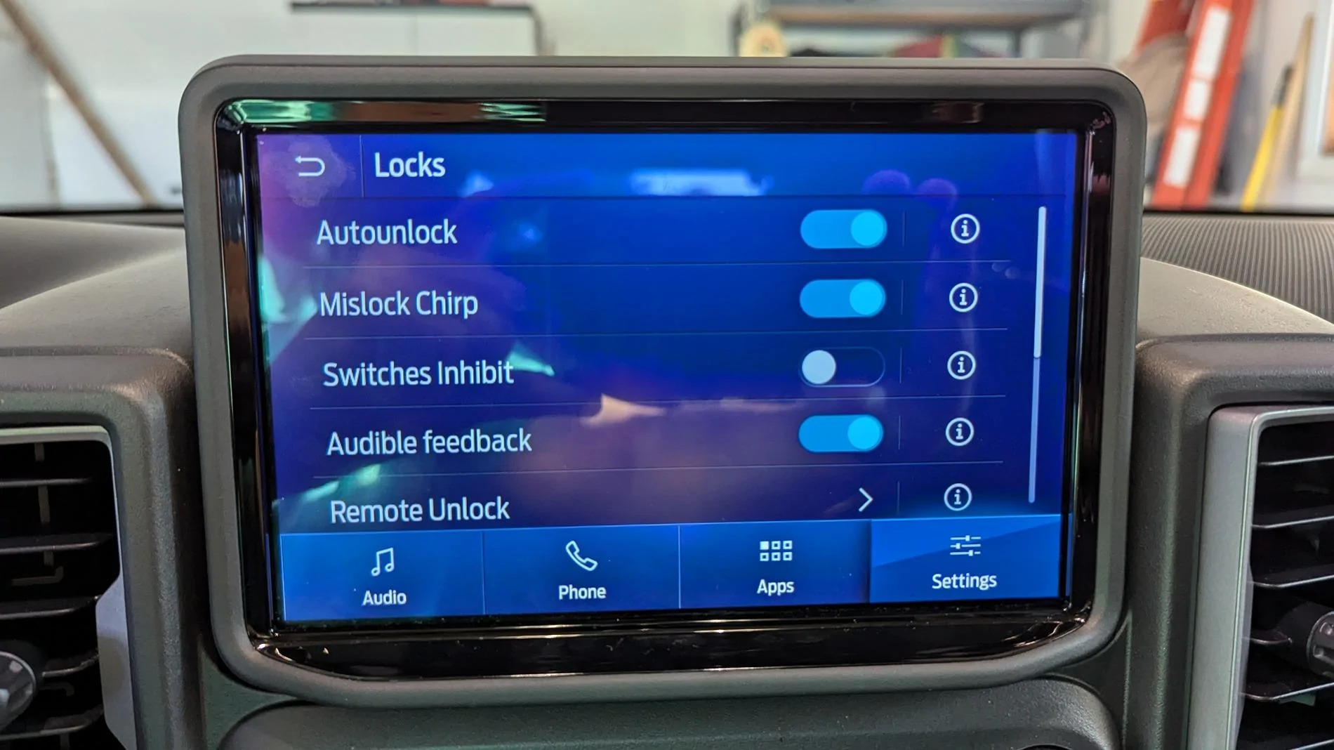

I can turn auto-unlock on/off in sync. I could figure out FORscan and do it myself if that can't be turned off at the dealership

Ahhh I re-read your post. I thought you saw a sync screen setting to disable Auto Lock but now I see you were referring to Sync settings for Auto Unlock.

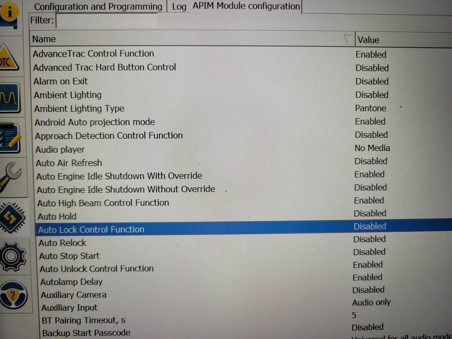

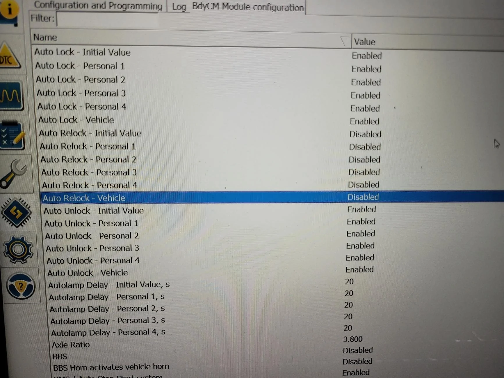

Options both on the body control module and APIM. this is how the options were set already. I need to drive and pay attention to how the auto lock reacts as it is then maybe go back and make changes. But it's definitely here.
