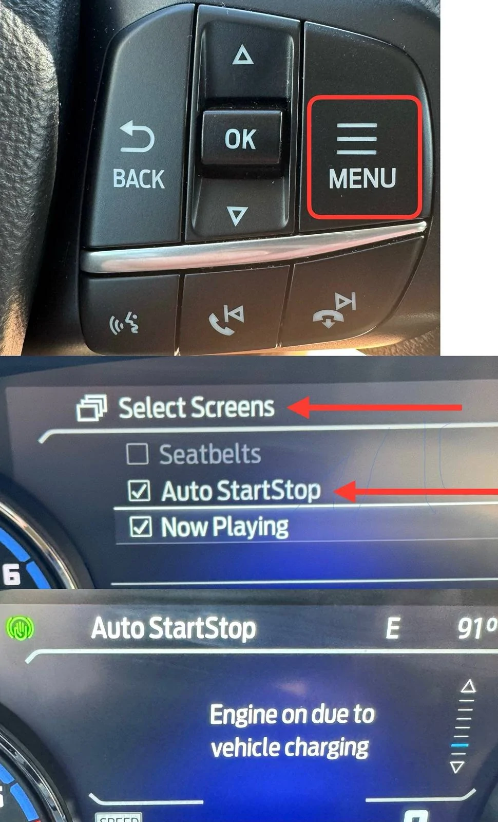

@Jude … you can see a message that might tell you the reason why the engine remains running for the case you described .. by following these instructions.
When it is safe to do so:
1. Press Menu button on steering wheel controls, right side.
2. Under Select Screens, make sure Auto StartStop is checked.
(There’s a max limit to number of selected choices so you might need to deselect something else if necessary).
3. Using the up or down arrows on the steering wheel controls, right side, get the Auto StartStop display shown in the center of the instrument cluster.
Mine is currently showing “Engine on due to vehicle charging” or will typically show the Vehicle on due to outside temperature quite a bit of time.
You can look to see what message your vehicle displays when you notice the engine remains running when you have Auto StartStop enabled per the case you described.

Thank you for this info. I will try it next time I use the Bronco. Several people suggest low battery being the problem. The Bronco sat after use for about 2days without the tender plugged in and the voltage reading was 12.45 so I don't think that is the problem.
