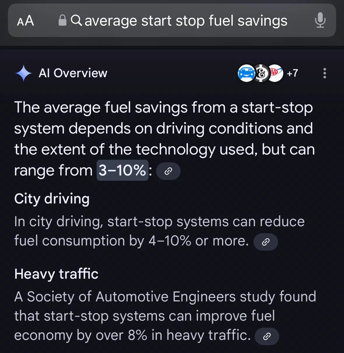

Great analysis V8 Yankee!!!
I’ve owned my ‘22 Badlands for 2.65 years and I average $1,951 in fuel cost per year.
There are many published reports of fuel savings of AS/S Systems including the one in the attached pic which shows a savings from 3% to 10% with use of AS/S.
3% fuel savings per year: $59 (3% * $1951)
10% fuel savings per year: $195 (10% * $1951)
Other statistics over that timeframe:
- Averaged 23.8 mpg (hand calculated)
- $4.438 avg. cost per gallon of premium gasoline
- Driven 27,683 miles
- Battery: OE EFB failed 07/29/2024 at 26,219 miles and replaced under warranty with AGM Battery
- I routinely used AS/S however I stopped using AS/S sometime around the Jan 2024 timeframe
