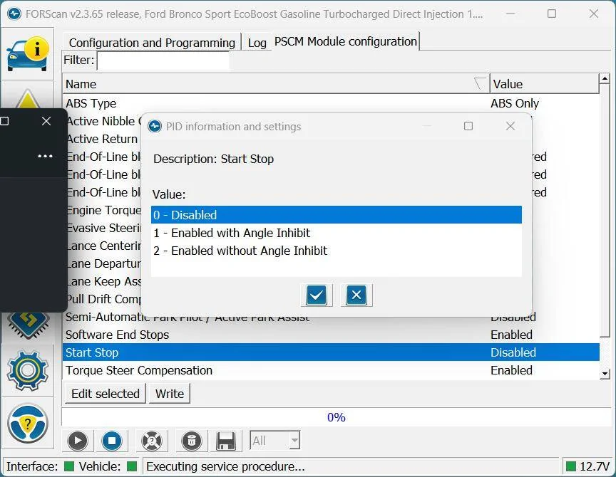

Forscan 2.3.65 has been updated to support '25 model year vehicles, including the BS.
I was able to permanently disable A.S.S. using Forscan. No errors or warnings on divers display.
Confirmed it is PSCM PID 730-03-01, but Forscan provides an easy to find text description and drop down. Took less than 5 minutes.
No expensive third party wiring solutions required, which may void your warranty.
Ford Bronco Sport Auto Start/Stop Technique PSCM ASS
FYI .. copied your info into the main Bronco (Sport) ForScan Thread

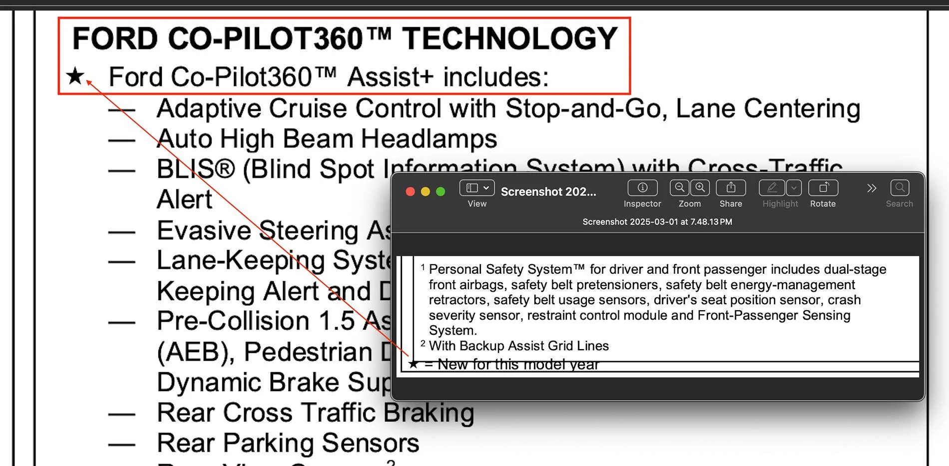

The biggest '25 BB differences I have been able to determine are:
  • New MPC engine
  • Digital cluster standard
  • Ford Co-Pilot360 standard
  • Sync 4A 13.2 inch display standard
Not sure if any of those drive Forscan differences.
