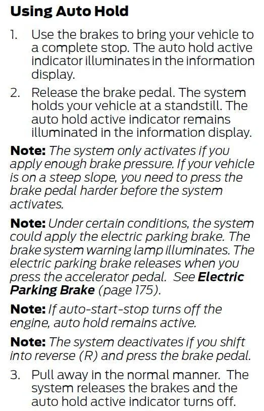

My '23 BB definitely does not restart after removing my foot from the brake. Seems to start after touching the accelerator pedal most times.

Do you have auto hold enabled in the main screen?
We don't, so that might be the difference.

Yes I do. Didn't think of that, hmm. Thanks for the tip.

The auto start/stop feature restarts the engine when the brakes release. It doesn't matter who is holding the brakes, you or the Auto Hold feature, the engine will not restart until the brakes release. If Auto Hold is holding your brakes the engine will not restart until you step on the accelerator, which releases Auto Hold, or another condition occurs that causes the Auto Start/Stop system to disengage. As mentioned in my original post, I found that one of those conditions is turning the steering wheel.
