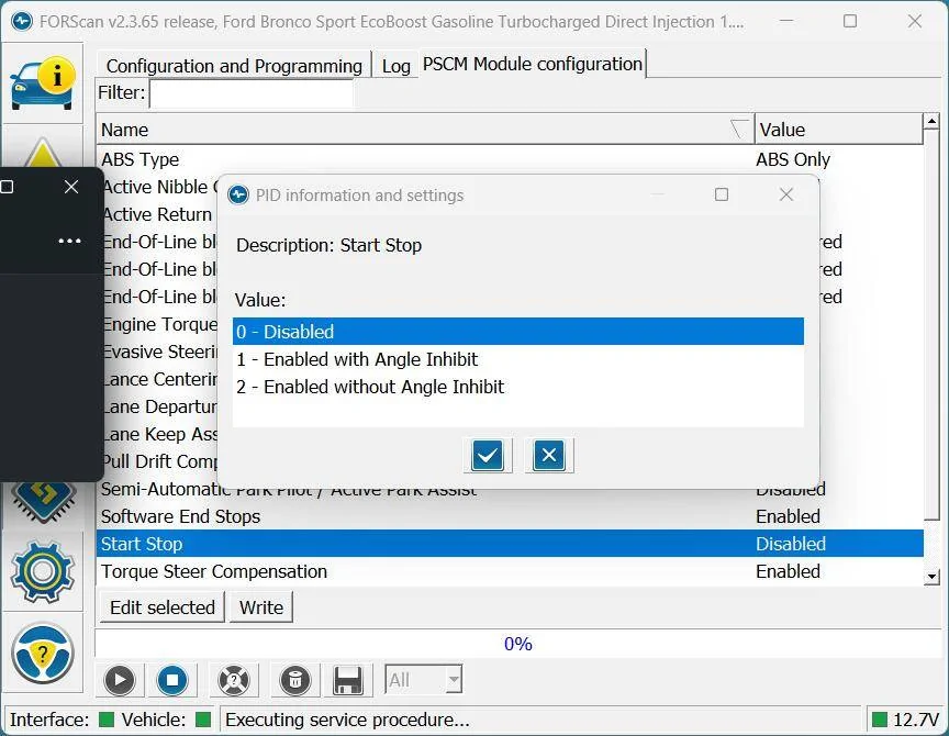

I tried to disable it in my Badlands with Forscan but it wouldn't work. Forscan said it was disabled but it would still do it. I tried several times. I finally gave up and decided I would just hit the ASS button. Which, in retrospect, I kind of always liked hitting the ass......button, that is.
Check in the bcm and pcm. I think it was in two spots I disabled it just fine.
On the '25, it's in the PSCM
PID: 730-03-01 - Start Stop
Value: 0 - Disabled
Ford Bronco Sport ASS - from X PSCM ASS

Thanks. I will do that today and check back.
I got it done by rewriting the values in the PCSM module : PSCM 730-03-01 xxxx xxxx 00-
Nothing else worked. Every value that I disabled in all the other modules did nothing but lie even though it showed them disabled.. I am so very grateful for this forum where I can find valuable info.

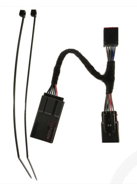

I was about to go buy the freaking little LED night light.
Anyways...now I'm going to write a blues number about Lying Modules.
The LED night light doesn’t work for all owners that tried it - you might just be adding it to your blues number
