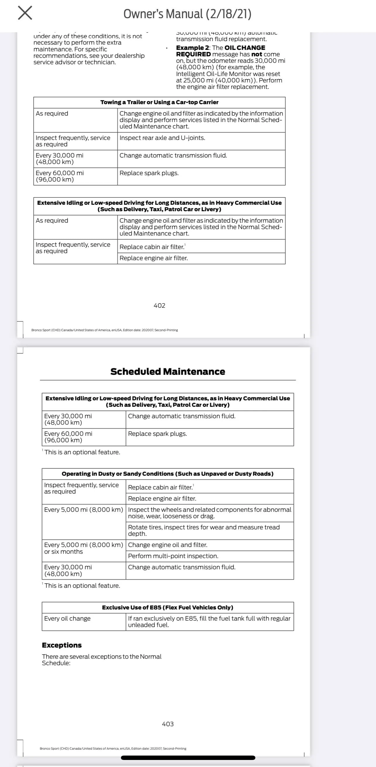

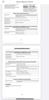

The owners manual specifically says if you tow, off-road, or have Long engine hours to change the transmission oil at 30,000 miles. I am going to watch my dealer do it and the PTU first and then I will do the next one.

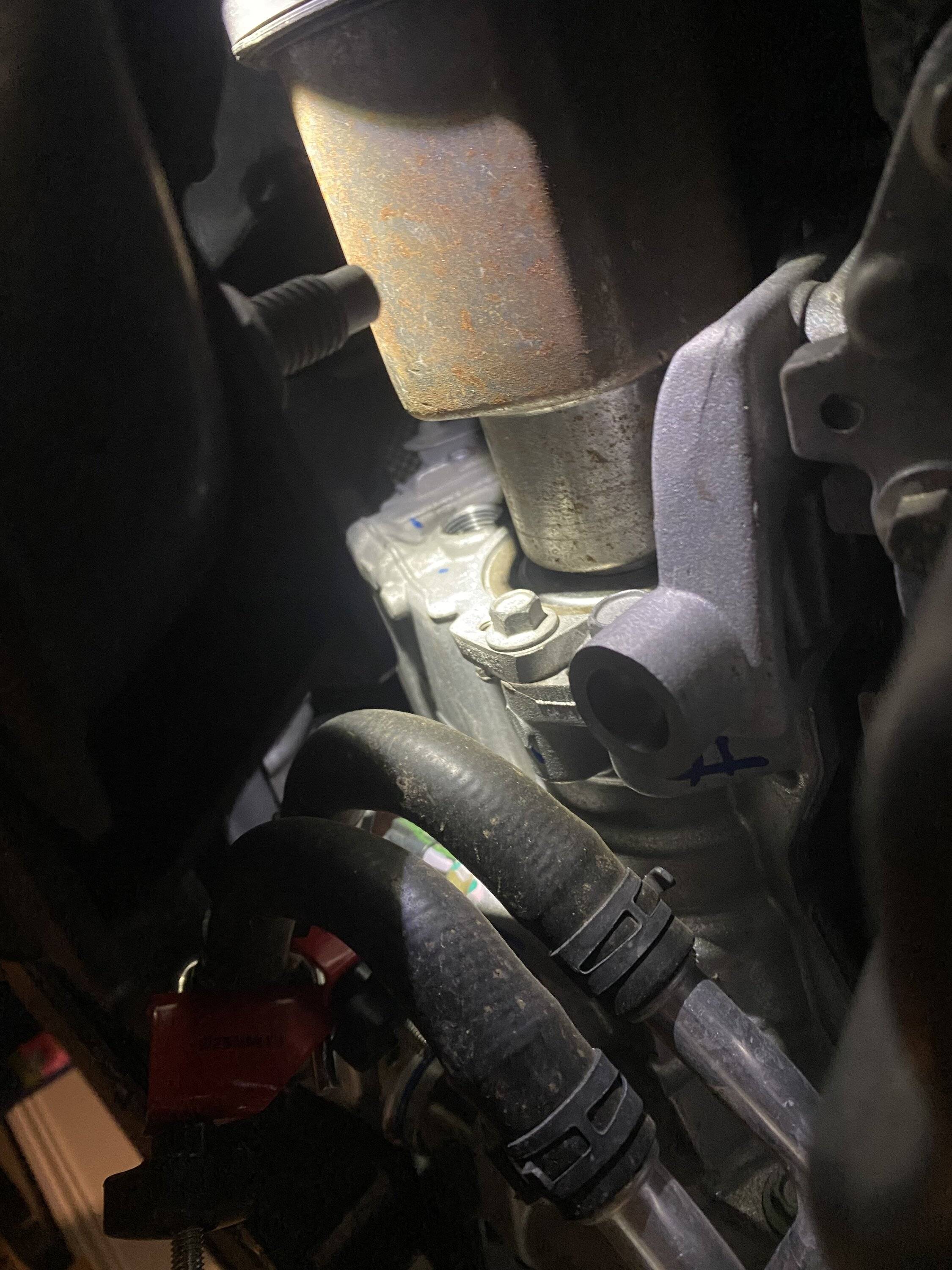

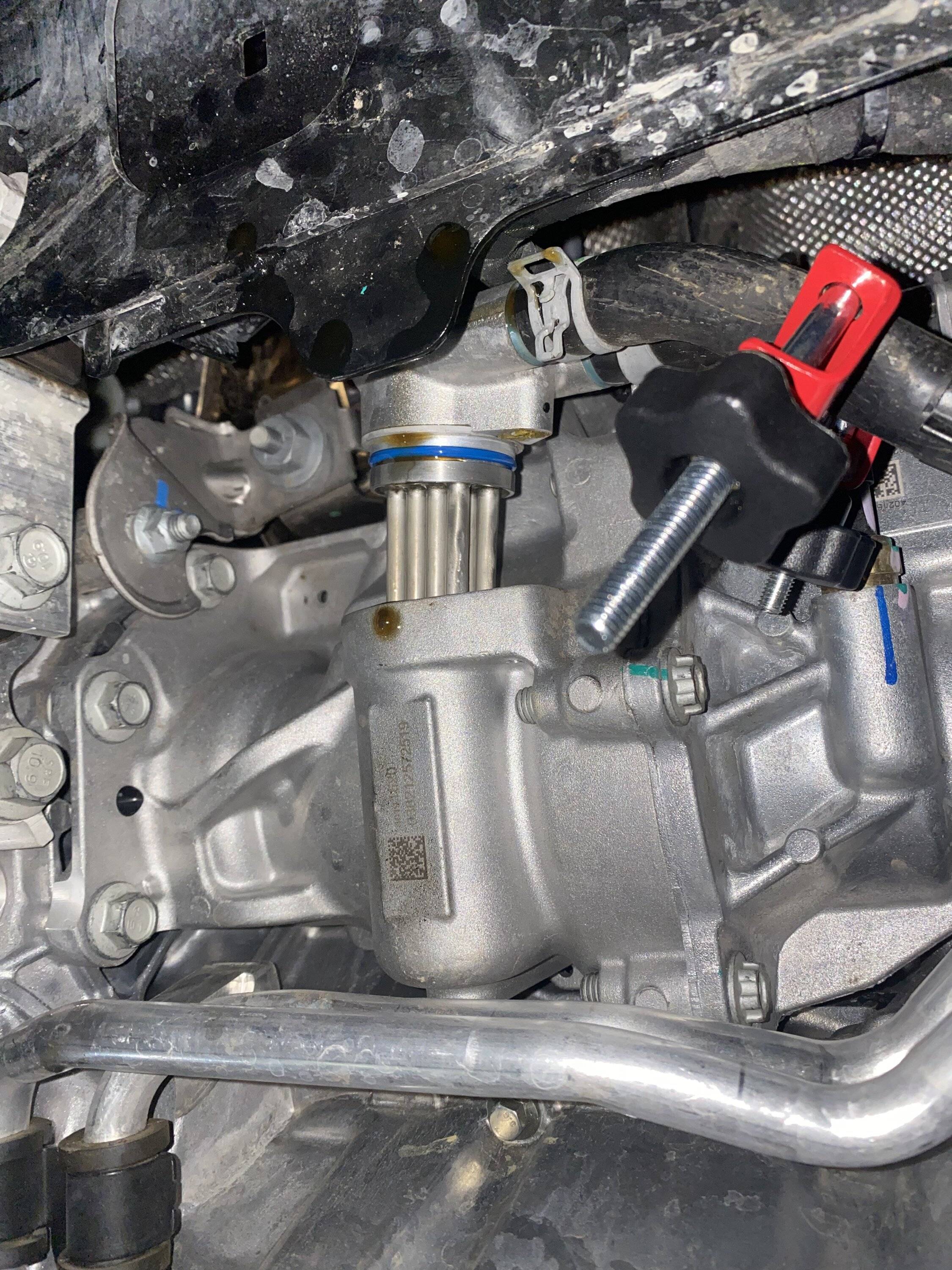

I was under my Badlands earlier today and could not find a fill or drain plug for the liquid cooled PTU. Anyone with a Badlands able to perform a fluid change on the PTU?

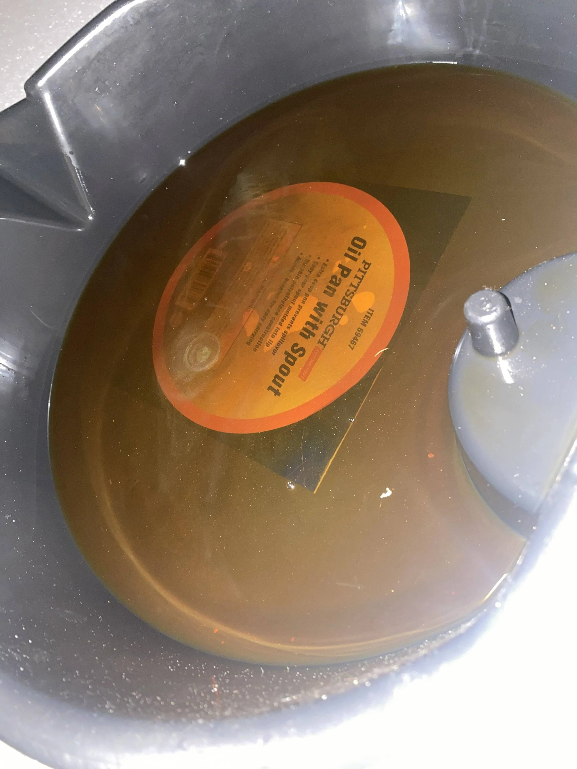

Hit 30K miles today and found time to change the PTU fluid. On the Badlands, you have to remove the PTU liquid cooler. There’s two bolts that connect the PTU cooler to the PTU. Once the bolts are removed, you can pull the PTU cooler out (have a drain pan ready, because the old PTU fluid will dump out). I clamped the two hoses that lead to the PTU cooler just in case, but I don’t think it’s necessary unless you remove the hoses. The fill plug is located on the passenger side of the PTU. It took about 3/4 quart of new fluid. ( Motorcraft SAE 75W-85 Premium Synthetic Hypoid Gear Lubricant).
The old fluid probably could have gone another 10-20k miles, as it was still liquid and not sludge. There were a ton of metallic shavings in the fluid though. Overall it took about 2 hours.
Hope this helps anyone with a Badlands, as most info online is for the air cooled PTU’s.
