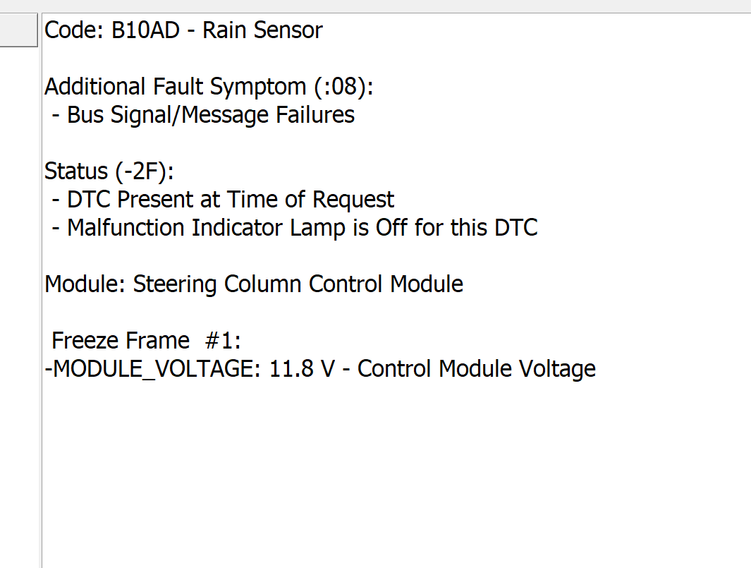

I'm having no luck with this... Everything is connected, 12V is reaching the sensor. The signal cable goes to the steering column... But it's not working and it's giving me this error.
I also configured it in Forscan
Ford Bronco Sport Add Auto-wipers? image_2026-01-14_15-33-58
Edit:
After a lot of work, the conclusion is that the 2025 model uses a different rain sensor... I tested two sensors and both gave similar errors...

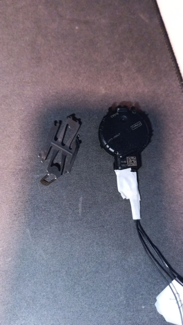

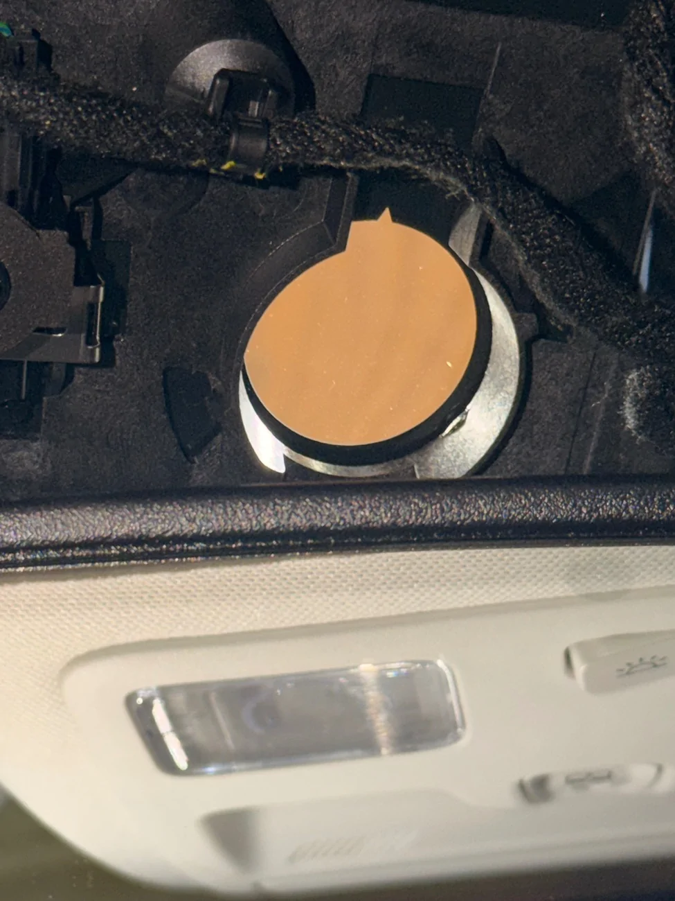

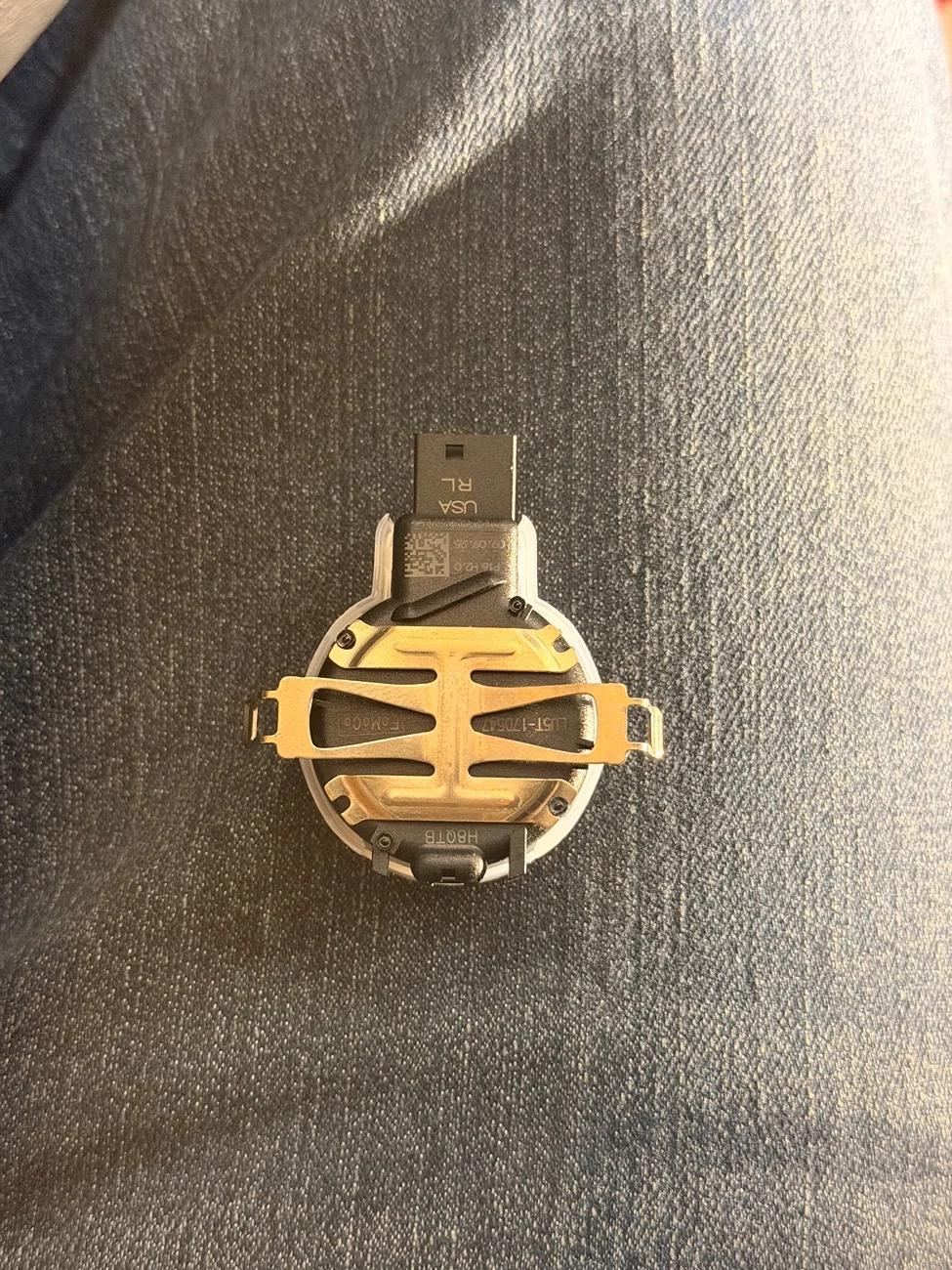

It appears that the sensor you linked me to is the wrong one. Its hold down clips are straight across, whereas, ours are on slight angles. I sure hope the dealer will let me return this one. 😔
I believe, the correct part number we need is:
LU5Z-17D547-B
You had linked me to: LU5Z-17D547-A
LU5Z-17D547-B
Ford Bronco Sport Add Auto-wipers? IMG_3972
Ford Bronco Sport Add Auto-wipers? IMG_3971
The correct part number is LU5Z-17D547-A.
The clips are loose!
Take it out and put it back in crooked. :muscle: :muscle: :muscle: :muscle:
