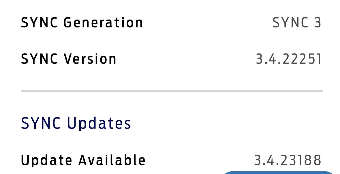

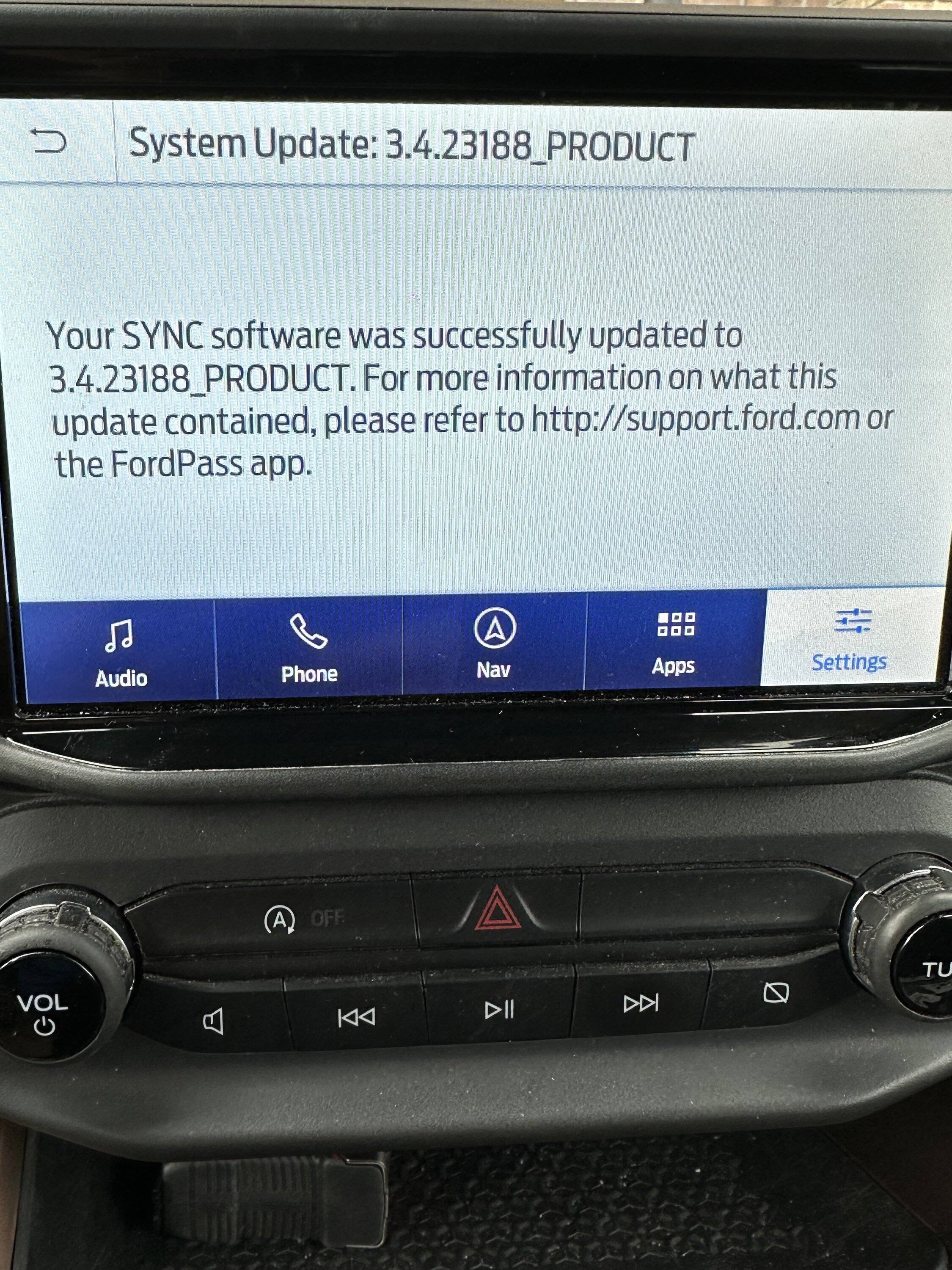

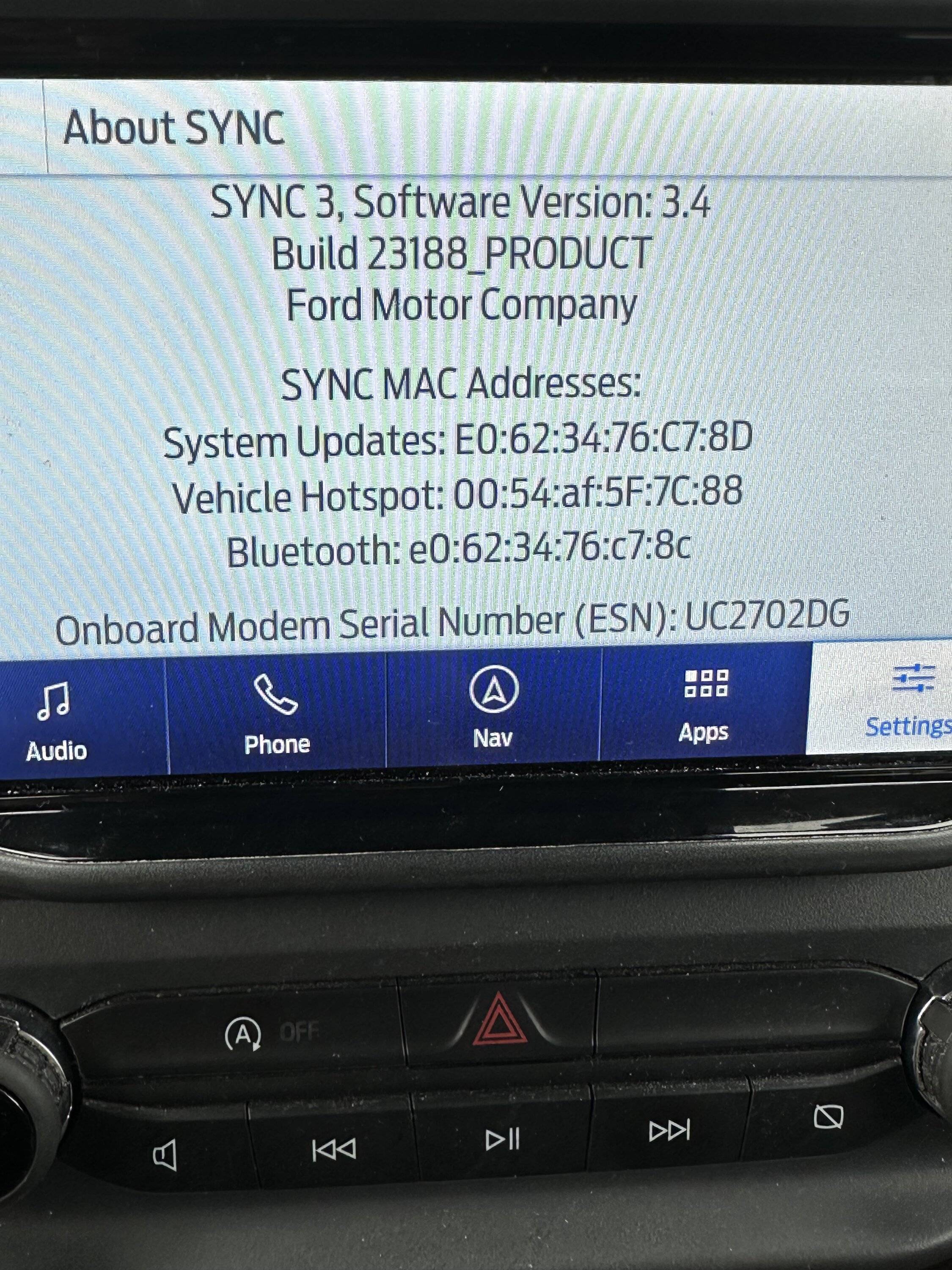

Sync 3.4 Build 23188 now available directly from Ford. Updating now with USB flash drive.
https://www.ford.com/support/sync-maps-updates/
Update through Wi-Fi from the vehicle is also now available. I updated by downloading to a computer and using a USB flash drive. FOLLOW INSTRUCTIONS.
This is a quick and easy download. Installation took 10 minutes.
Hopefully, this update addresses the Build 22251 issues.
Make sure you do a key cycle after installation. I also did a master reset and paired my phones again. You will have to reset your SiriusXM presets after a master reset. It will take some time for the SiriusXM station logos to repopulate.
I also had to perform a reactivation of Ford Pass. My in vehicle Wi-Fi hotspot now works again.
Overall, I am very satisfied after all the frustration.
This update corrects all the issues.

Just did the USB download. Loaded quickly in the BS.

I didn't perform a master reset before performing the update and all functions are working fine. Doing the map update in a couple of days. Since the update my Fordpass is working properly, the radio isn't turning itself on at engine startup, and everything seems to be working much better and faster
