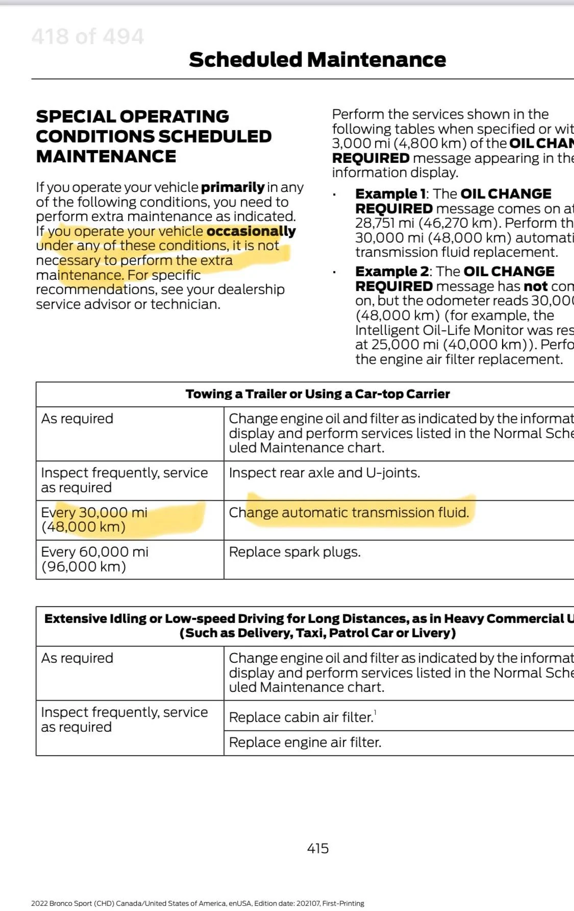

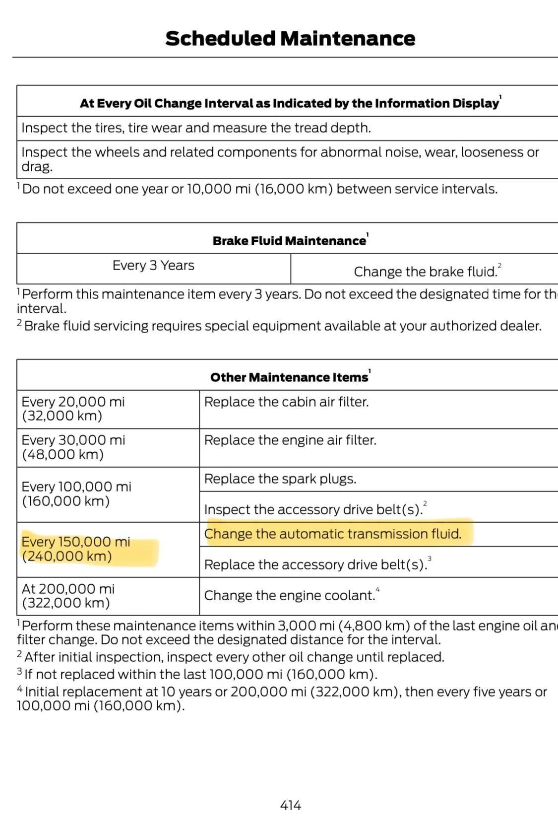

I believe the BS uses the same trans as the edge and escape, 8F35. He is recommending oil service interval every 30k miles. Built in non replaceable filter seems to be the driving factor in his recommendation.

I brought this up and caught flack. I did all my initial services at 20k to get any break in material out of my trans,diff and PTU. After that im going to services them every 30k.
Well I’m only at 6000 miles but I plan on following this to a T !!!

No harm in changing fluid sooner than required unless there are additives added for break in period ?

I'm sticking to the maintenance schedule provided by the manufacturer. I also have an Escape where everyone was telling me to change it every 30k or risk catastrophic transmission failure (all the doom and gloom). Currently at 90k and still going strong. Lifetime PT warranty on both.
