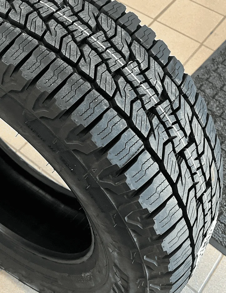

The KO2’s will look more aggressive than the OEM WildPeaks. The edges on the OEM WildPeaks are more rounded to improve road noise. The 245/65-17 WildPeaks also have a more aggressive look because of the corners as well.

235/65 is a 29in tire and fits fine, the Badlands has that size as optional. 235/70 is a 30in tire and barely fits at full lock. 245/70 is a 30.4in tire and would rub, because of bigger diameter and a wider cross-section. Its not so much the travel/lift that is the issue, but the front/back of the wheel wells. I have read people doing mods to the inner liners and the pinch weld to get larger tires to fit, but without that they will rub.

I definitely subscribe to the larger sidewall “side” of life but honestly, after many years of wheeling, the difference of 10mm or 3/8’s of an inch in width or 12mm or 1/2 in of additional clearance isn’t going to change where this can or cannot go by much (IMO). When people are now wheeling with 37’s or 40’s, going from 29 to 30 isn’t changing things significantly.
Just changing to a more aggressive tread and squarer corner/edge gives it a much better look.
