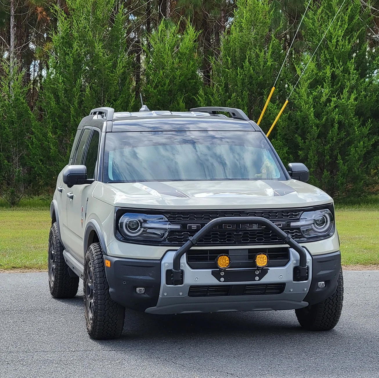

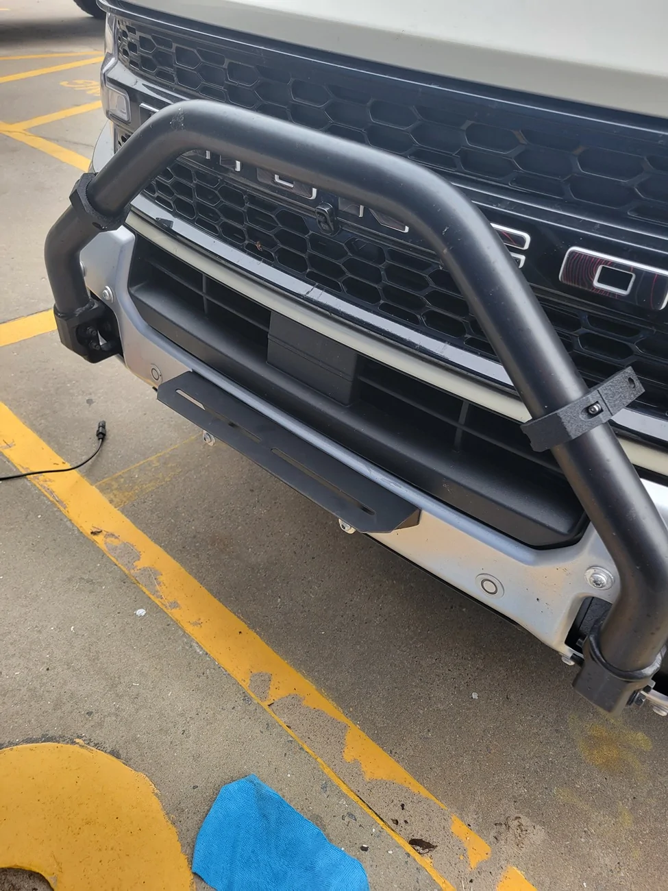

Had a custom light bracket made by a local shop mounting directly to the existing bronco bolts. Had them put channel grooves in the top to mount thru so lights can be adjusted left and right as preferred. Used silicone gasket behind the mount to preserve the metal on the bumper. Can confirm that the exposed green wire just inside the front left fender well is a hot wire to toggle switch #2. Just connect the lights hot wire there and ground the other.​

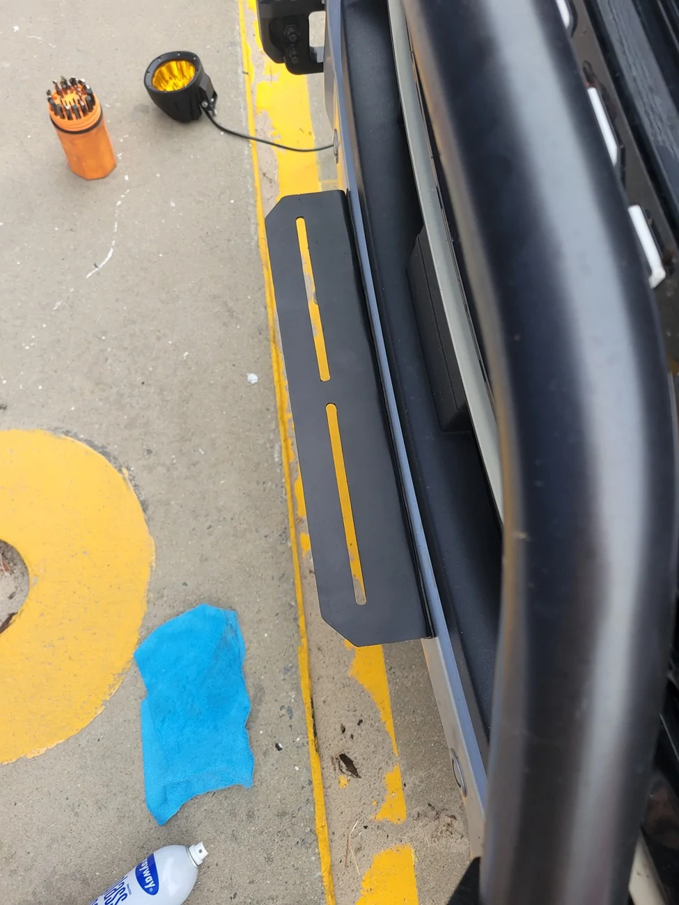

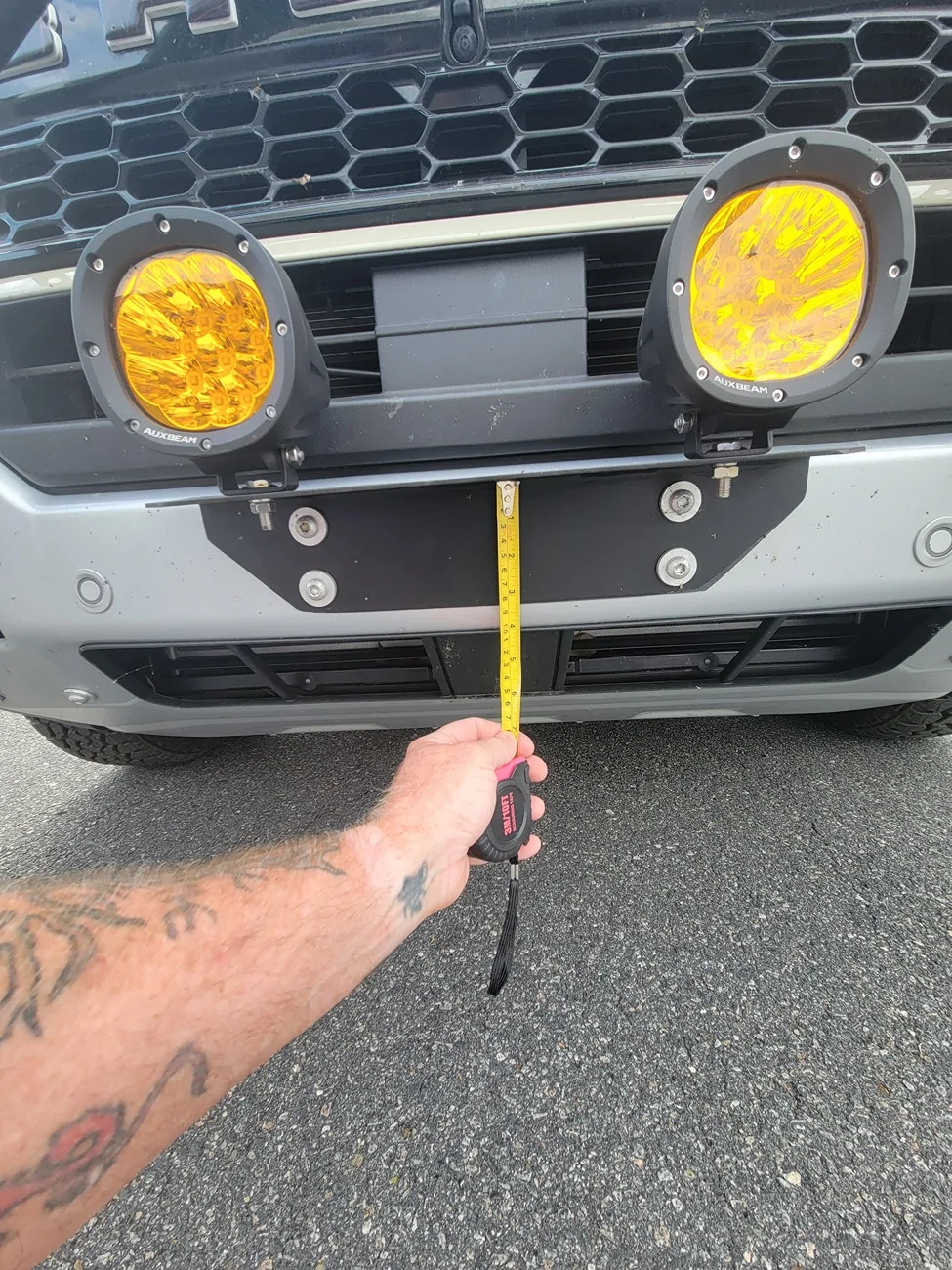

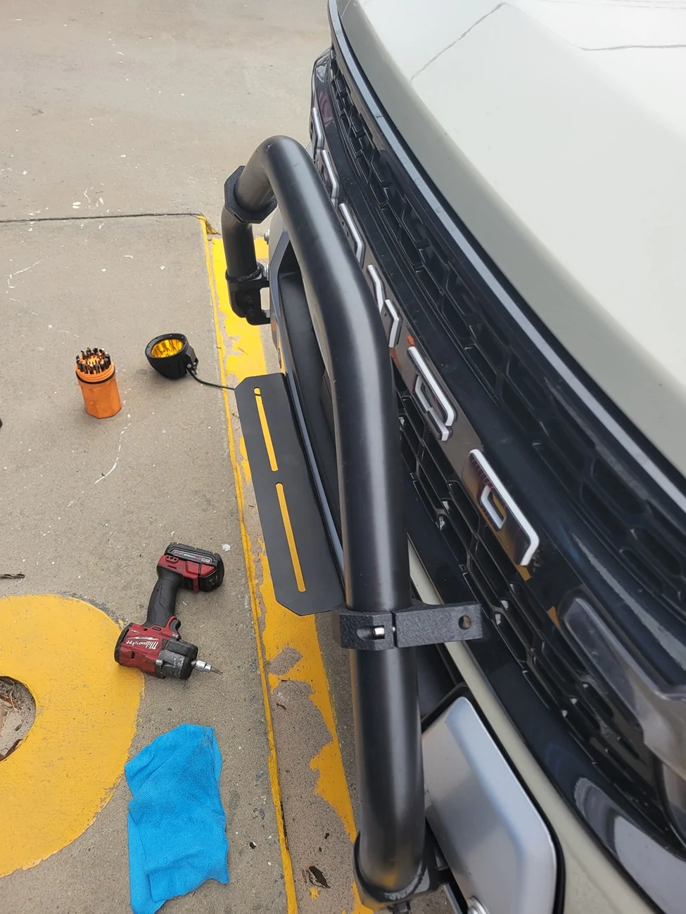

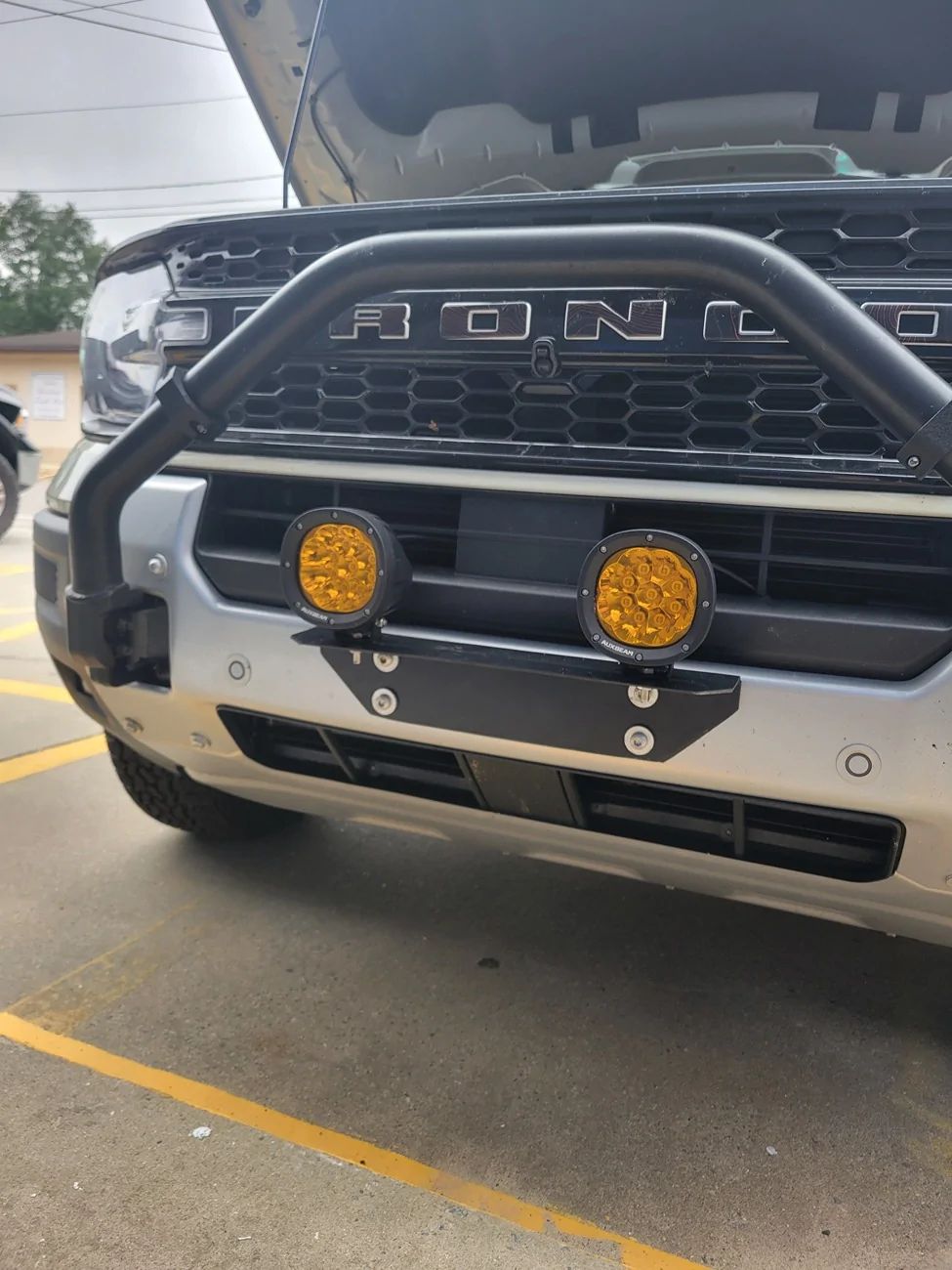

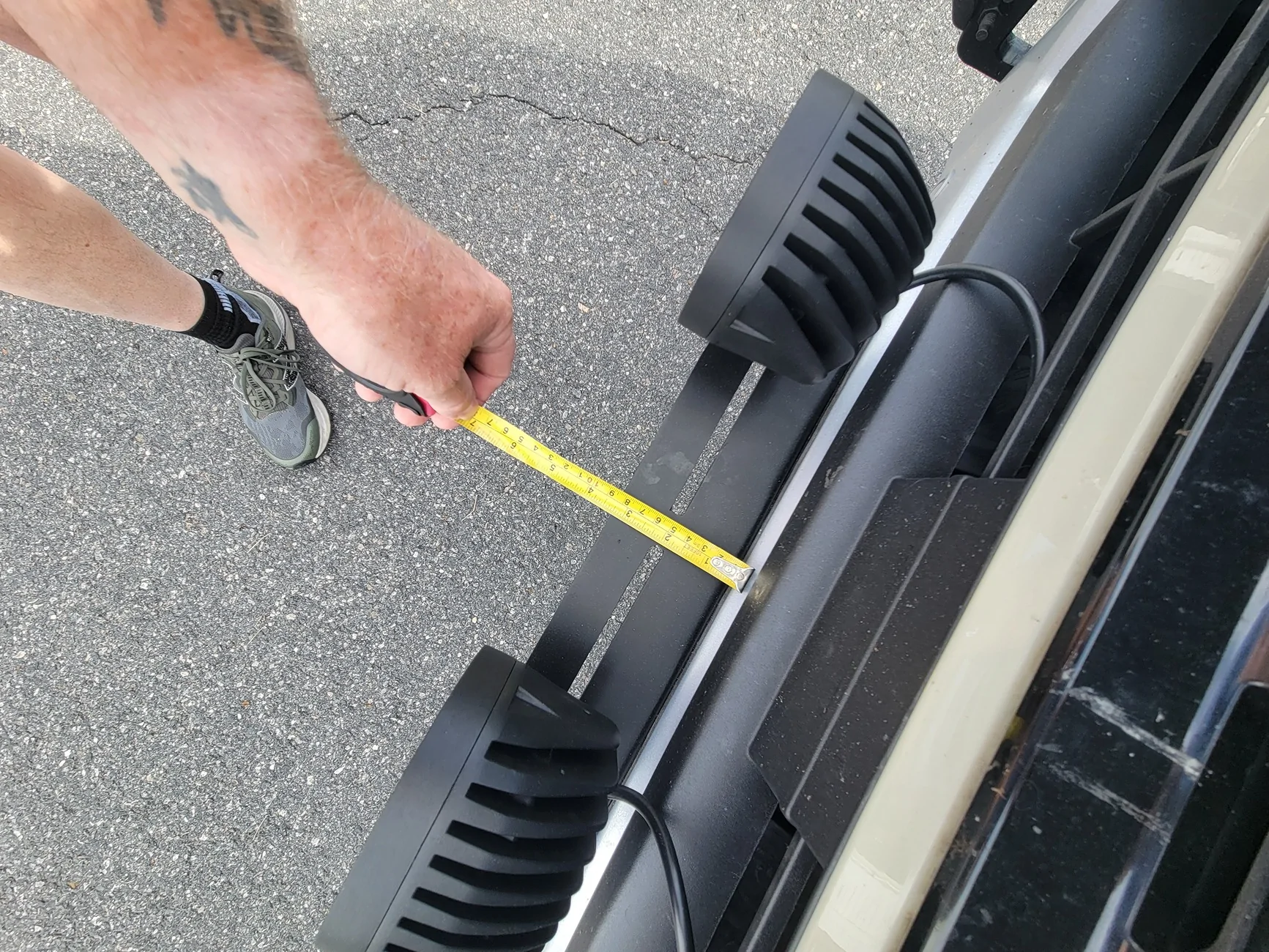

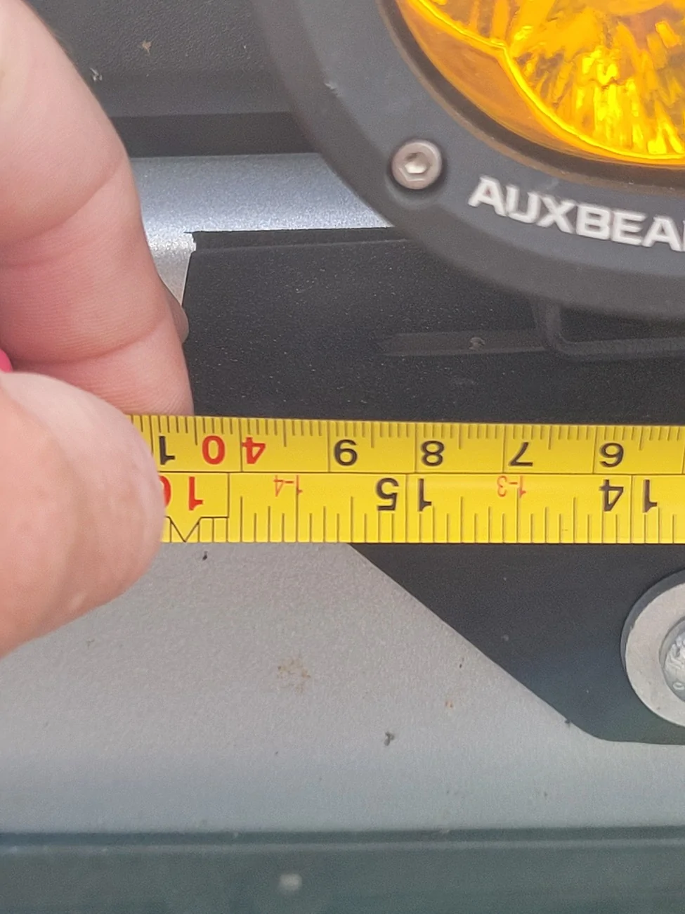

Sorry it took so long. The guy did this mostly freehand. Here's the measurements and some pictures. And decent metal worker should be able to replicate this.
