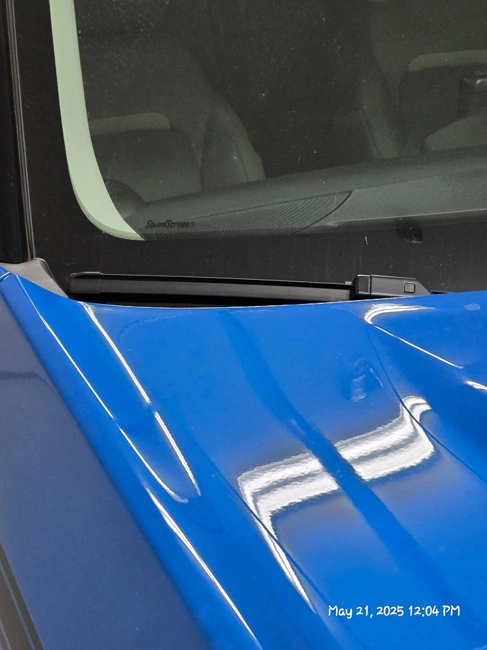

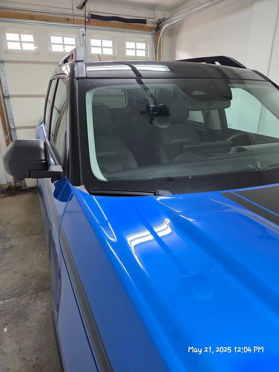

Work can wait. This is much more important...

Oh no, this is the whole "rear wiper 180 degree arc" all over again.
I can totally see how that is annoying. My '21 wiper does the peek a boo but I think I have grown used to it. In fact, the driver one almost goes too far down. Maybe there is way to fix it by moving the arm on the splines. If someone proves it, I'll move mine too.

Thanks for putting work to the side. Thanks for the photo. That's now how my 2022 wiper looked, it completely disappeared (as it should).

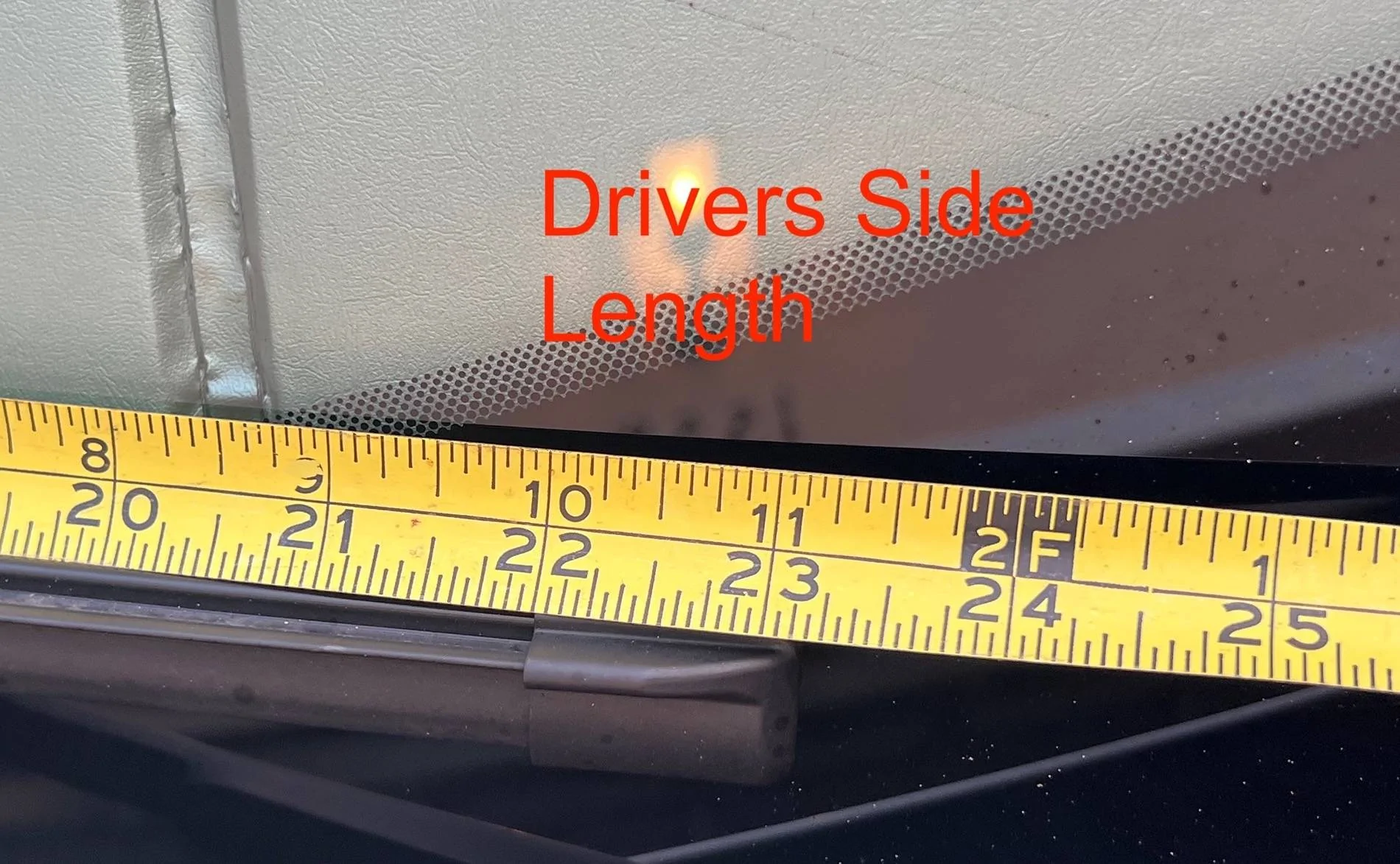

Drivers side length: 23"
Ford Bronco Sport 2025 Bronco Sport Badlands PASSENGER SIDE WINDSHIELD WIPER IMG_3224

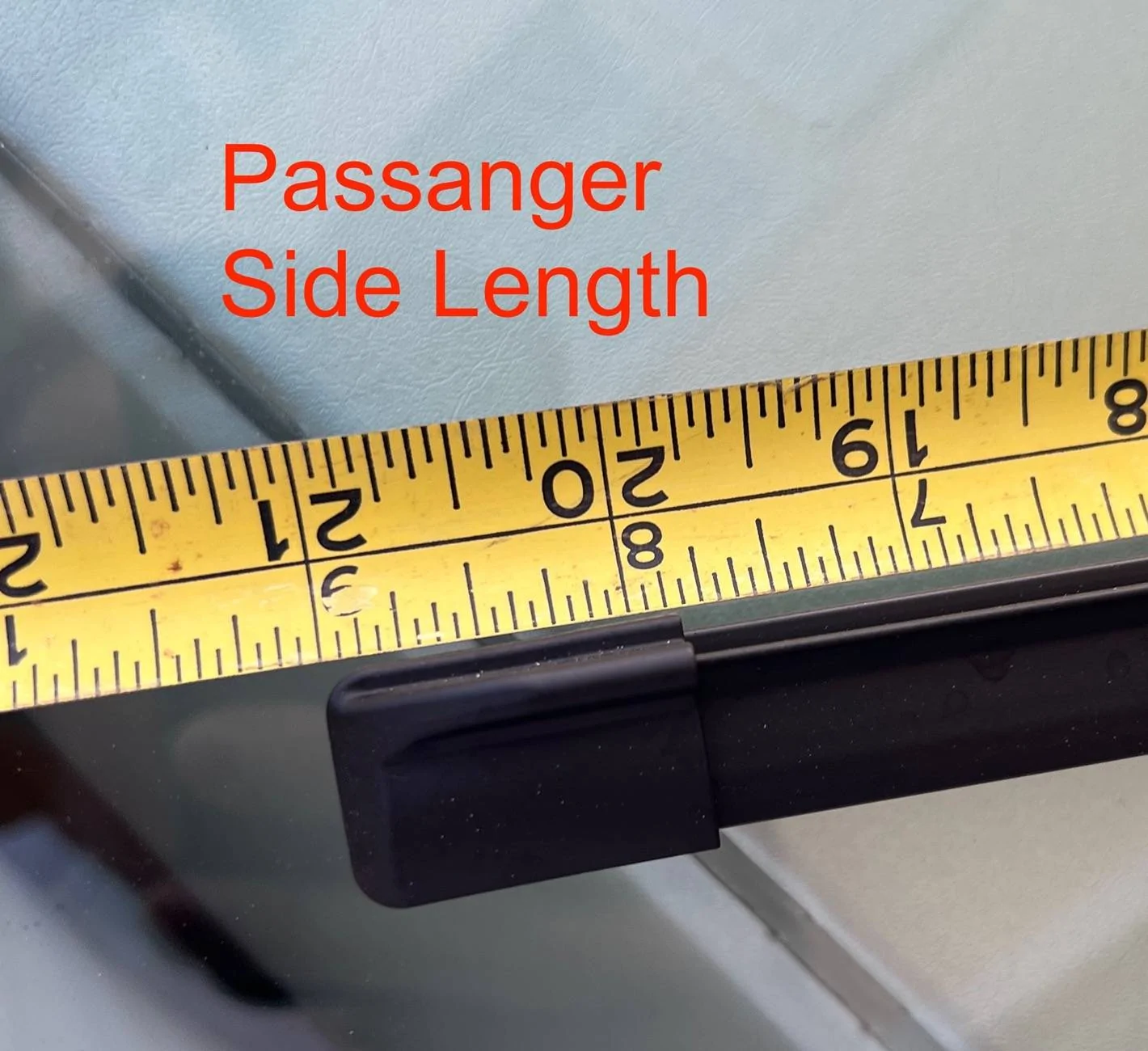

Passenger side length: 21"
Ford Bronco Sport 2025 Bronco Sport Badlands PASSENGER SIDE WINDSHIELD WIPER IMG_3225

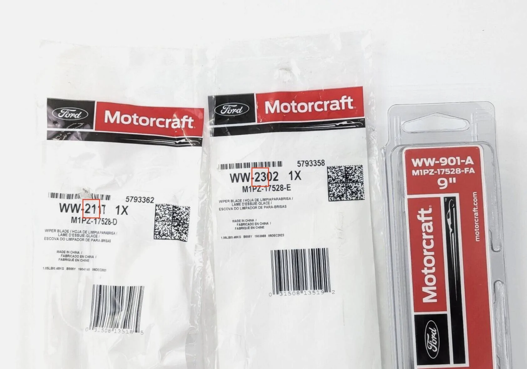

If I decode the OEM replacement P/N correctly, the '21-'24 are the same length.
Ford Bronco Sport 2025 Bronco Sport Badlands PASSENGER SIDE WINDSHIELD WIPER Screenshot 2025-05-23 at 8.00.59 AM

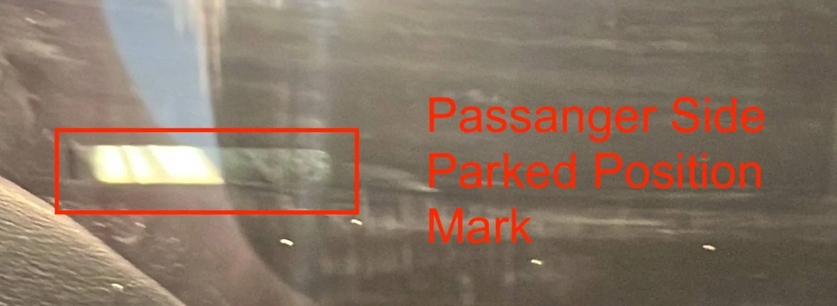

Passenger side windshield parked position indicator mark. When I shine a light it almost looks like a photo sensor. If it is, not sure if it is used to confirm the wipers are in the parked position and/or working in combination with the lane assist camera. I covered it with a piece of tape and it still seemed to work. There does not appear to be one for the drivers side wiper.
Ford Bronco Sport 2025 Bronco Sport Badlands PASSENGER SIDE WINDSHIELD WIPER IMG_3223

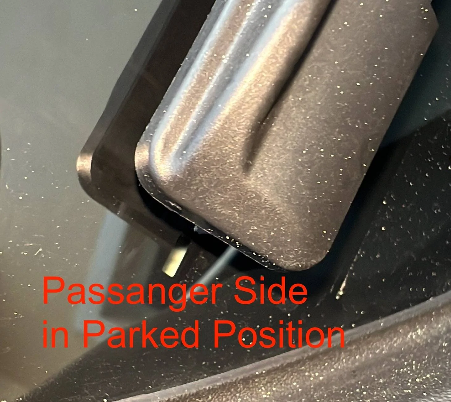

Passenger side in parked position
Ford Bronco Sport 2025 Bronco Sport Badlands PASSENGER SIDE WINDSHIELD WIPER IMG_3228

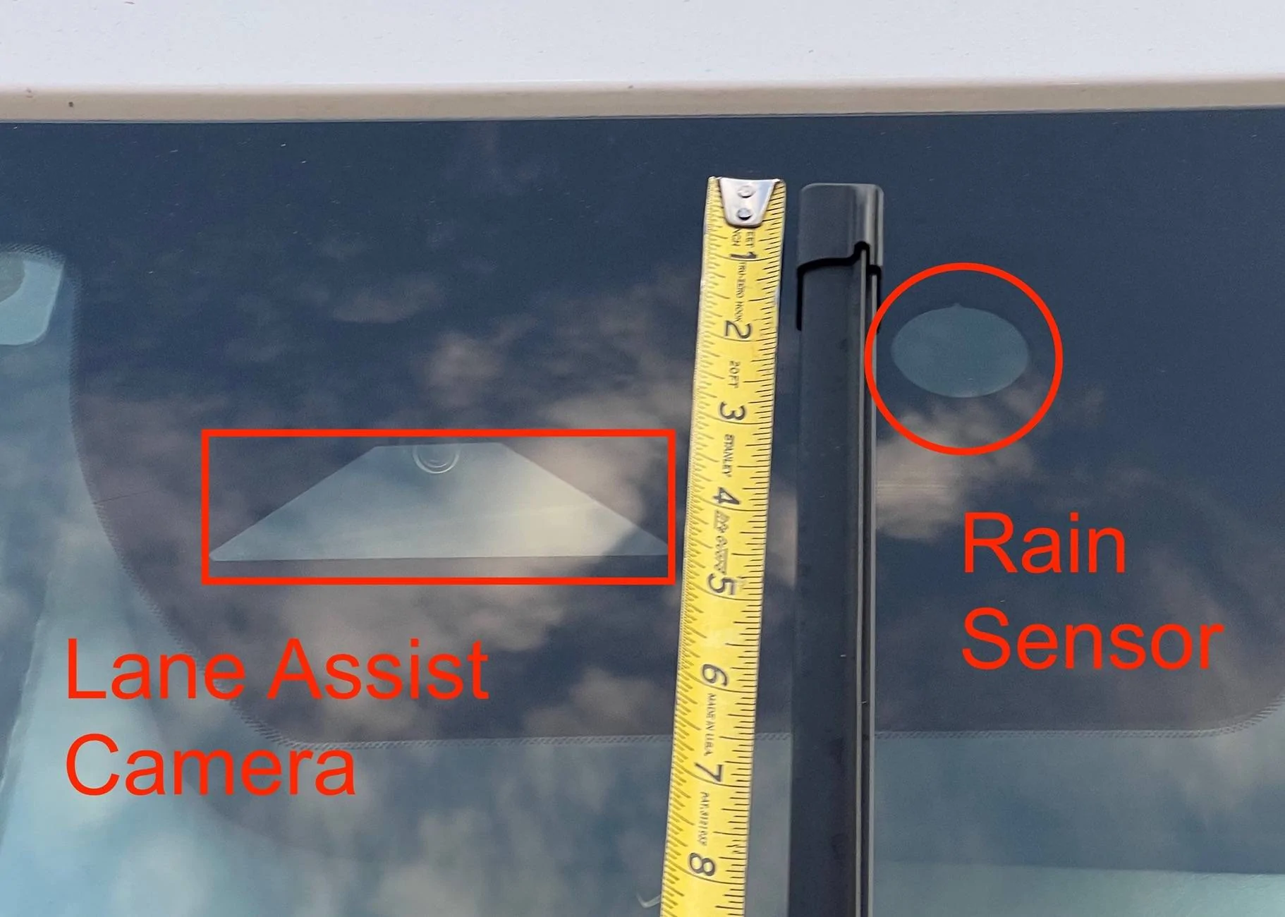

Passenger side over camera and rain sensor (if equipped)
Ford Bronco Sport 2025 Bronco Sport Badlands PASSENGER SIDE WINDSHIELD WIPER IMG_3230

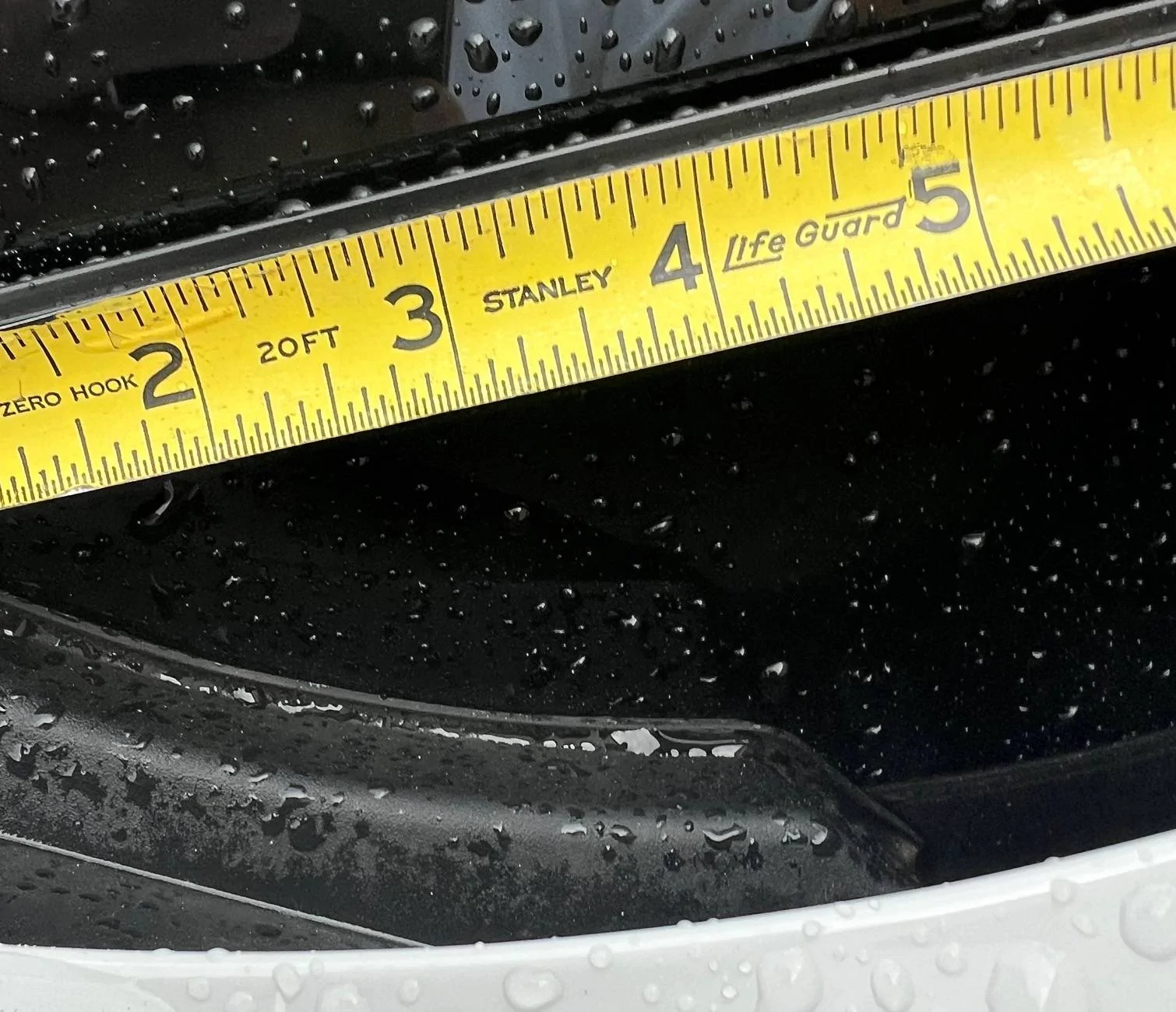

  • In order to install the passenger side such that is it parked below the hood line, seems like it would have to be ~8-10" shorter (4-5" from the center of the wiper blade mount point) to not interfere with the cowl window trim.
  • In doing so, it might not wipe the water from in front of the rain sensor (if equipped) or lane assist camera due to length of wiper and sweep range.
  • For those who report the wiper is parked below the hood line, I would check if you have the correct length blades and/or if the blades are actually sweeping over the cowl plastic.
Ford Bronco Sport 2025 Bronco Sport Badlands PASSENGER SIDE WINDSHIELD WIPER IMG_3231
