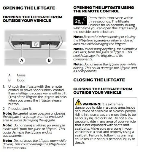

Hello, I just picked up a 2022 BS Big Bend. I am able to open the rear hatch but I haven't been able to open the rear lift glass. I have tried using the fob to unlock the car, double press the rear hatch button on the fob, etc. but when I press the rear lift glass button on the rear, I don't hear a click and the glass remains locked. Am I doing something wrong or do you think there is an issue with my vehicle?

Yes and the lift gate works - it is the glass that I can't open.

Finally got a chance to get the Bronco into the dealership. They said the rear glass latch wasn't working because an electrical connector came loose and a fuse wasn't fully seated. All fixed under warrantee.
