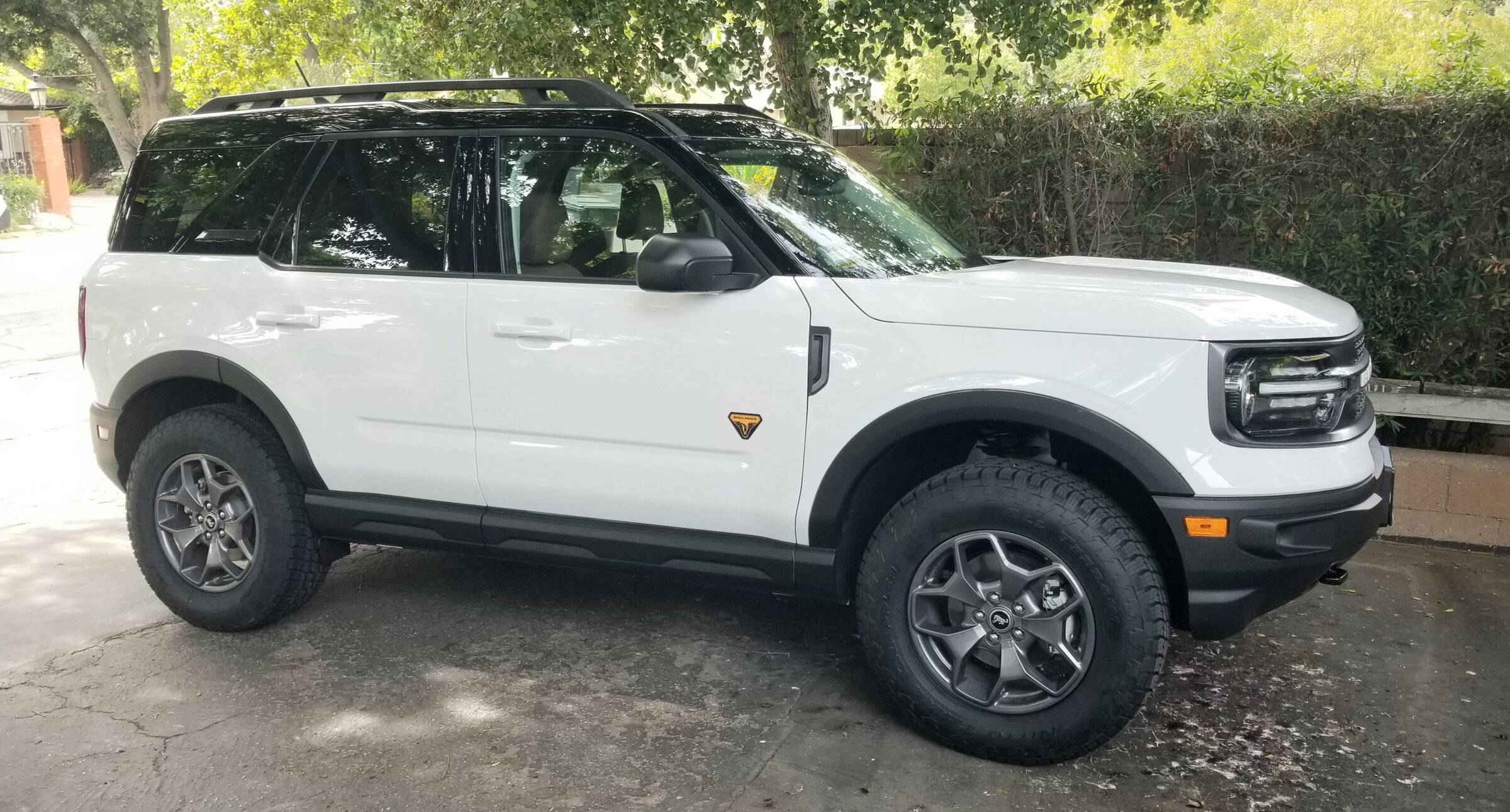

Hey all , just joined up and thought I would give you a quick rundown of the BS as it stands today.
I’m debating taking the rear spacer lift off to level the BS I was able to keep the front factory tow-hooks and paint them.
the tires do not rub but there are close at full lock.
2022 badlands
1.25” HRG Lift
245/70r17 BFG KO2
Fifteen52 wheels
Rough country nudge bar
Rhino rack pioneer platform
Magnaflow dual exhaust
Ford Bronco Sport 2022 Badlands lifted on 1.25” HRG Lift and BFG Ko2 56A25BB7-04C3-4CD8-B78A-D6D78DAEFCED

Great looking Badlands.. !!! I just installed the HRG kit myself in 4 hours. Watched the factory video a few times. Wrote down the Step X Step and knocked it out fast. I grinded my struts on my bench grinder and painted them with black rustoleum. Took 60 seconds. No rubbing but looking at it installed.. Probable didn't need to do it.
Tightened every thing down VERY good but getting a clicking sound on the drivers side. Obviously disheartening as I followed every step precisely and tightened everything REALLY GOOD.. Maybe a faulty sway bar link. They are notorious to cause clicking. Had that in my Escape several times. HAS ANYONE OUT HERE HAD THAT SAME ISSUE RIGHT AFTER INSTALL OF THE HRG KIT..??? I put on the 1.25" front end kit as suggested for the Badland. I did NOT put in the rear spacers yet .. After reading several posts advising they weren't really needed.. I choose to follow past experience. I will install a set of Air Lyft 1000 series airbags to the rear for times with a load. Had them in my 4x4 Escape and LOVED THEM.

OK... clicking issue fixed .!! No fault of the HRG lift kit. Merely the bottom nut on the passenger side sway bar link. Managed another 1/2 turn on it and the clicks dissapeared immediately.
After reading a few blogs here, it was suggested on the Badlands that the rear spacer lifts were not really needed. Instead, just an install of the 1.25" front spacers. Perhaps the rear sits higher from the factory, and I assume it may be a higher spring rate in the rear that is not used in the other models. I mounted the front kit.. Then the 245/70/17 Nitto Terra Grapplers and the Badlands sits PERFECT. I'll be installing a set of Air Lift 1000 series airbags in the rear springs which gives me the option to increase load simply with a few extra pounds of air in the bags when camping with more gear or when towing my boat.
NOTE: I adjusted the upper top "cam" bolt that mounts the bottom of the strut to allow the axle to sit at its inner most position. This provided an excellent alignment after the install. I will still have it checked at a tire shop for PERFECT alignment... but it drives great in that setting.
The tires fit GREAT..!!! LOOK GREAT... And NO RUBBING AT ALL...!!!
