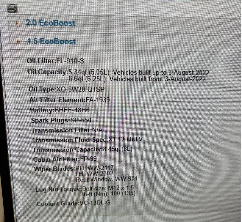

I took a picture of the screen at the dealership when I was getting the oil changed. It was some sort of Ford technician resource.
