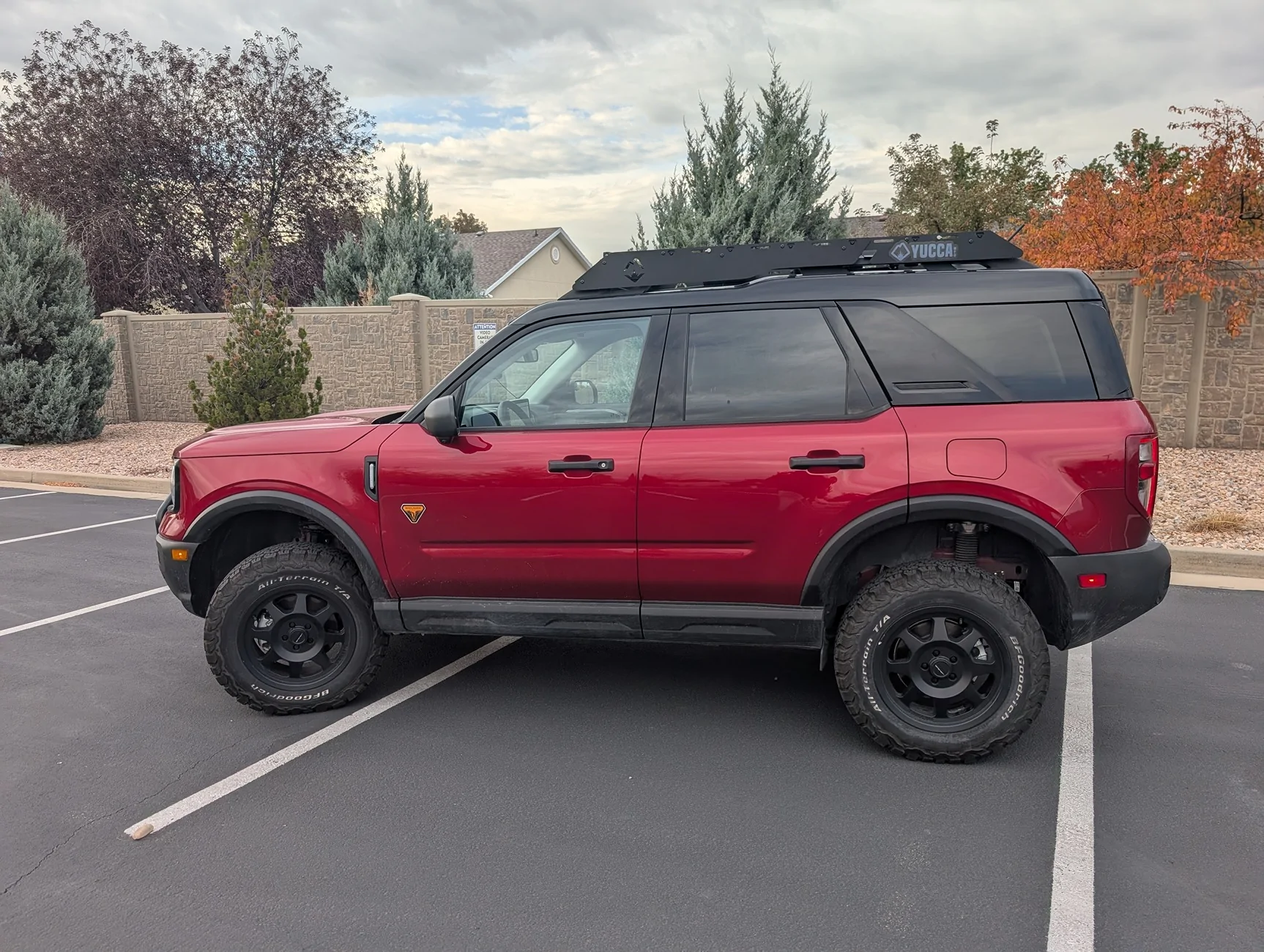

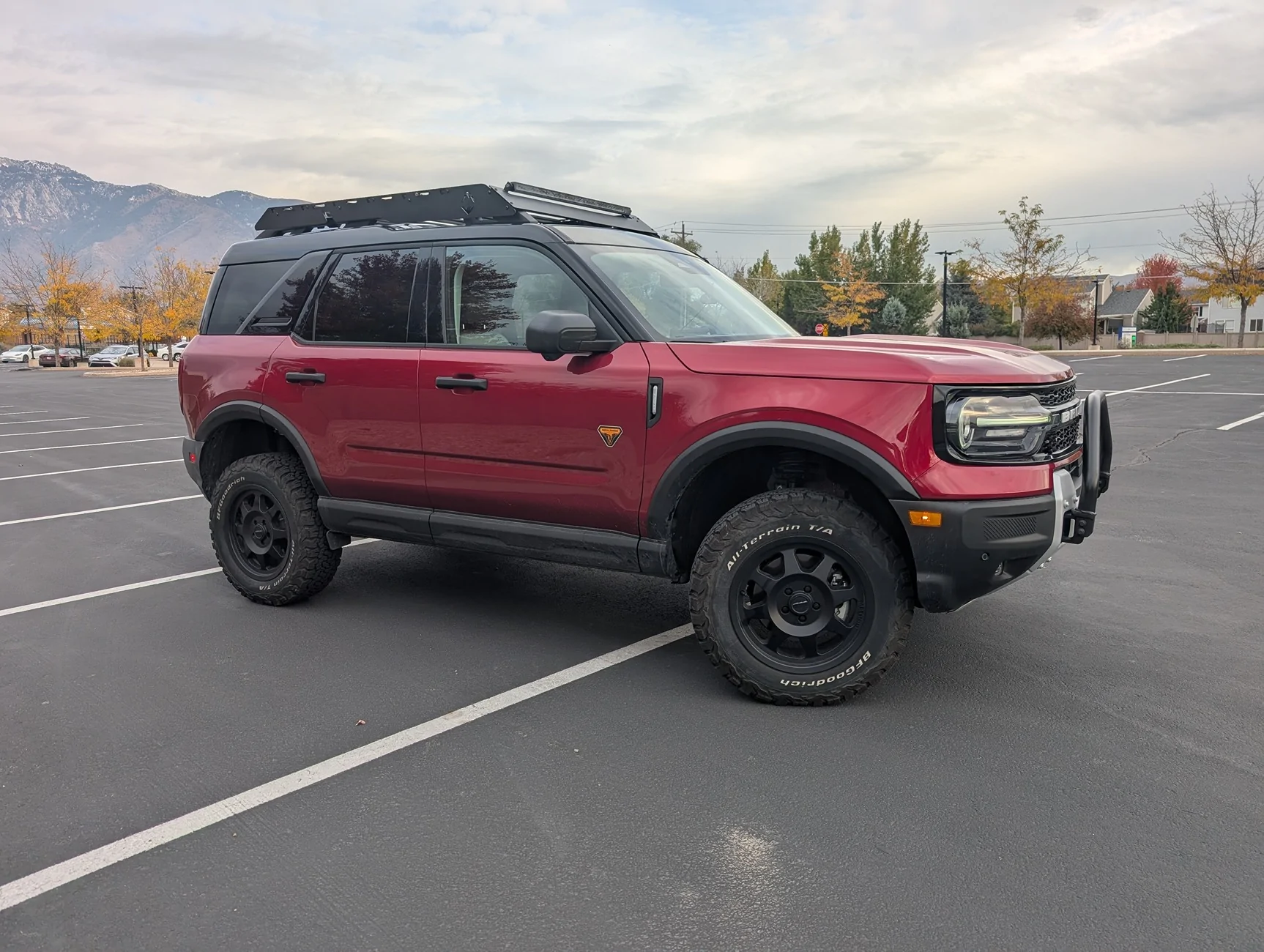

I have a 2023 OBX with a 2.5" suspension lift from Flatout. With the lift plus tires I'm at 12.3" of clearance. @Luna_the_Bronco if you'd like to check out my build.

What size tires are you running? To get to 12.3in you'd have to have at least 32in tires if I'm mathing correctly.

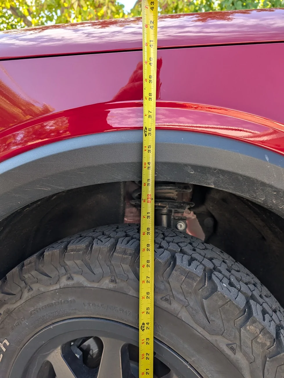

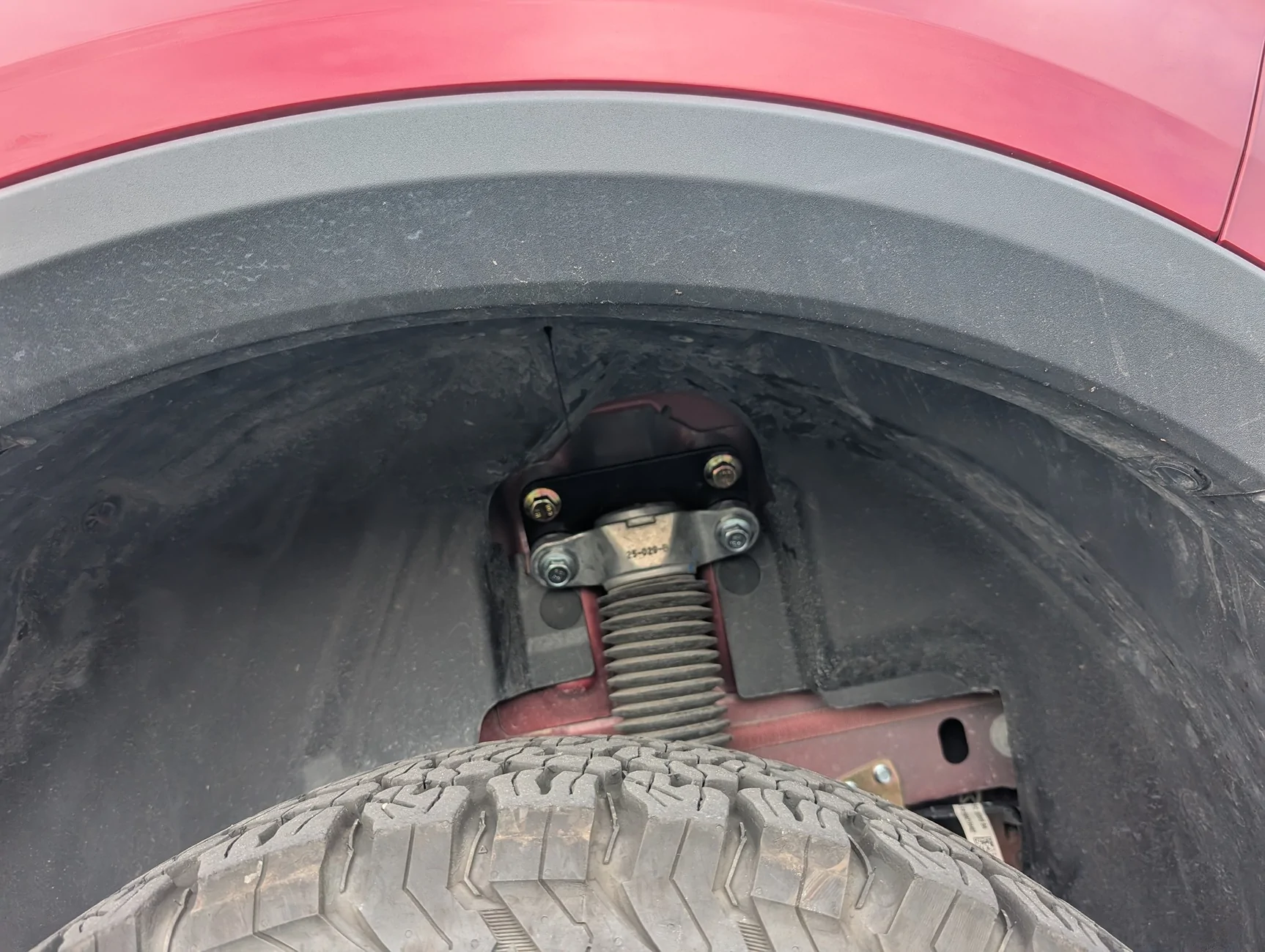

HRG kit arrived and will be installed next week. For reference here are my fender heights, stock front 33", rear 33.5"

Did you also take a measurement before you changed the tires, to see what the difference in ride height was. The reason I ask is, from other people‘s measurements, the stock Sasquatch tires are larger in diameter than they should be for their. 235/65/17 size and have been measured, by others at 29.5” in diameter, the same theoretical diameter as the 245/65/17 BFG‘s you have on now.

I did not, I've had the 245s on for a while!

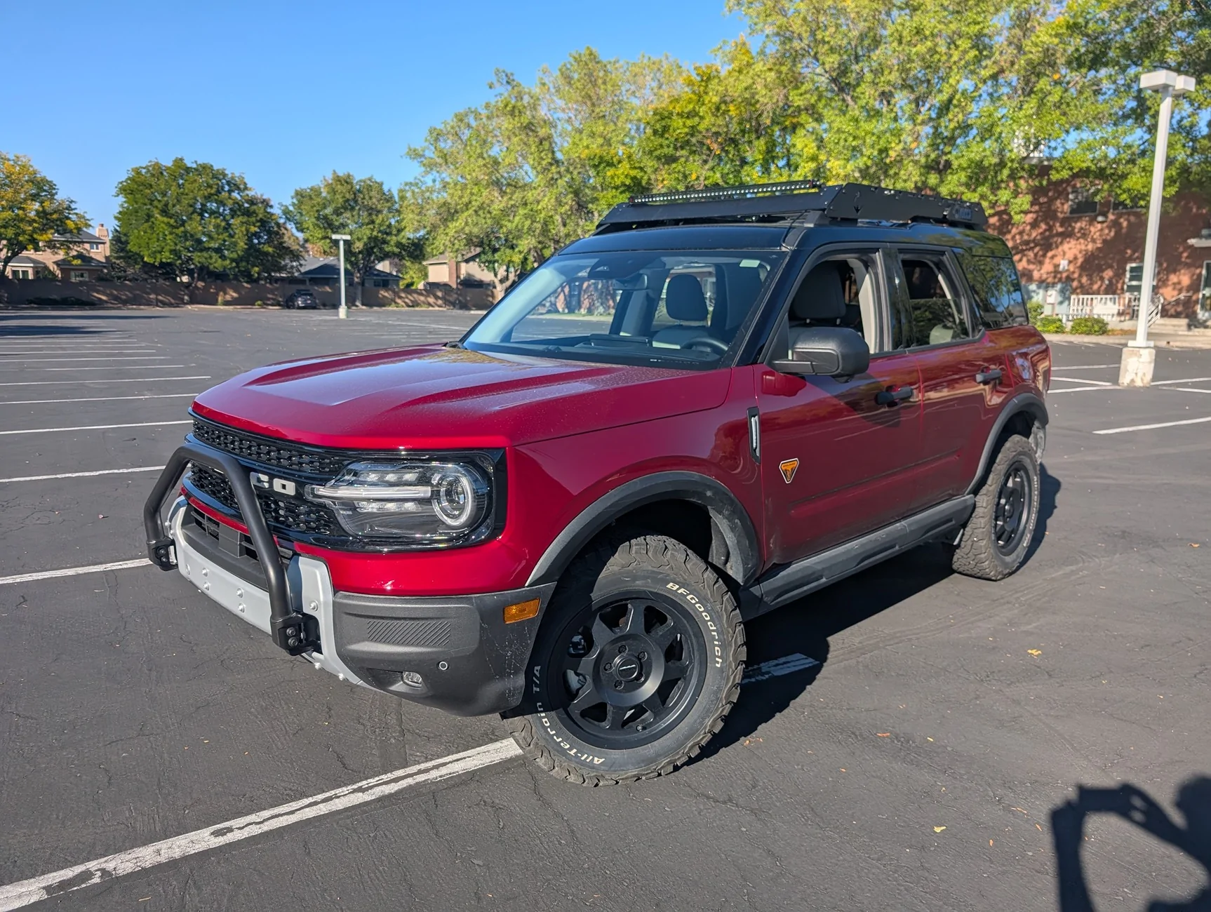

Bit high for me. It looks like it’s on tippy-toes. Gonna try to fill that out with larger shoes?
