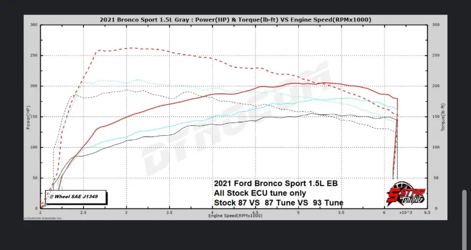

Here are the dyno numbers for a stock 87 tune, 87 Performance Tune and 93 Performance Tune
Ford Bronco Sport Thinking of tuning your 1.5? DO IT ALREADY! IMG_2003
Be sure to follow up with fuel economy numbers after a tank or two. :)

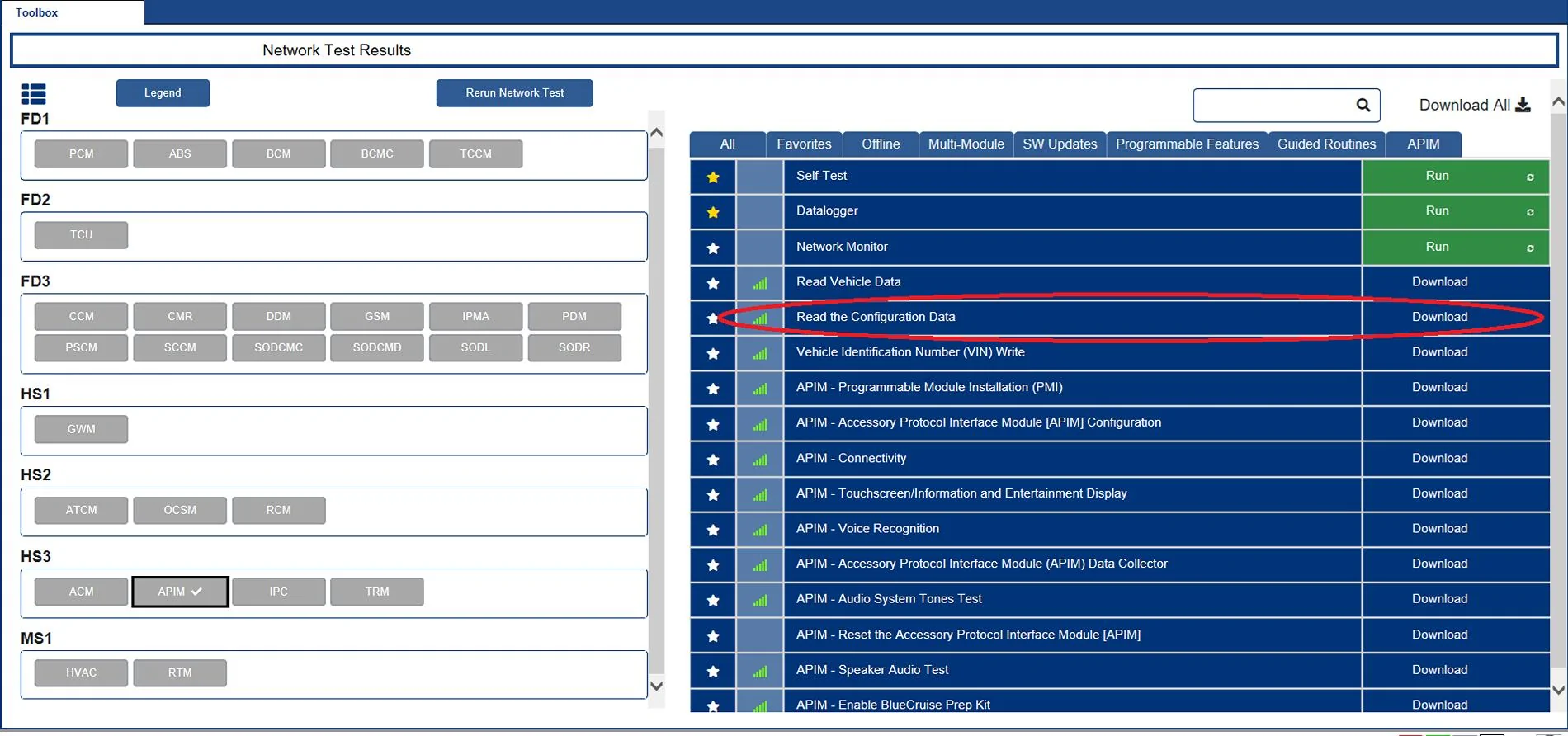

That is completely accurate; even more so now that FDRS does not report data back to the server automatically and efficiently like it used to. I don't want to derail this thread, but in the toolbox for FDRS, there is a procedure you can run on a module to read the config data on it and upload it to the mothership. This is not required to update a module, so a tech will just update it and when FDRS configures it after it flashes it, it'll load the ab data from the server and overwrite the config that was on it before. Unless the existing config is manually uploaded before the module is updated, FDRS will revert the FORScan changes.
Edit: On sync 4 vehicles, receiving an OTA will cause the interrogator on the server to poll the module and it will update ab data as per what is on the vehicle, so that will sync forscan changes to the cloud, too.
