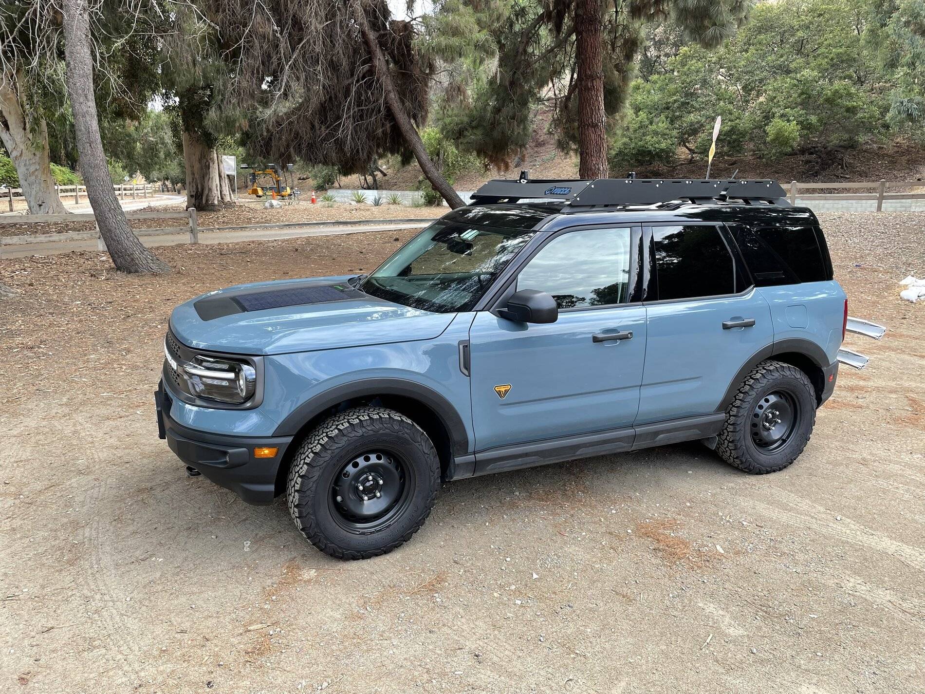

I was going to try the Toyo Open Country, but got a good deal on BFG KO2s in 235/70R16. Been very happy with them, pretty quiet, tons of grip, not too heavy.

Have you posted a pic with the 16's? Would love to see how it looks. I'm looking to purchase another set of wheels dedicated for some aggressive tires for my "overlanding" trips

Yeah, 50w panel on a hood vinyl. Keeps the battery topped up nicely.
